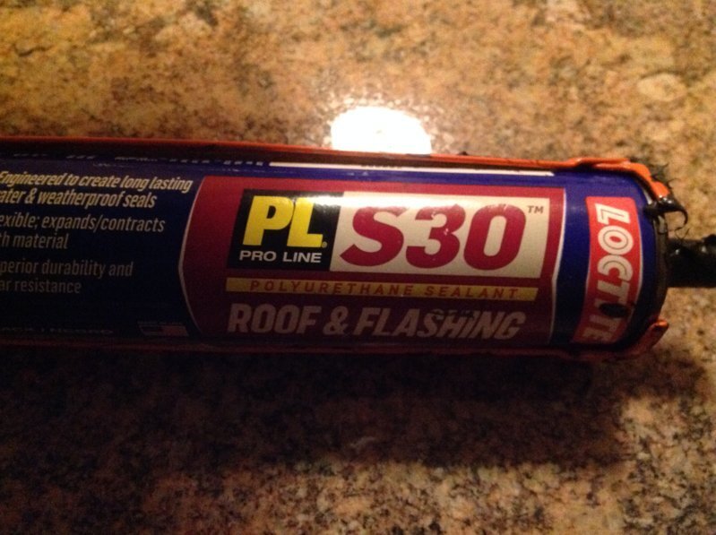

Black polyurethane caulking, it will never come off again. I also use to to make custom gaskets. The bottom of the Whittaker has it as a bumper. Don't get it on your skin, once dry has to wear off.

I don't glue on my fittings, just the reducer that goes inside. I tighten them automatically when I handle them.
I use the polyurethane sealant mostly for gaskets. It's also great if you want to create a bumper on a tool. Cured its almost as strong as rhino bed liner.
