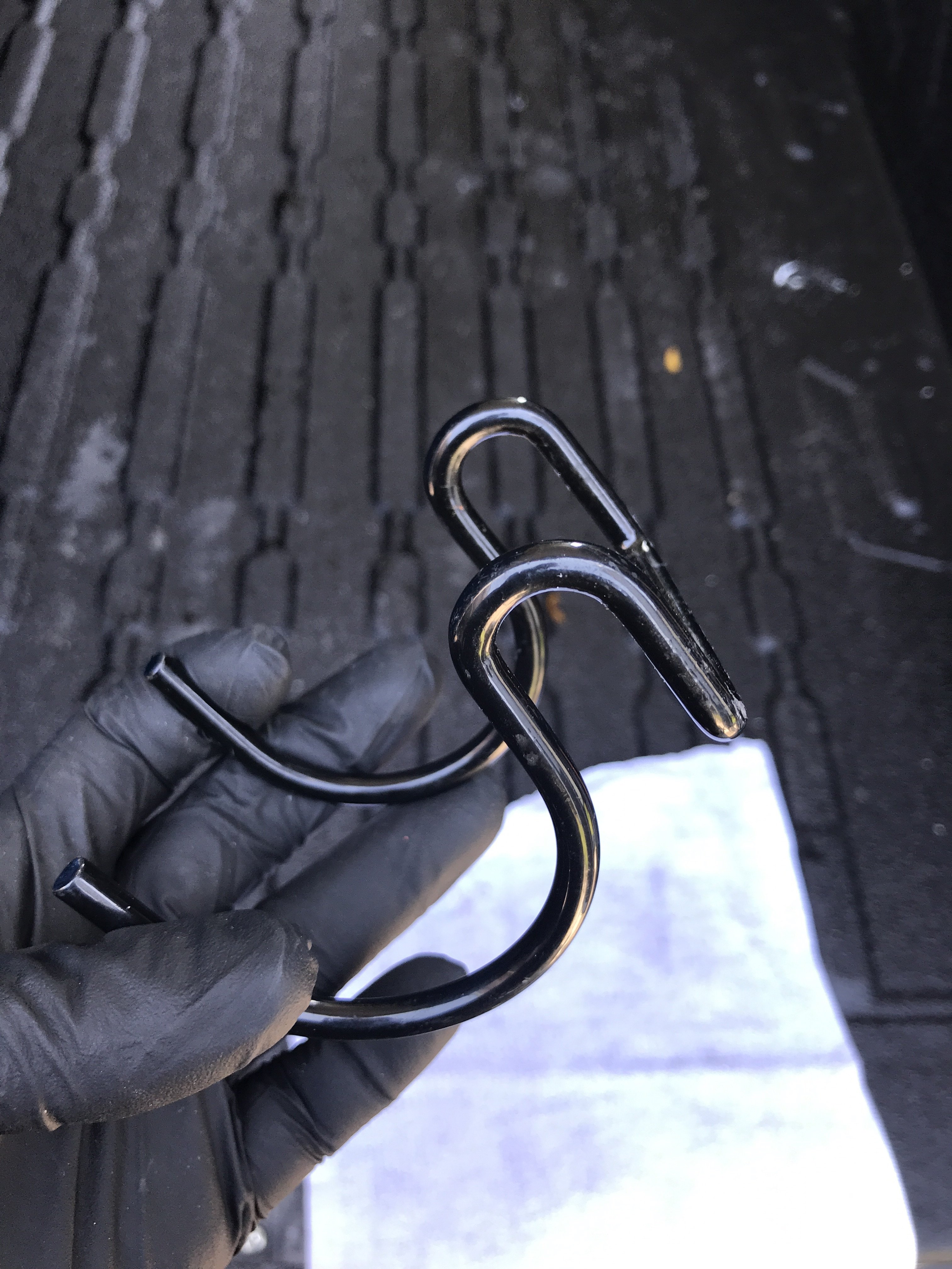

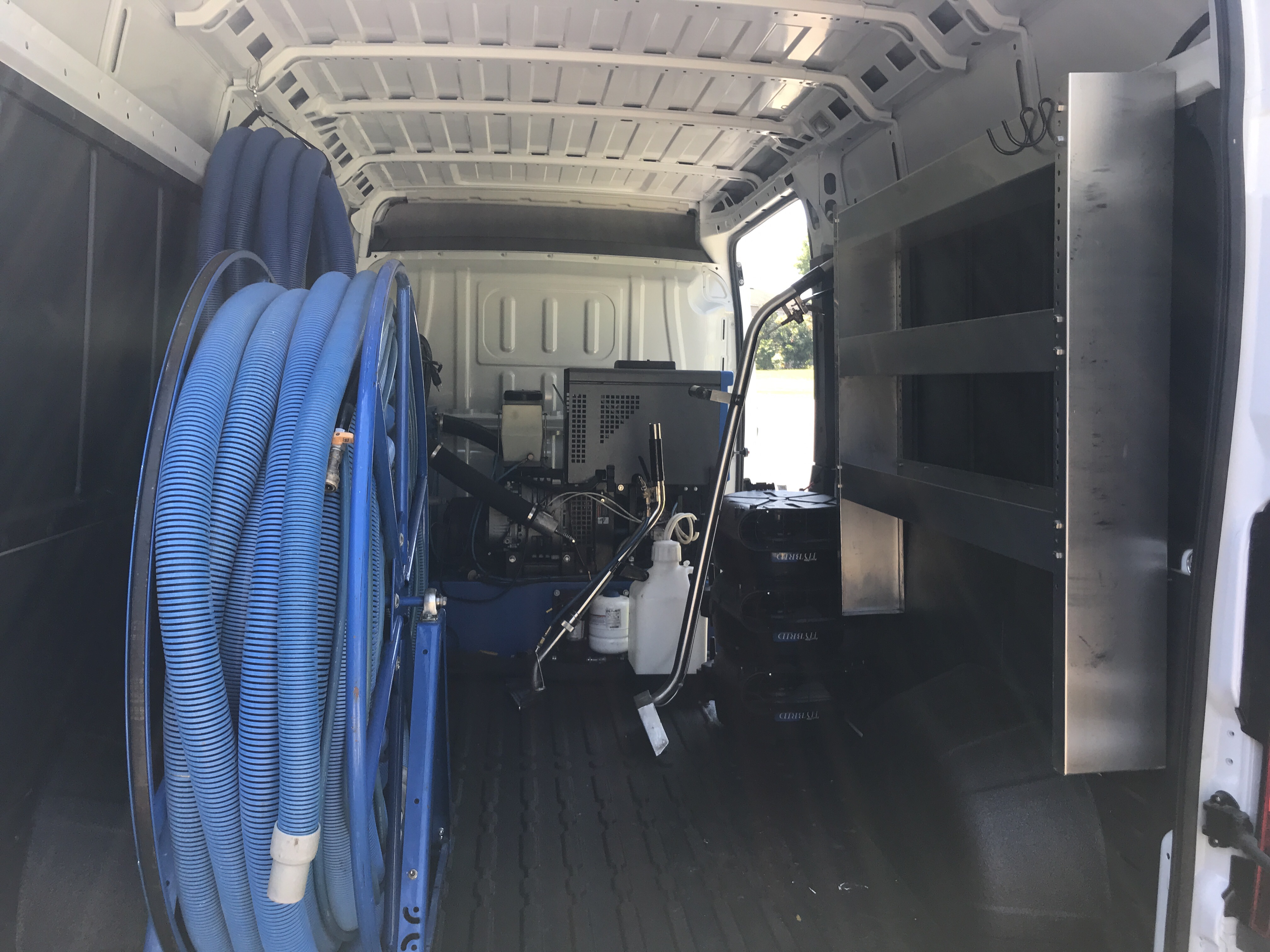

Trying to see what kind of hooks or anything you guys use on the high roofs? I’d like to hang the tile wand. But definitely the wand it’s self. This is my setup now.

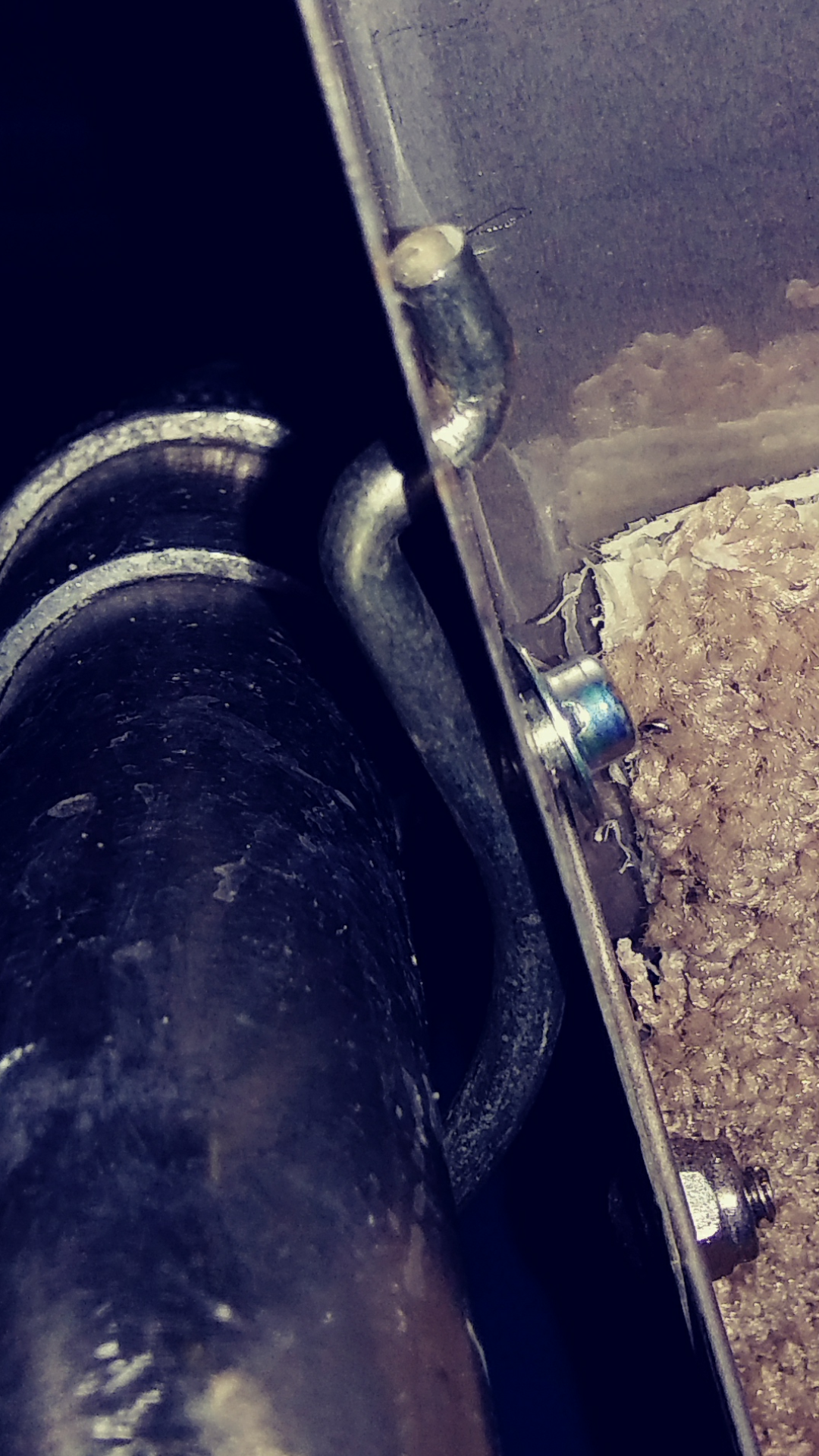

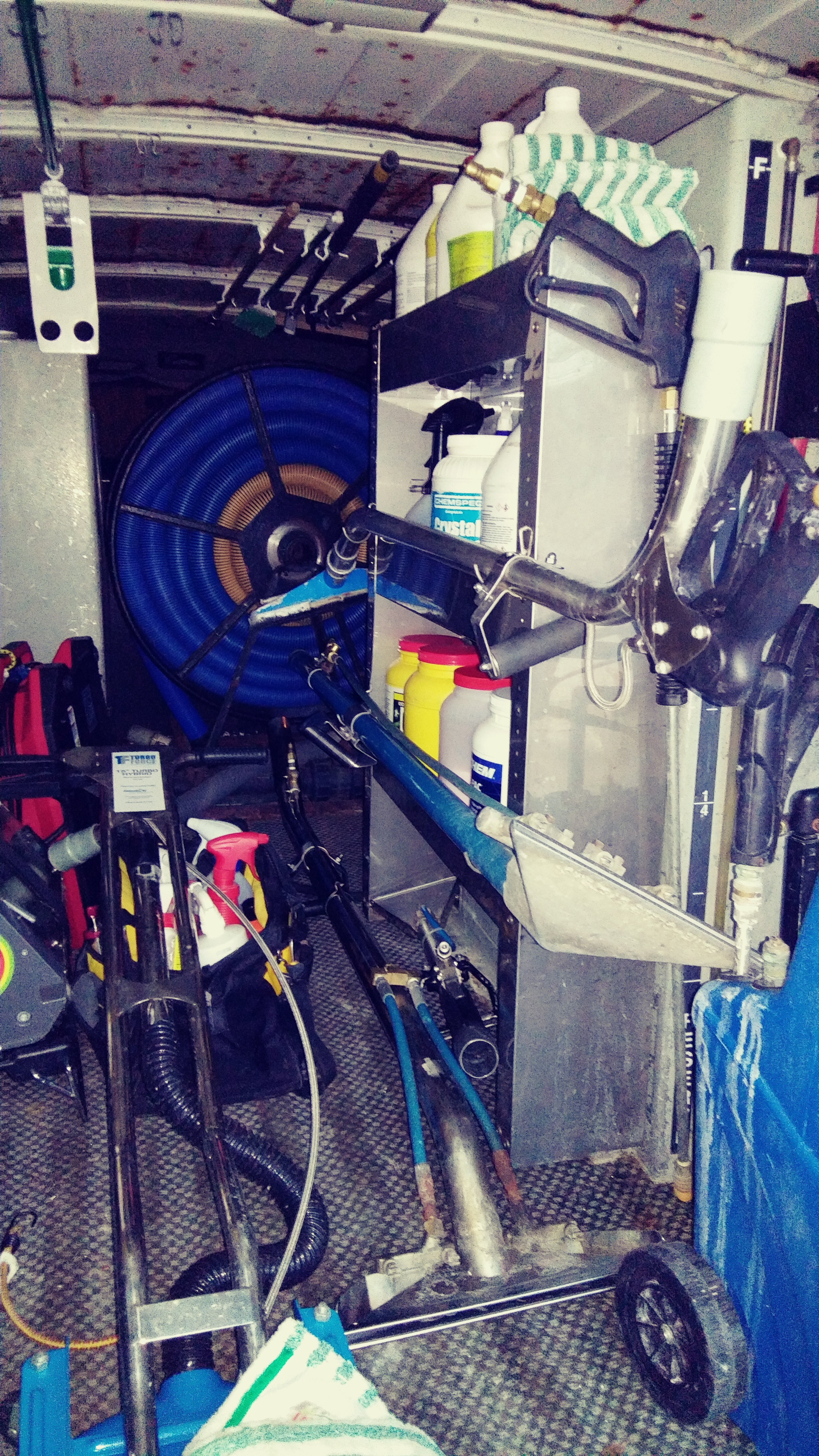

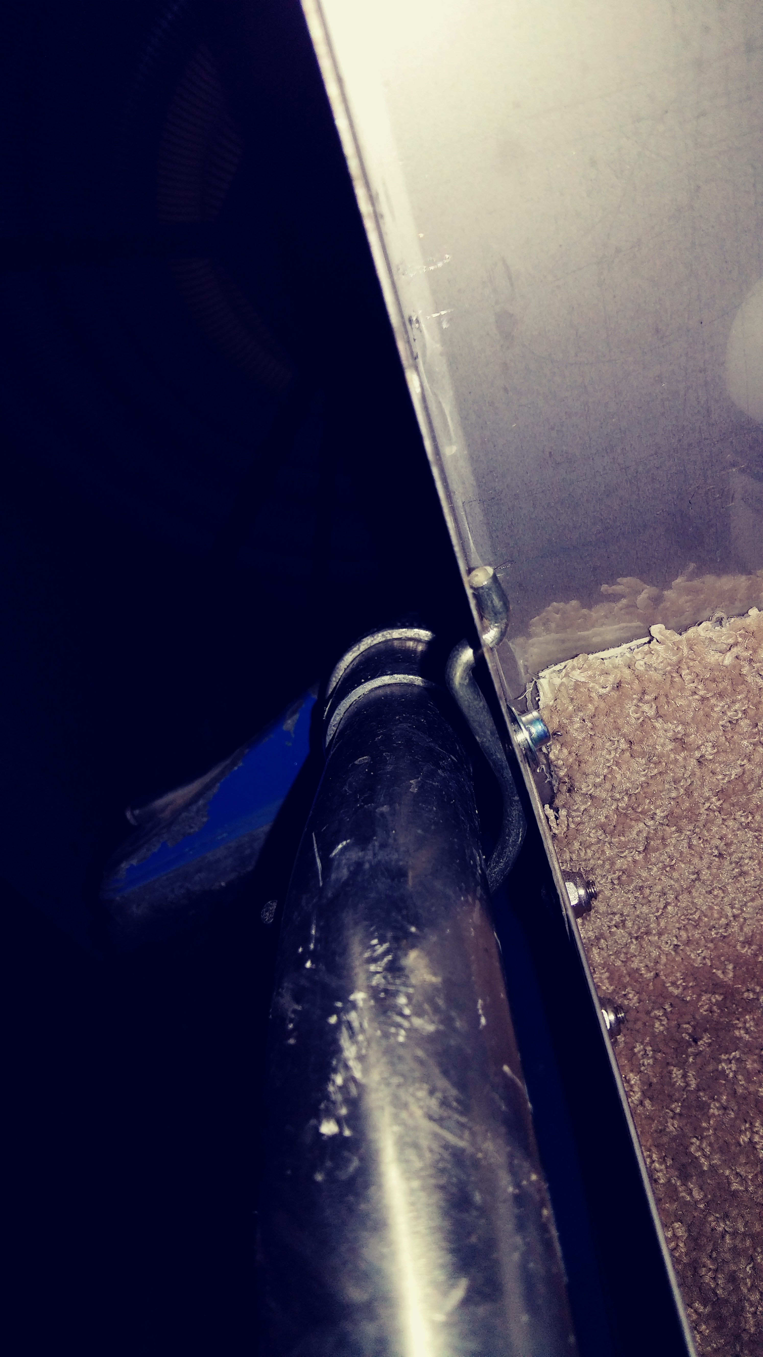

I used pegboard hooks. Used 3/8 cap lock pressed it on with channel locks. Had to drill one hole larger for the lower pin to fit.
Not perfect but been this way for a couple months now. I put the wands where I can get the jugs out without even noticing the wands. Screenshot_2019-03-21-19-54-07.png20190321_195346_Film1.jpg20190321_195317_Film1.jpg
