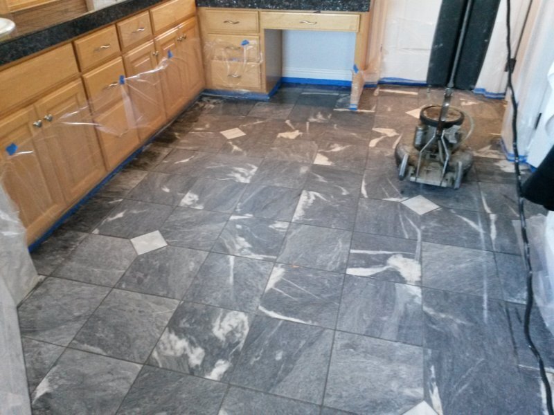

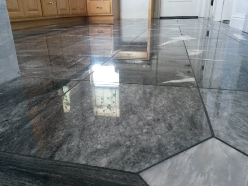

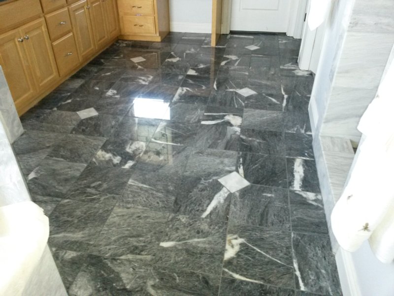

Ok I got my certificate for stone pro boot camp. Spent a boatload of cash on crap and finally did some marble.
220 sq ft $660 5 hours I need to speed up
We used a 400 grit diamond disks on a 40lb driver, switched to a 800 grit then used EMP
Rinsed with stone pro deep clean
Sealed with cobbs ultra seal.
When I gave this bid she needed some grout repair so I referred her to a competitor, he never called her back so I got the job.

Are there before shots in those?

Ya first pic was before so was 3rd. It had some reflectivity but brightened up a lot and had more reflectivity when finished they were happy.
