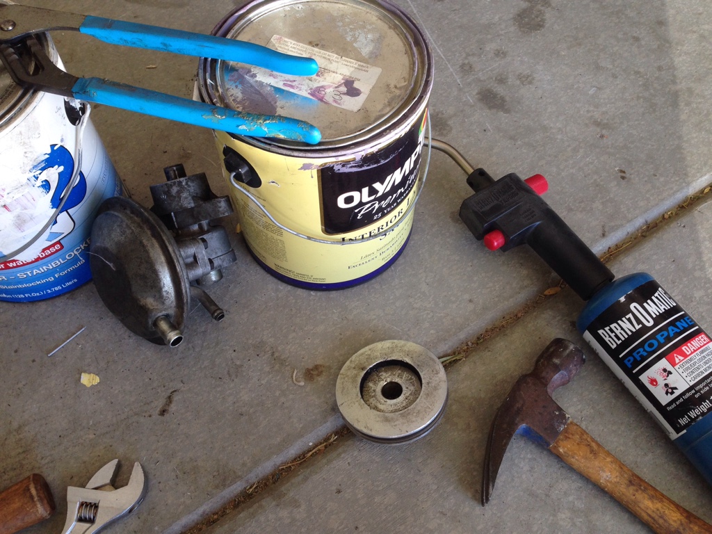

My PC 405 was making strange noises and it happened to be the air pump for the heat exchanger took one apart before on my old machine had a vice on a table to get the pulley off. No vice this time and it just won't come off!

Al ready got a new air pump just can't get the pulley off the old one

Pulley remover. Jondon pressed mine on and off for me. When I bought my 405 I had zero air at the pump. Lots of auto parts places lend tools like the puller for free with cost of tool as deposit.

Got it with some heat
