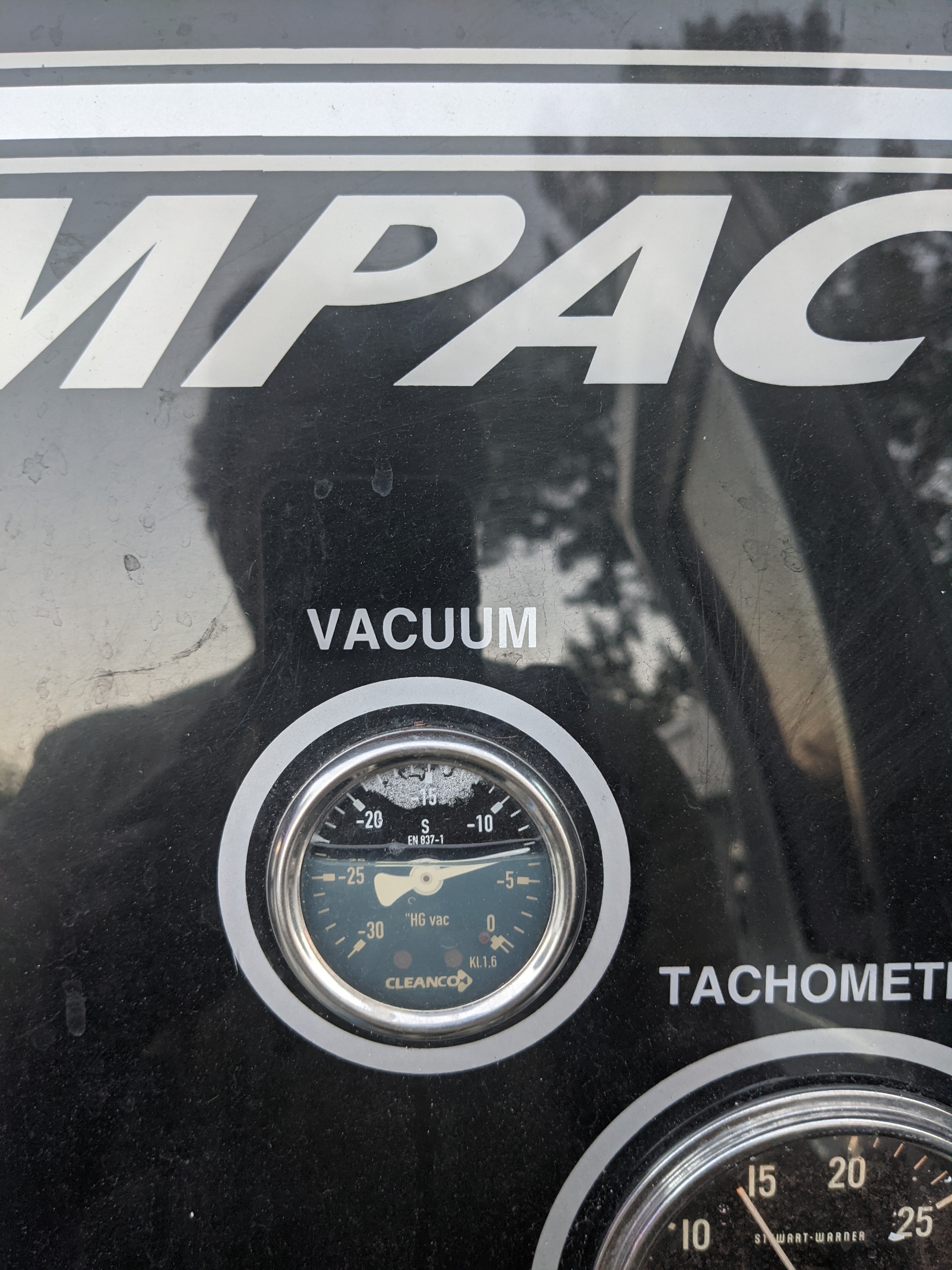

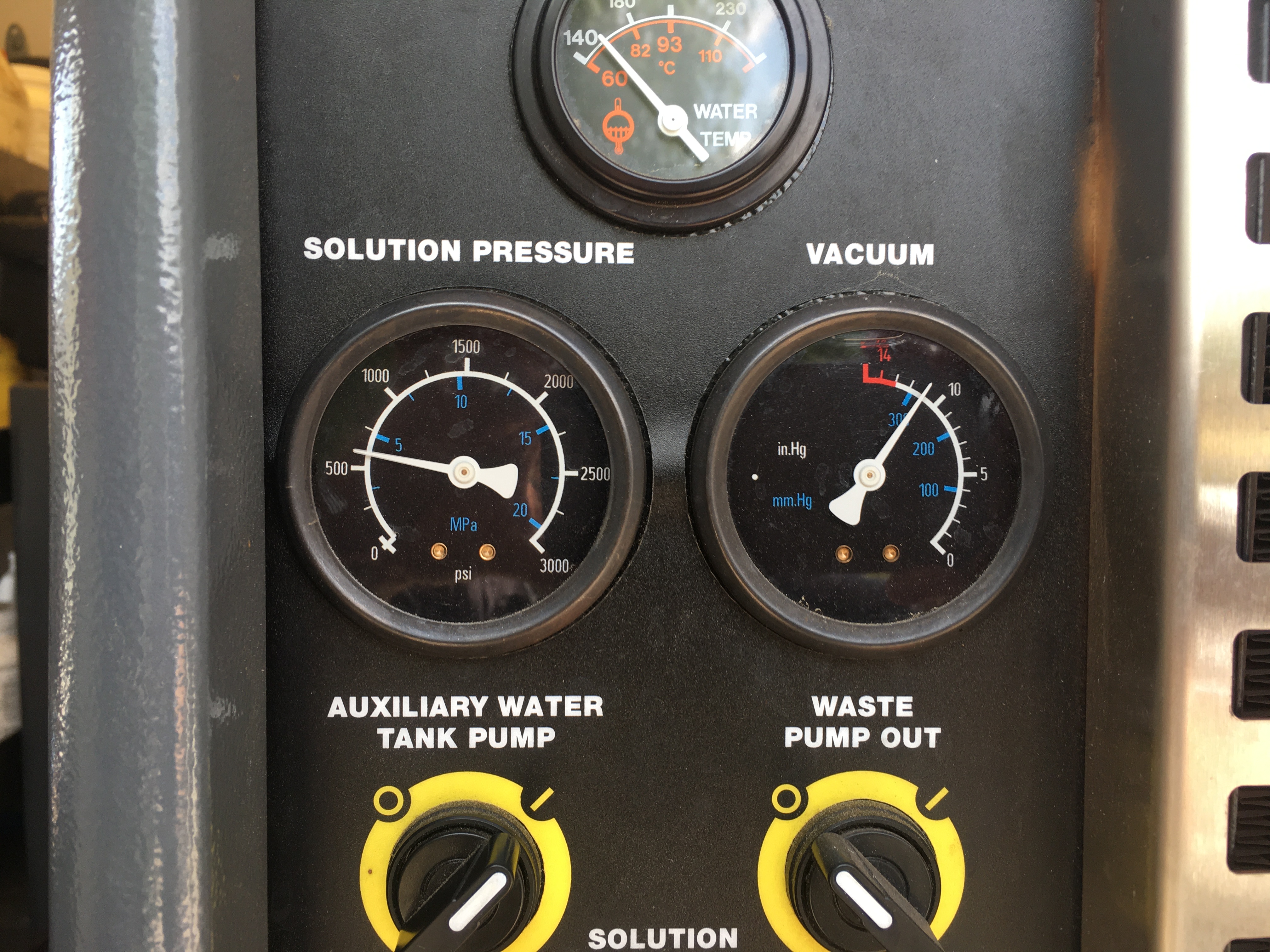

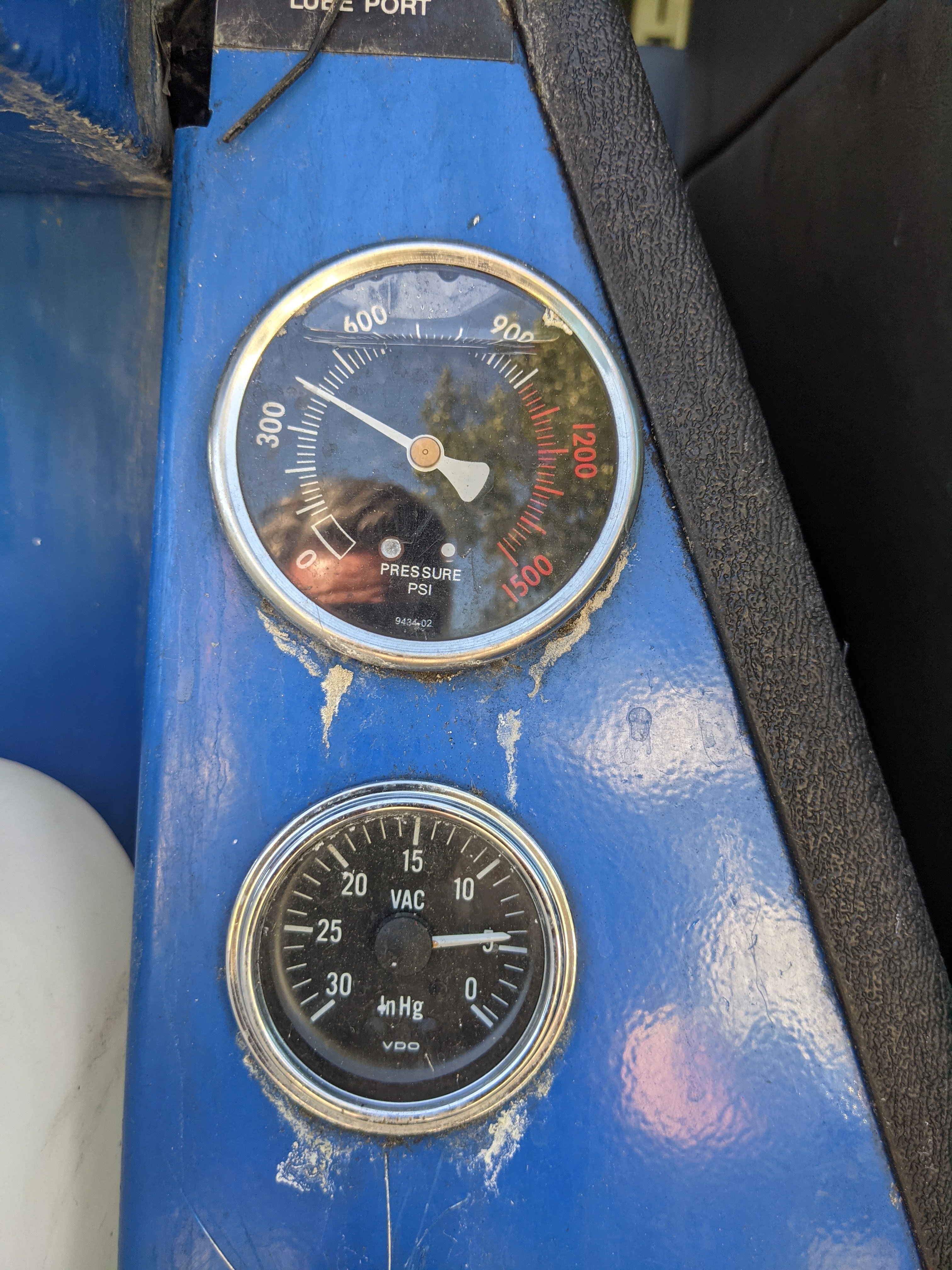

We should have everybody check their truck mount and post the results. Hook up 75 feet of hose to a 1.5 inch wand and see what you get.
