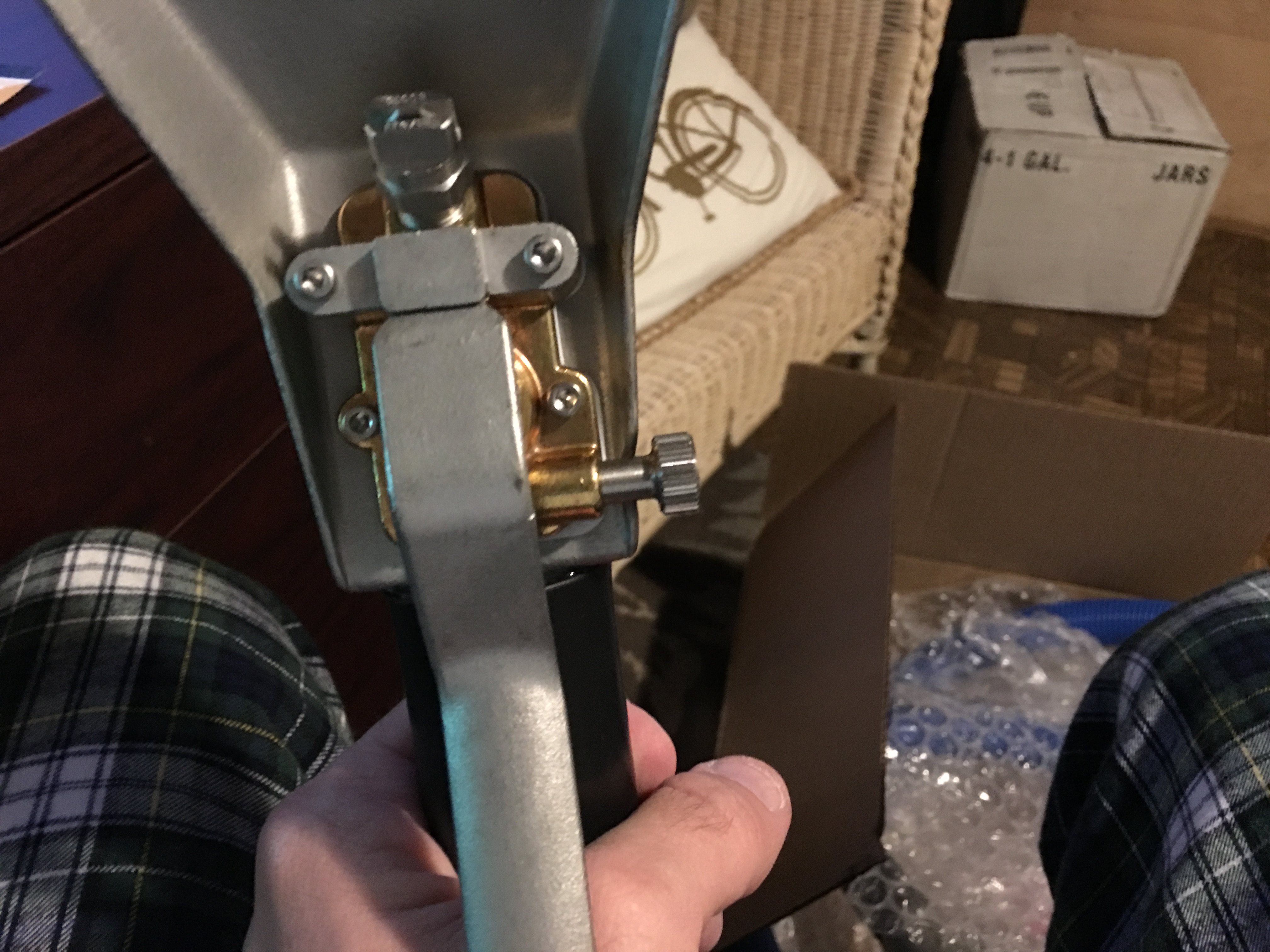

Hey goobs! What does this do on my prochem upholstery tool
14,646
That little silver thing that spins. ???
It's a bypass control knob. You can really get that tool smoking hot very fast.
14,646
Is that all? Dang. I was hoping it was a pressure adjuster. This isn't an amtex wand. There's no need for that
Yes there is. How hot do you like to clean with? I liked it so hot I wore rubber gloves. Some people don't like cleaning that hot, so you dial it to your preference.
Most cleaners trigger off and on as they clean. This will keep the hot water from ever getting to the fabric. With the bypass you get the heat to whatever temp you like consistently.

14,646
I’m gonna need to experiment with that feature. I always triggered off and on and the tool gets so hot, sometimes it’s hard to hold the Handle. If this bypass makes it hotter than that, I’ll just leave it off.
By creating internal flow, which keeps your available heat flowing to the fabric, it does reduce pressure to the face of the fabric. As you loosen it, you will notice reduced flow from the jet.
14,646
Makes sense. So, if I"m doing a job with carpet and upholstery, could I leave the pressure set at 550, and just open the bypass halfway when I get to the upholstery?
Yes. You can take the pressure down fairly low. Watch the stem and stop when you see the o ring, then back it in until you can't see it. That will have you at a pressure that is fairly safe for anything but the more delicate pieces.
I used that tool and taught with it for many years before the advent of "dry tools".
Use the usual cautions on white natural fiber fabrics and things that might not be colorfast. Get a glide for it and you're less likely to permanently distort velvets and chenille.
One last thing:
If you DON'T back the stem back in when you see the o ring, plan to be cursing and searching the room after the pressure blows the stem out of the valve and into oblivion.
It's a great flushing tool, just heavy but it will last a lifetime. It was my favorite for years! It has its place but as Jim mentioned get the glide for it.

You'll get tired of using that heavy tool way before you're done, but it will work great for you.
Using them reminds me of using unglided, stainless steel wands back in the 70s through the 90s: You didn't know how hard you were working because you never had anything easier to use.
Save up your money and get an Upholstery Pro when you can. But in the meantime, that tool with a glide will do you a lot of good.

11,570
It increases and decreases flow.
The more flow the hotter the water.
But yes when you decrease flow it bypasses more so the machine doesn’t overheat
