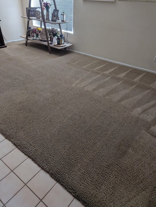

Is that a ripple on the carpet near the wall
I don’t know. Looks like it. This isn’t one of my jobs. It’s a picture some cleaner posted on FB showing his work. I asked him if he used a CBM on it, not that I couldn’t tell without asking, but because I wanted to drop that little bomb on his thread. He said yes without even thinking. Just look at the corn rows. You see that on all cut piles that are crb’d or OP’d.
What's a CBM?
Reactions: Kenny Hayes
28,004
I've used cylindrical brush machines since the early eighties. They were always approved by the CRI and other organizations. The CRB's are a little different as they are counter rotating brush machines.
