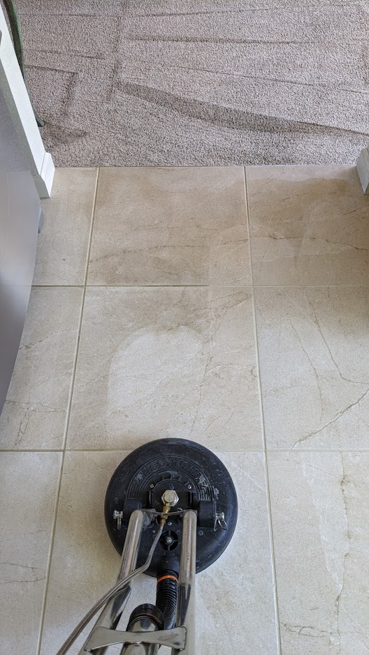

You seem to be hung up on the epoxy grout haze remover and in this case none was used, I posted a picture sent to me by the homeowner of what she used

Which is exactly what she is doing, but now the tile is so absorbent that plain water is staining it..

The whole floor has been colors sealed. the light area is where she used the haze remover.
At this point she has give up as water is absorbing into the tile and leave marks.
