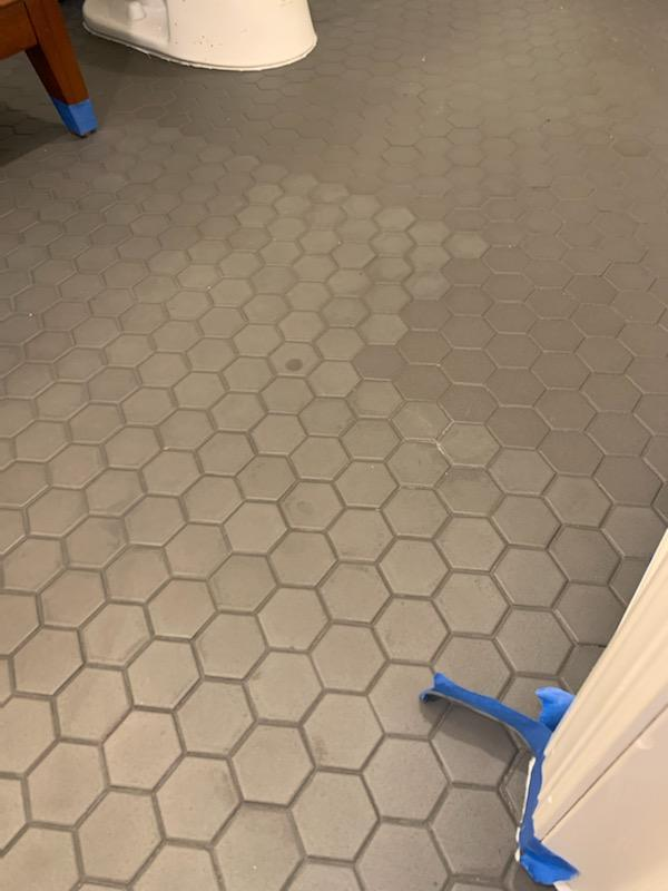

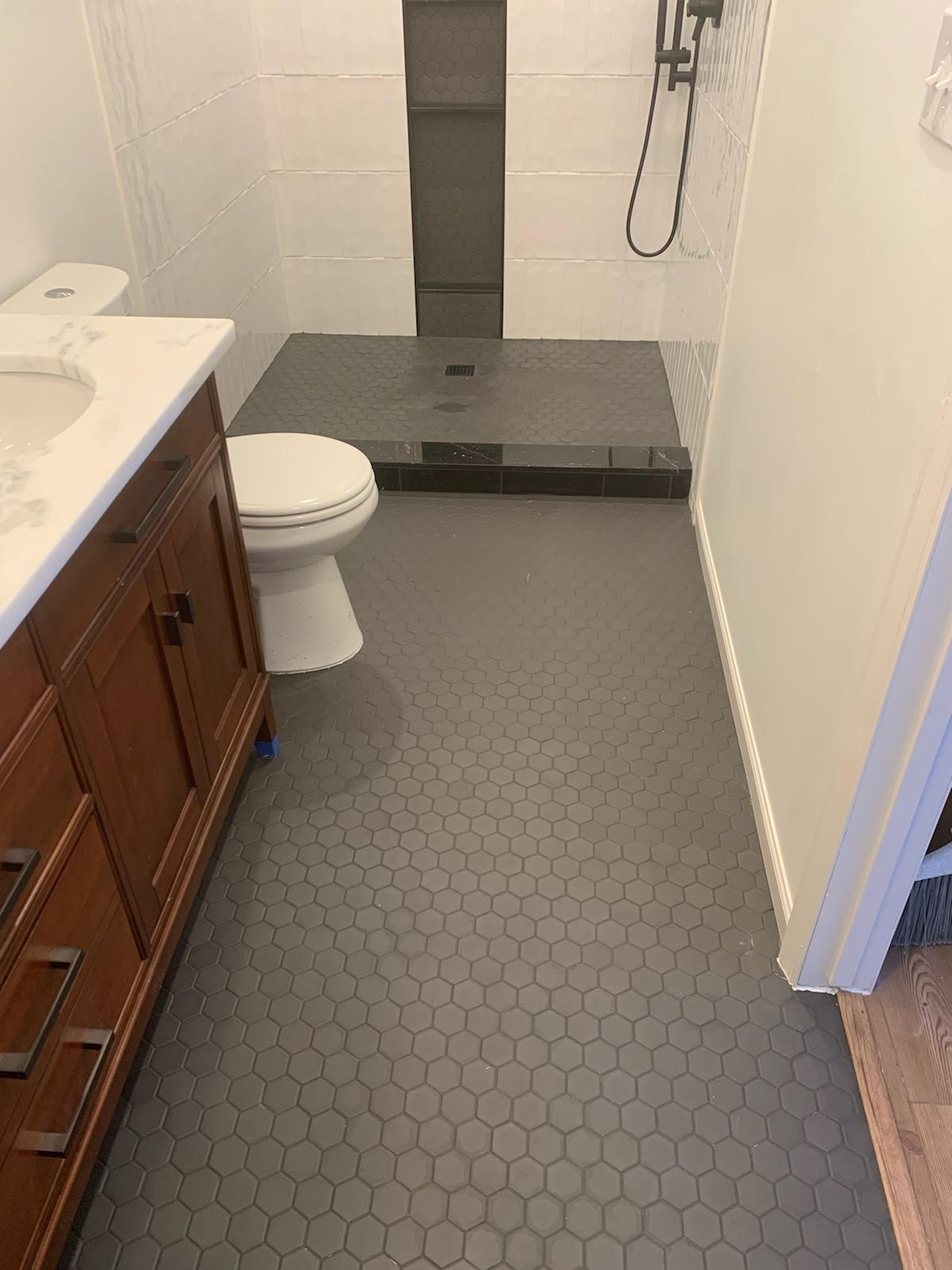

Interior designer picks an unglazed porcelain for a master bath floor and shower stall.
Homeowner decides she does not like the color of the grout so she applies a color seal.
During the removal of the excess color seal, a coating of sorts comes off the "unglazed" porcelain...

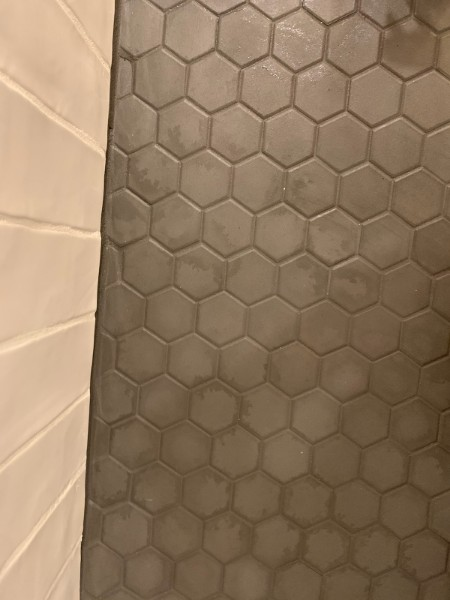

In the photo below, the dark irregular rings around each tile were created by just water when it dried. Up top you can see some remains of the coating.
The manufacture, designer and install all have been zero help.
The manufacture told here once you use chemical on their product, you're on your own....
She found me by doing extensive term searches and found our ongoing porcelain thread on Mikey's Board.
My advice was to tear out both floors and start over. Unglazed anything does not belong in a bathroom and color seal certainly does not belong on a master bath shower floor. We had a great conversation and she was thrilled to have my bad news confirming her nightmare.

If she had never touched the floor and stated to live on it, all the acidic shower products out there would have lead to the same disaster.

and you sure that isn't epoxy grout haze/residue?
or a sealer they applied?
*I'd expect it to end darker.........and not be so even...but

yep, this lady is a pharm rep and on her game.
Water stains it now that the glaze on her unglazed porcelain got removed by an acid.
let that sink in.
let that sink in.
I'm having a hard time seeing the relevance of her being a pharm rep....
an acid like epoxy grout haze remover?
Does water stain it? Or does it just become trapped under whatever is left there?
116,178
She used Grout Haze remover, not Epoxy Grout Haze remover.
most every consumer tub and tile cleaner and maintainer is on the acid side.
well....I'm no expert......but before I ripped up that floor I'd do a proper haze/coating strip
