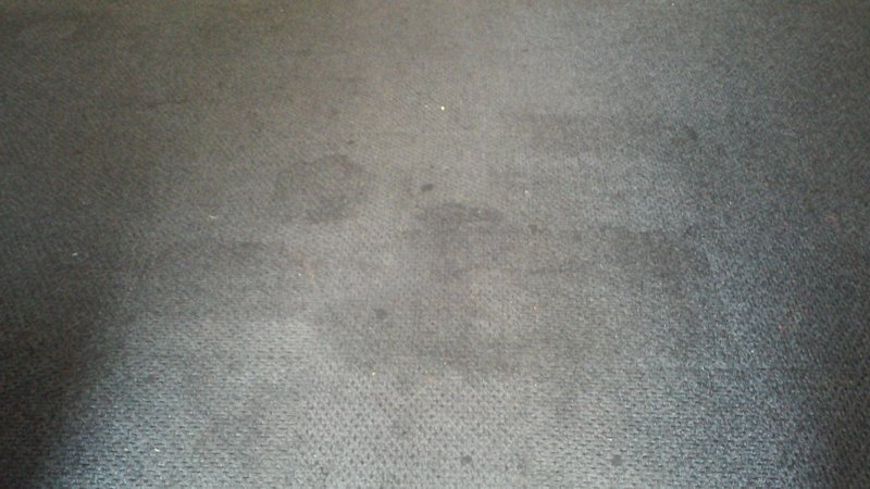

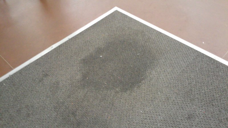

The first reply i gave them was a question. "What are you expecting from my cleaning?" Then we focused on the drink spills and fresh spots that they wanted removed. They are expecting the heavy traffic to stay there.
I'll go and take a pic of the other side to show u the spills that they want gone
Reactions: Kellie Hiler
14,644
From my research on cimex...it's not made to restore carpet. It's purpose is to maintain it. As for an op...you're correct, i don't know enough about it to get one
14,644
Here's the trashed side

Incorrect, it's used as part/day two of a true restoration process.
Day one, dry and wet flushing of the carpet.
Day two, polishing of the dry carpet.
I agree fully. That's why I was planning on getting some absorbent pads for my 175 if the HWE didn't do the job.
