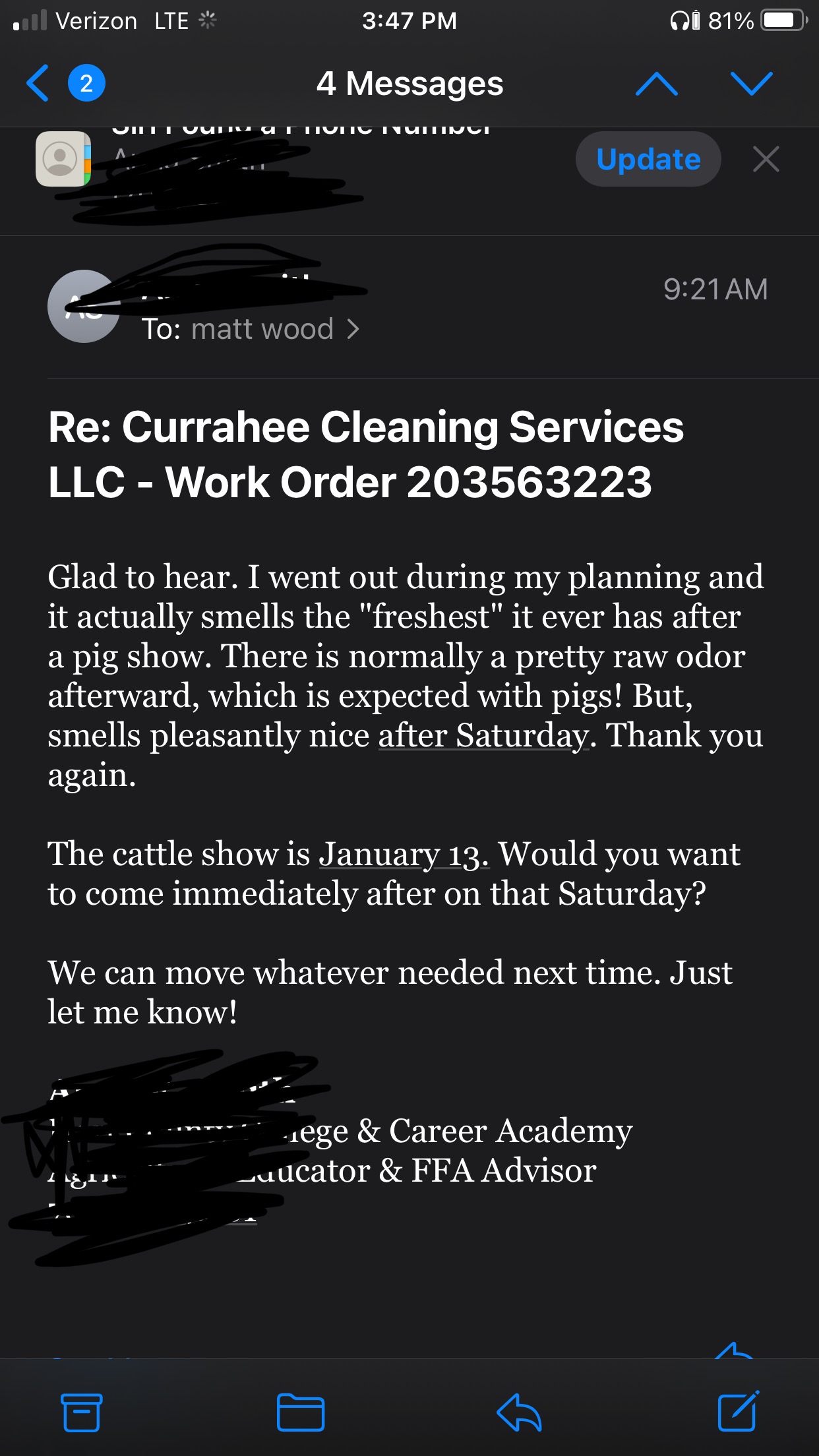

I did another pig infested astroturf and I got the best follow up I’ve ever received. I’ve tried every chemistry known to us for farm animal biohazard cleanup and finally found the right treat and rinse
Treated with 8.5ph liquid carpet cleaner spiked with milban 123 and rinsed with skunk out.
After over a dozens attempts to HWE with enzymes, oxidizers, sodium chlorite flakes in treatment and rinse, acid rinse, it all gave results not worth celebrating.
Thanks Harvard!

Does Bio-8 have bacteria killing capabilities? Because that "raw odor" she normally smelled afterward is from bacteria growing from whatever junk needed to be killed

Tell em, to get stuff mooved and you'll be there Jan 13th hahahah
