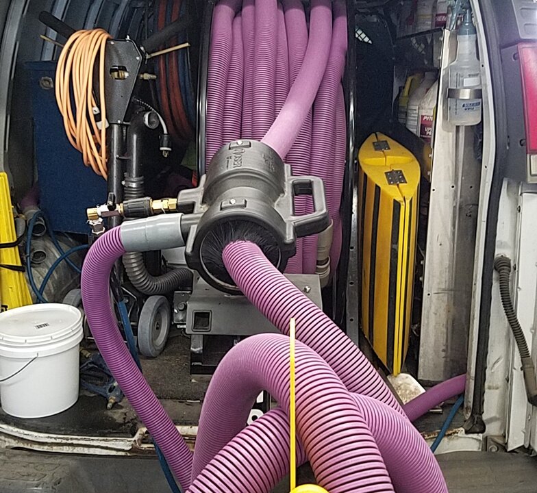

so a guy on facebook has some hose I can get cheap but its 1 1/2 inch. If I want to do a 4 to the door and use a 2 inch hose and a 1 1/2 inch hose from the machine to the Devastator would that work?
so in essence it would be 3 1/2 to the door

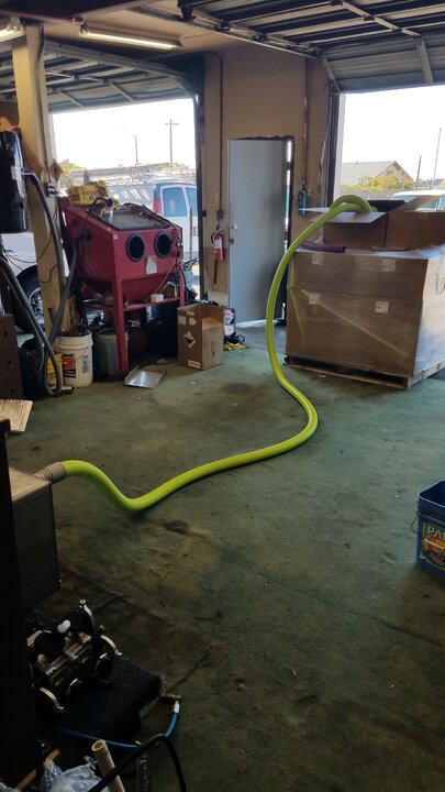

How much are you willing to pay for used hose? I have several hundred feet of this 2" hose in 75' and 50' lengths (at least 600')(1-50' new in the box)its all Amflex Plastics hose. I had it custom made , ive since changed the color to frankinstien greenAll in great shape Shipping would be from California i also have it in 1½" and some in 1¼"

air and water flow dont like to be confused...
Keep all things balanced and never ask either to make a decision.
I experienced that when I tried the 4 to the door method. I noticed that one hose took all the air, and the other was filled with water, which killed the suction because it separated the CFM from the Lift.
We all know that Lift and CFM only give the best performance when they are combined, since the more lift you get, it gives the power to increase the CFM of the water. But when there's one hose with just water, and the other with air, both areas are decreased dramatically
I don't know if anyone else had experienced that problem, or it was just me, since I was using a hydra master at the time, and I had the machine set at 12hg on the blower because that's what the manual and JD instructed me to do for that machine.
But I hated doing 4Tothe door after that experience. The first 50-100Ft of 2.5" hose is way better than 4tothedoor
