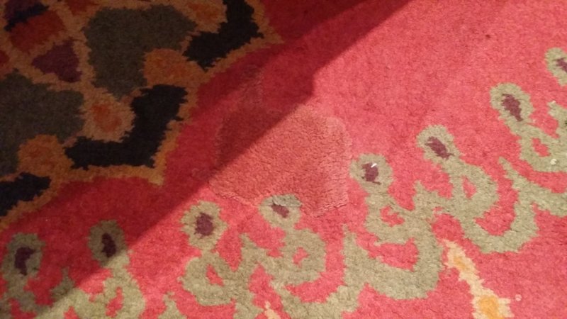

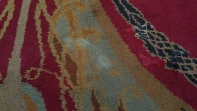

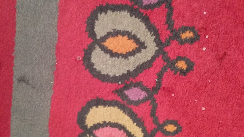

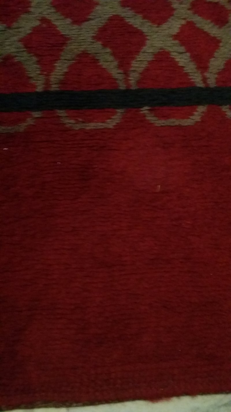

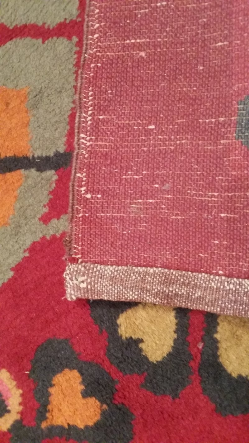

It appears to be an old Turkish Ushak. The church staff need to be shown its bleeding propensity. This confirms to them that the bleeding is an issue with the rug and not the cleaner. I am conservative in any approach that I recommend. I believe in primarily protecting the aesthetic integrity of the rug and secondarily getting it as clean as possible. The safest way to do this is to use the Brush Pro powder with an encapsulate. A Brush Pro with wool brushes is essential to efficiently remove the bulk of the powder and limit any damage from agitation. I would have a Studebaker type of fan and use it to dry it quickly. Test this procedure in a small inconspicuous area. When it is dry then bleeding stops. Our Maxim Advanced for Upholstery with Dye Loc was made for this type of rug. You still need to pre-test in an inconspicuous area.
A carpet cleaner needs to have many tools to accomplish their work appropriately. I am not a one method man for oriental rugs. Encapsulation with powder is a method that gets the rug cleaner, extraction improves that cleaning, and the pit wash is the best. Remember that more water creates more issues that you need to be prepared to resolve on the spot. Rug washing demands experience and some of you get to only clean 5 to 10 rugs a month. Do the methods that you are comfortable with and do not allow your self to be persuaded to go out of your comfort zone. Punting is a good play in football and so it is in oriental rug washing. If you do not feel comfortable then do not do it but get more education so that the next time you may know how to handle it.

I have seen a few Ushaks in my time and that was my first impression and not a studied one. I always had an issue with age. I learned rugs in the rug trade where age seemed to vary widely from one person to another. The rug industry did not share knowledge like this industry. I always felt that I never could trust another rug dealers opinion as they were using their knowledge as power so that they could buy rugs cheap.

Mikey;
You have not addressed the "repairs" badly needed on this rug .
117,375
Our building partner who is a rug washer in the purest sense of the words, will be doing the repairs onsite.
He worked for Robert Mann for a while and even he said no way to washing these peices, even if they would let them leave the premises

Beware, if someone who has a lot of rug knowledge has seen them firsthand, then his on site opinion is more important any opinion gained from looking at pictures. In any event, test, test, test. In my opinion, half of the job is removing dry soil and if you stop there you have significantly reduced foundation wear. Sometimes, I do my pre-testing for bleeders on the back of the rug.
