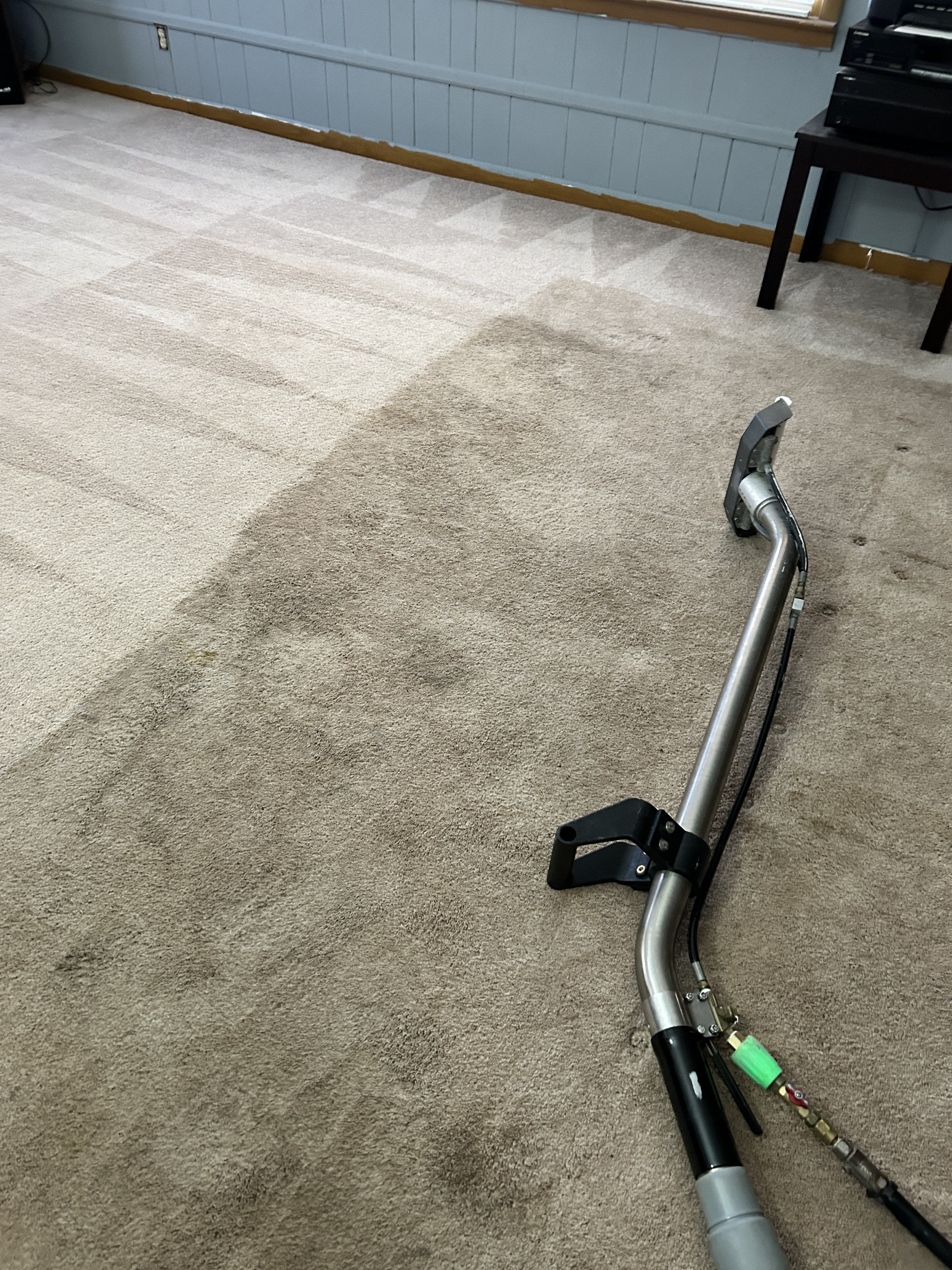

I’m shocked. I’ve always used slot glides because I rarely clean “clean” carpet. But this hybrid glide extracts better. I thought I’d need slots to remove the sludge. Hybrid removed all the sludge and more water. It’s witchcraft. This new customer had been using a local padder for a couple of years. He saw my van and wanted to give me a try. You can imagine his surprise.
what wand is this? devastator?
117,387
Yep. I do have a Sapphire 14 that I’d like to get a hole glide and a brush glide for. It has the slot that came on it. It’s a great wand also.
Im my expert opinion the oem glide is to wide open, too flexy and too thin down low.
Any GG option will increase performance and decrease stress on you body.
