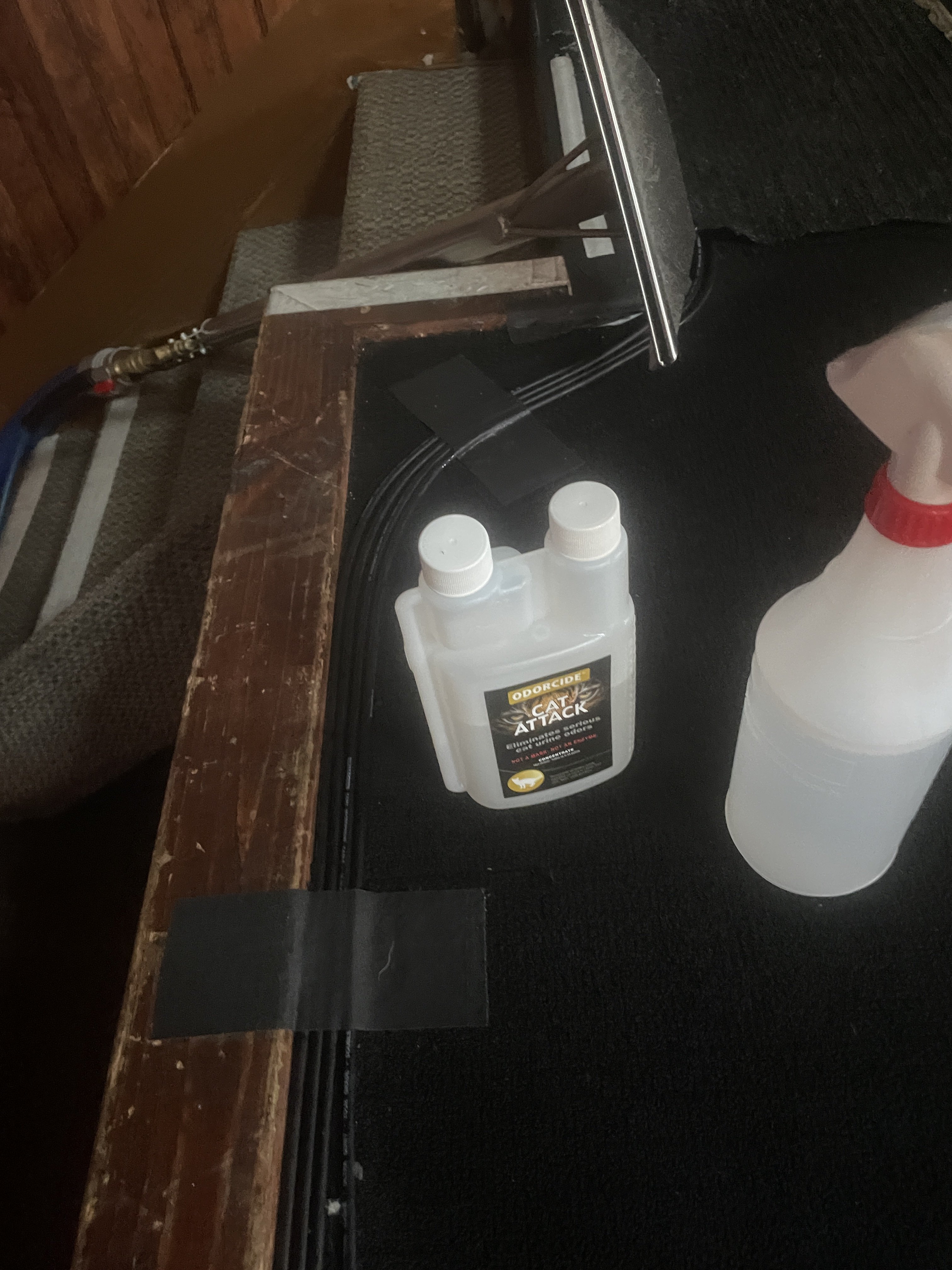

I've had good success with it. I use a long syringe and needle and make injections beyond the backing.
Oct 25, 2016
3,231
Swani
What the heck? Just spray heavy and stomp it with your foot.
That works too, but depending on the situation, getting the product under the padding and to the subfloor immediately seems to help. Often, I'll inject then spray heavy on top.
If I've got a whole home of piss, then I spray everything heavy and CRB.

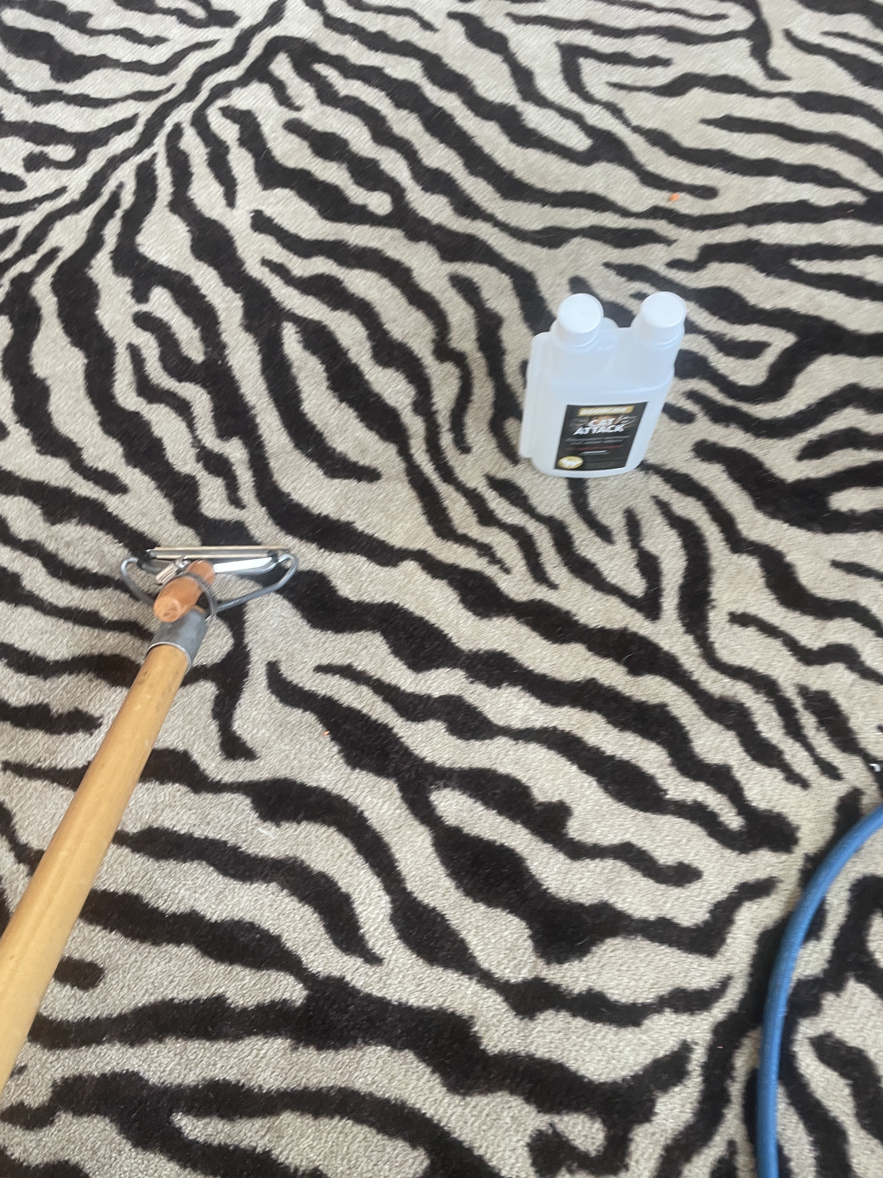

Another rare commercial job. Drink making area for servers to grab and serve. Rotten stinking nasty alcohol saturated and stank.
Used HWE, and VLM, and @Odorcide Cat Attack. It did the trick. Perfect timing for the sample. The next job was a house that had 2 Great Danes and a 19 year old (small dog). The call was for the odor.
They were also very happy.

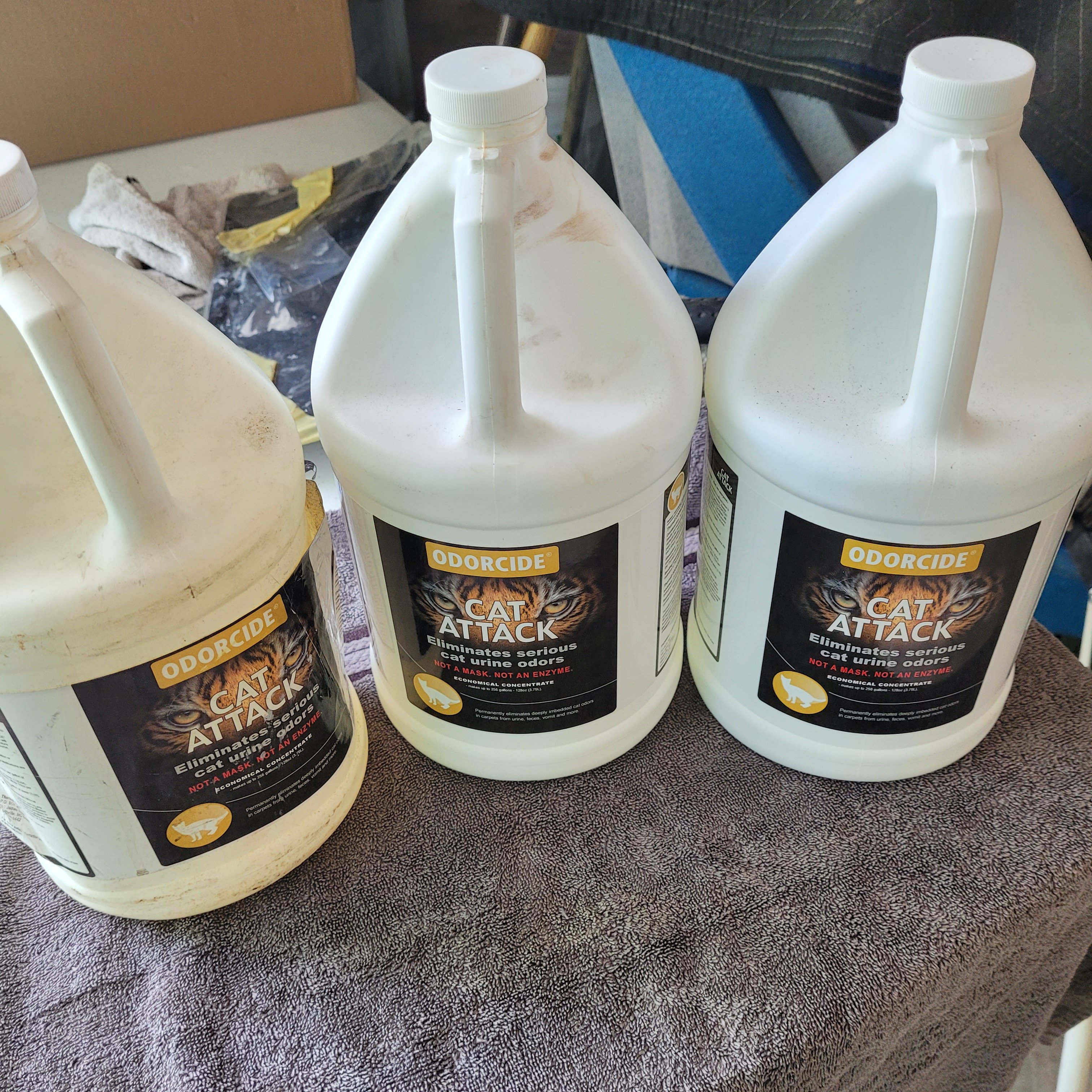

Odorcide Cat Attack can be used as a urine treatment or odor modifier for any surface. To break away from the citrus scent I add a few drops to a pre-spray, to a waste tank, or vacuum hoses. It helps to break the
scent in the house developed over the years, especially in cases when exotic spices are heavily used. I have a small hand pump ready for a Cat attack when I'm exiting the customer's house. It's always nice to leave a whiff of green apple/peach behind.
I have " only " three jugs left 👈
