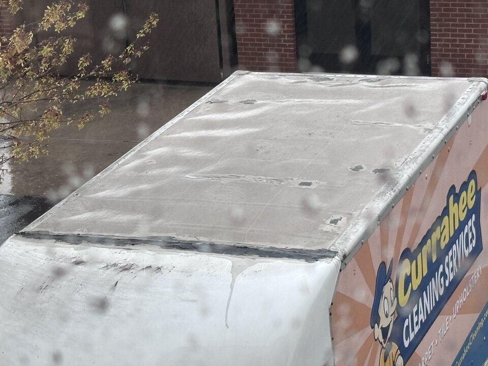

I’m thinking about getting a new roof to put on top of this roof. Leaks keep popping up and I was wondering if I could buy this type of roof in a sheet of the fiberglass material and put some sort of adhesive down with pre drilled screw holes.
Any thoughts?

I think I rolled mine out with snow coat or something like that from Home Depot. Never leaked again and reflected the heat so it was cooler inside.

Try a coating of Henry's Tropi-Cool white silicone roof sealant.
White deflects the heat and it dries seamless.
