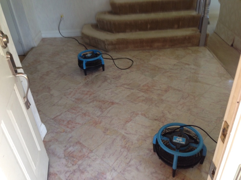

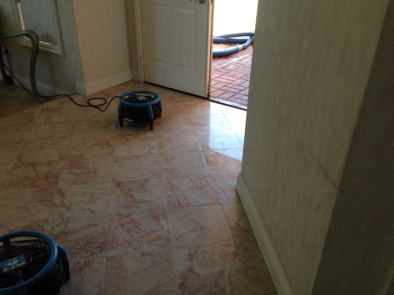

I used diamond renew hogs hair pad rinsed with a gekko. No grits just polishing powder.
Sent from my iPhone using Tapatalk

Sweet, how was it?
Was it full before you started?
11,577
Dull and dirty

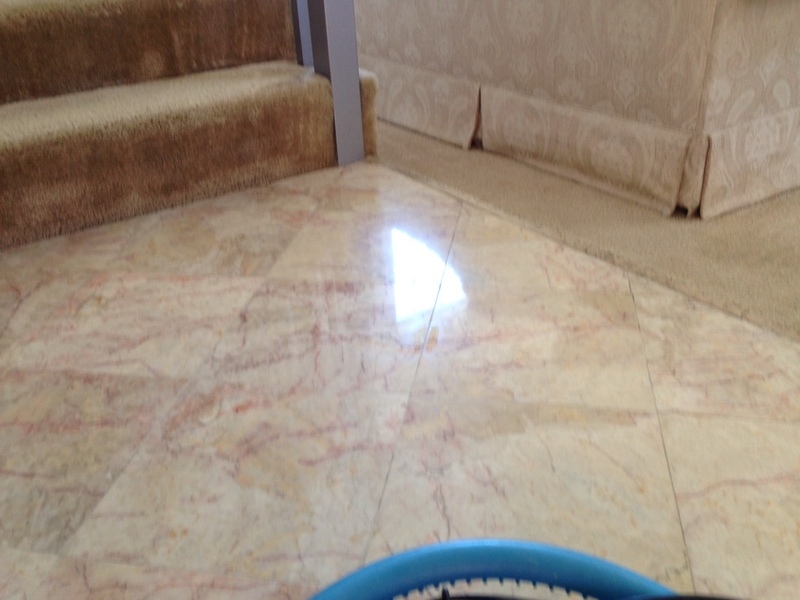

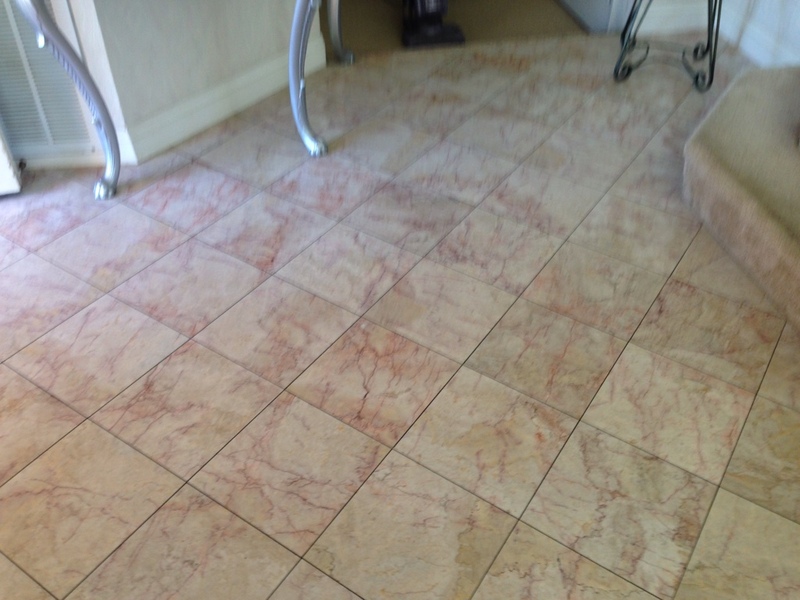

However, need to take better before and afters
You have to become a part time photographer
Have to learn back lighting to capture wear and clarity
Other than cleaner grout, can't see much

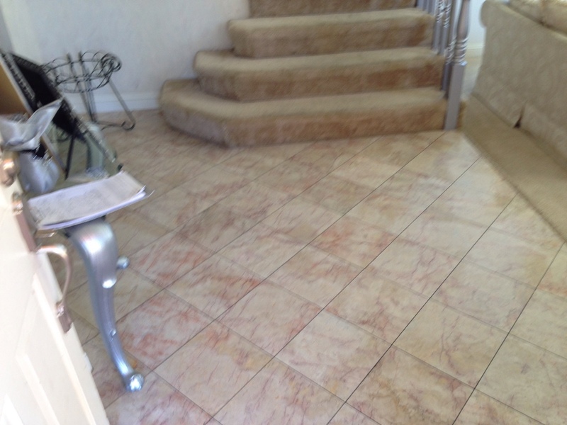

If it were porcelain it sure is scratched up a lot. My customer let me clean it to practice, and she loved how it came out. Obviously running through the grits would have made it really pop but I just wanted to start with polishing powder to see what kind of results to expect. Took about 15 minutes to do the entry.

Sam, that turned out nice.
I agree with the photo comments. learning how to take the right pictures can work wonders for you. Same position for before/afters is always good. Always show the distinct wear, and the clarity when you are finished. If you start building a portfolio like this, it will sell jobs for you.
