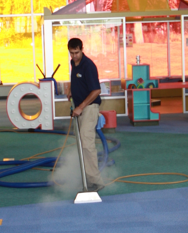

Sorry guys, I don't have any videos as I am solo operator! But I did take some pics a couple years ago when I cleaned some commercial with a couple other buddies. One had a demo truck with a 570SS (Sapphire rep at the time) and the other a Everest 408 with the Nissan engine. The Butler shamed them badly.
It was 33.8F that day and we cleaned at 450 psi with a 10 flow wand (5-02's), 50 ft of 2.5" and a hundred 2" vac hose. 150ft of parflex. Triggered most of the time the Butler never dropped below 200F at the wand over the 4 hours of cleaning. It averaged at 210F all the time. Since then I have gone up to 5-03's and get even better heat. I have never dropped below 200F at wand in the coldest of winter days and I work non stop in winter. And not sissy winters. In summer, it's crazy, smoking hot. Don't miss my old 260,000 BTU propane heater at all. The Butler loves high flow. The more the better. With the Zipper at 600 to 700 psi, the carpets are steaming for minutes after, and again that is on crazy cold winter days.
The heat is all you could ever want. Rock solid, steady high heat.

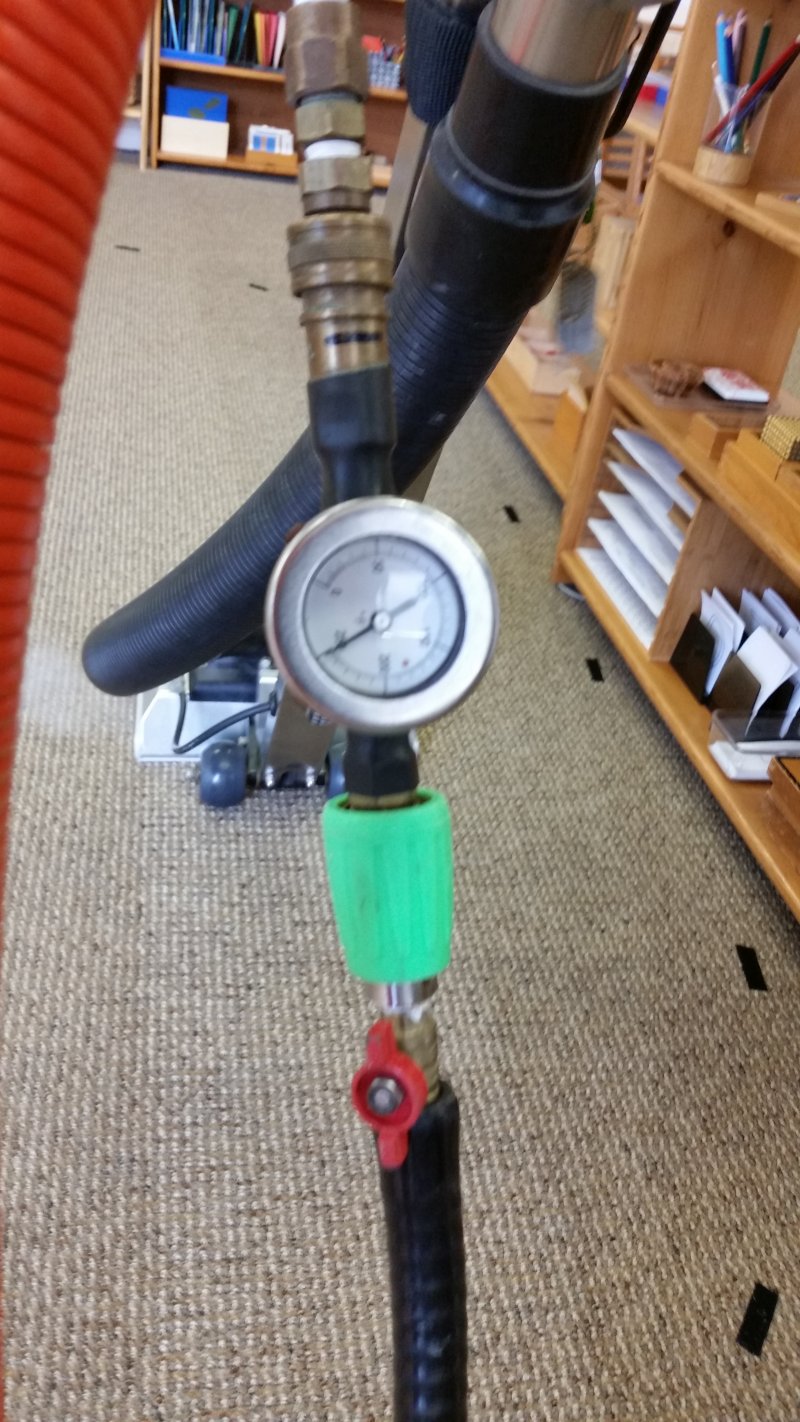

13" Zipper Jr. PSI 450, 9503 x 5 =15 flow, slot front glide, holed rear glide, 250° + temp gauge pegged, 4.5 blower out 200' hose, 25' of 2" the rest 2.5".... Granted the temp would be between 230°-250°+ depending on how long I hold the trigger down.... The longer I hold it, the hotter it gets...
I'd choose the Cimex/Zipper Jr on commercial jobs...... Works for us...
