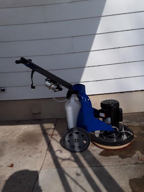

Here is my Phoenix bought from Excellent Supply

so prevac and clean in 1 1/2 hours?
What , you don't believe? Nothing like cleaning clean carpet.
If you can get it .
Watching the short clip, can't see much difference in the areas gone over vs. the ones not yet scrubbed.
Good if you can get it!!!! and 2 bonnets for 2000+ sq. ft. !!!! WOW!! saving on laundering later!!!!
