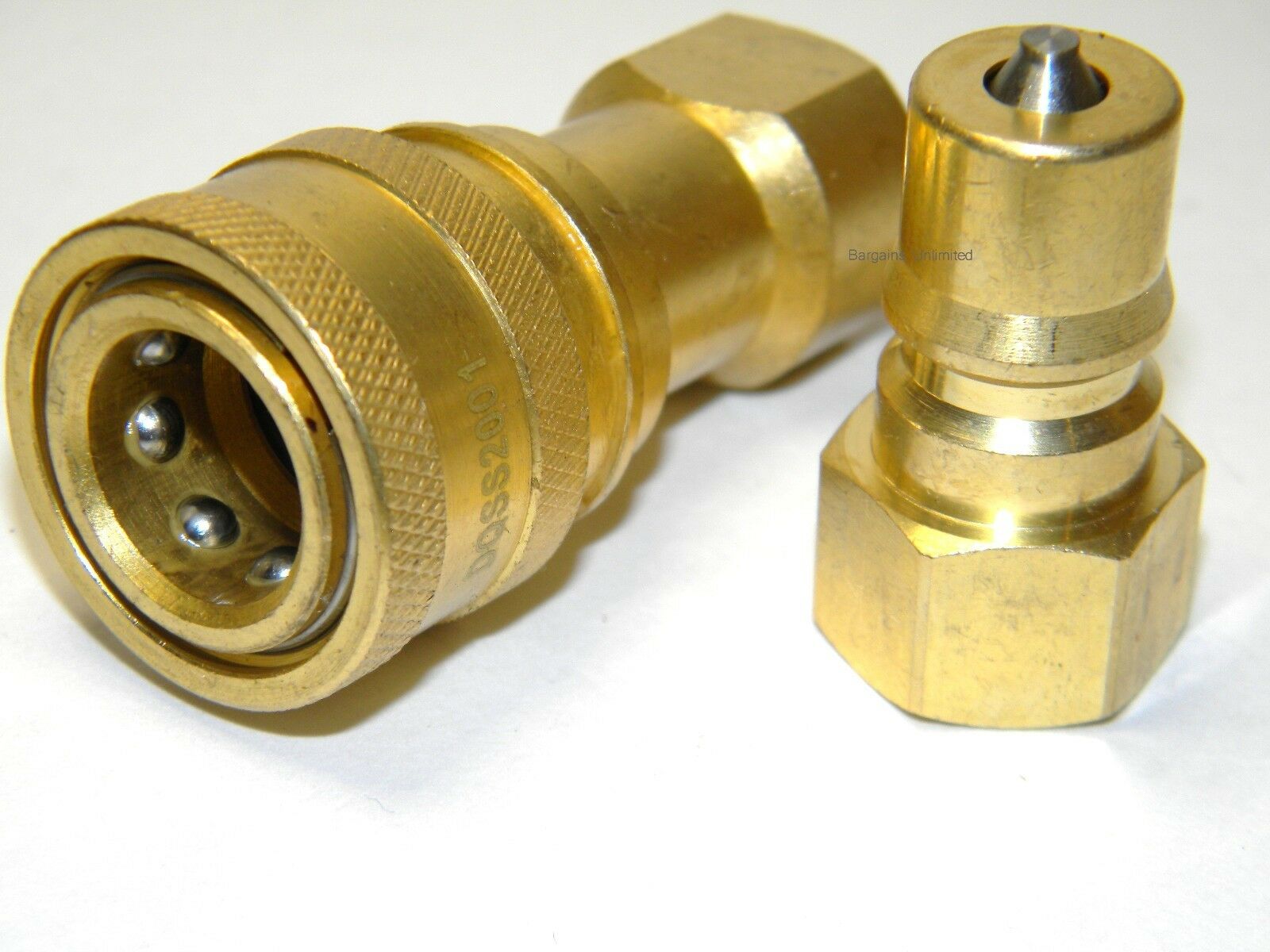

Hey, what options do you have to drain your solution line when you have a quick connect coupler on both sides?

never had to replace a male coupler because of a bad nipple, its usually the sides that scrape here and there and after awhile it doesnt fit in the female as well.
Dont bleed the line? Did you ever try to reel up a solution line with all the water pressure in it? Cant be good for the hose. let alone the chance to freeze. Rather replace a nipple every 6 months than a hose.

I strap a hose hook around the wand trigger and let the machine cool down while flushing any rinse agent out.
Once I hit 150 and its ran a minute a shut the machine off.
Then I start wrapping the hose up and when I have most of it reeled I disconnect the hose from the wand
