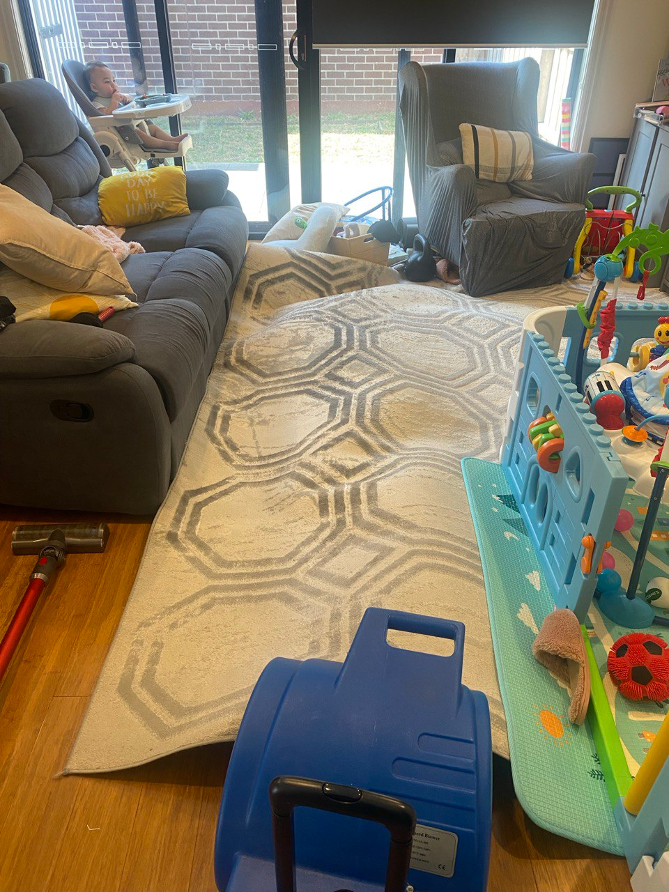

The blunder from Down Under
The culprit is hiding behind my son with an empty coffee cup...
