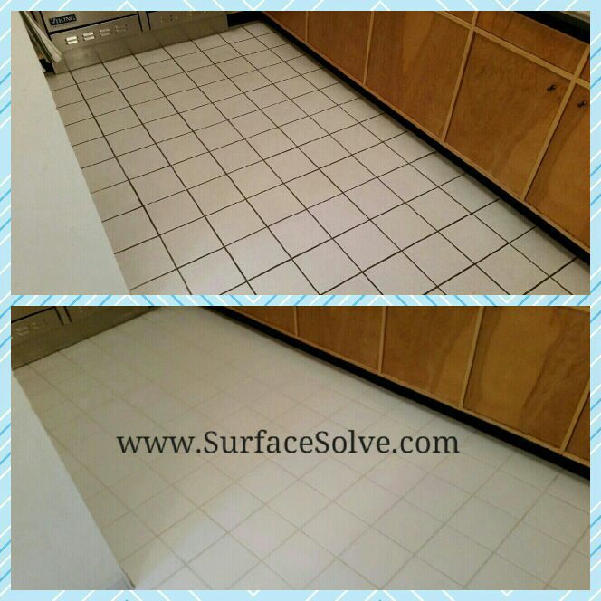

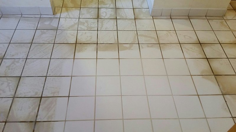

I finally got around to ordering some of this last week. Got it in just in time to try it out on a white commercial kitchen tile and grout.
Very impressed.
The shipping charges are a PIA, but if it keeps working this good then no problem.
This was cleaned first with power burst and a degreaser. Machine scrubbed, then turbo @ 1500 psi. Some left over staining. Mopped on at 5 parts water 1 part acid. Scrubbed trouble areas but hand and let sit for 25 mins.
Probably one of the most impressive differences we have ever done.

Why white? I know they are softer so that's why I'm wondering why not blue.
B
boazcan
Never tried blue. Tried black, too stiff to get into deeper grout lines. Out of my 2 choices white works much better.
