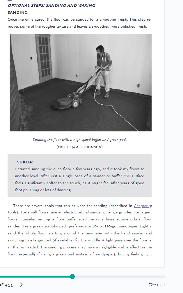

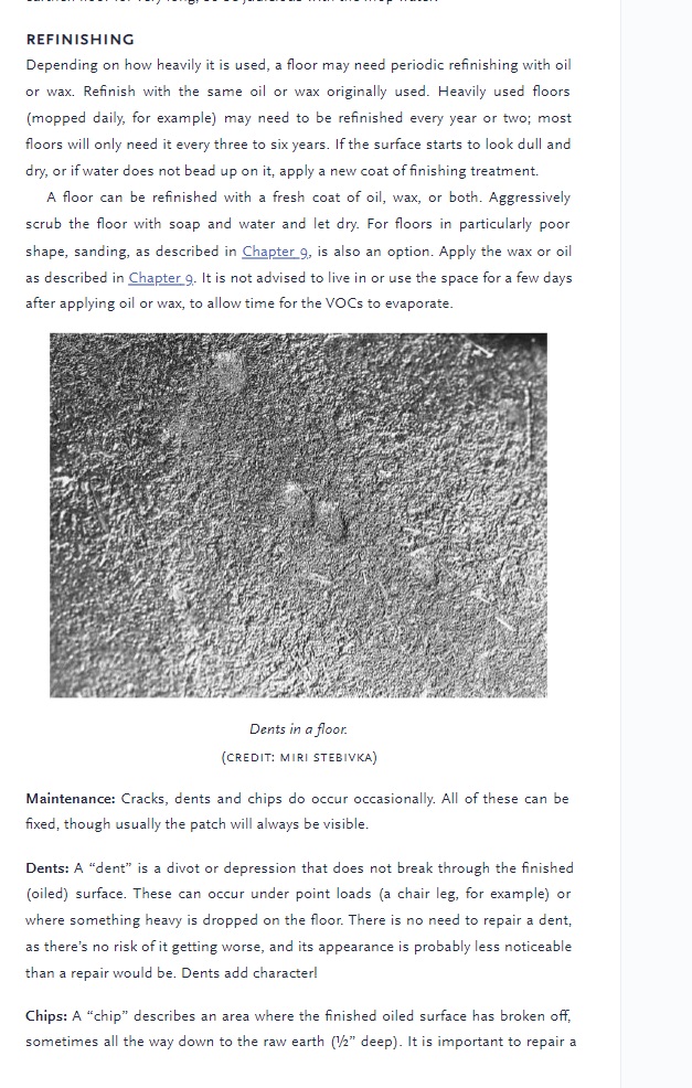

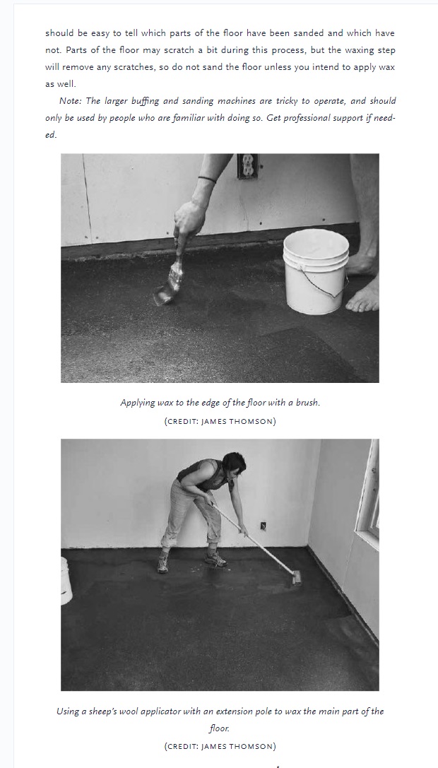

Hey Mike! This is *******, ***** ****'swife. My mom has a natural cob floor and wants to strip a layer of wax off it. She wants to sand it down smooth then reapply wax. It's cob so it's like concrete. What do your recommend?
I had never heard of this hippy dippy type floor, which is surprising haven't spent all those years in Santa Cruz.. There's actually quite a bit of info on how the build one but not how to strip old wax on without destroying it is there anybody here knows anything about cob floors?
