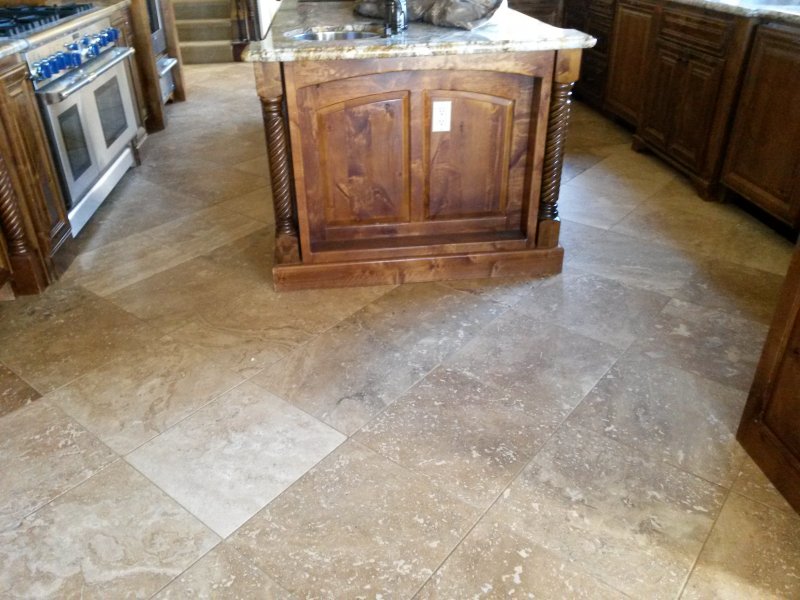

Just don't use any type of acid and you'll do great as long as there is no floor finish on it.
117,390
Travertine often times takes on a false shine as it ages and absorbs foot oil, mop residue and what not.
Your cleaning will remove that shine and some customers with think you bleached or etched the floor.
Check under rugs or in closets for the original level of polish/ hone and explain what will happen.
Its very easy to put a mild 400 or 800 level finish back on with just Monkey Pads
Its also easy to remove mild etch marks on Travertine with cream polishes or monkeys as well.
We'll do a class here with Cameron soon.
clean image
