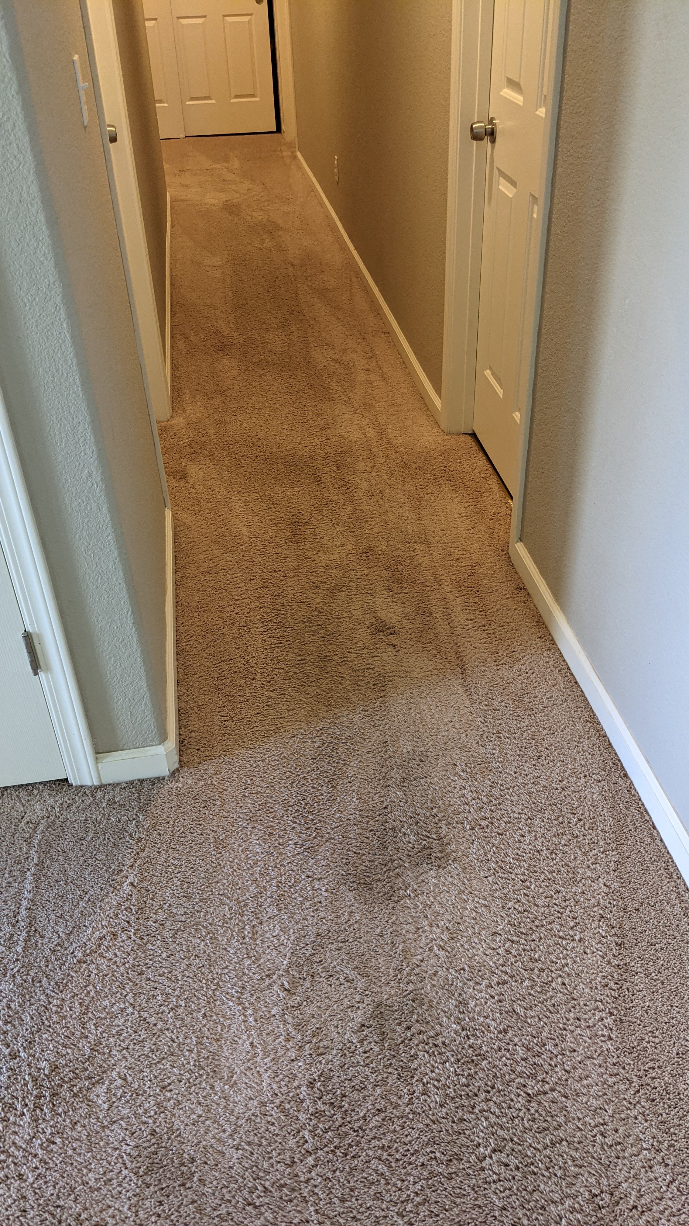

I dry scrubbed this joint today.
Thick but floppy shit poly..
With embedded Rottweiler clumps..

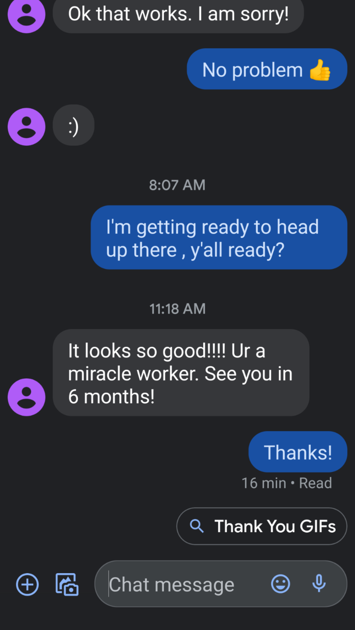

Got this a few minutes after I left..
