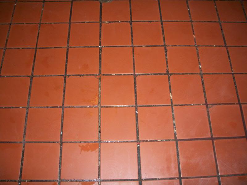

this places has not been cleaned in about 10 yrs..i really am not sure why i even took the job??
i used strong mixed powermax with a full scoop of powerburst..brushed with a 175 using the 3m grout
brush ring and then followed up with the hand brushing..it looked better but i still have what looks like
grease pushing through the grout..it looks good then after a little time it gets coated again, by little
time i mean less than a hr.

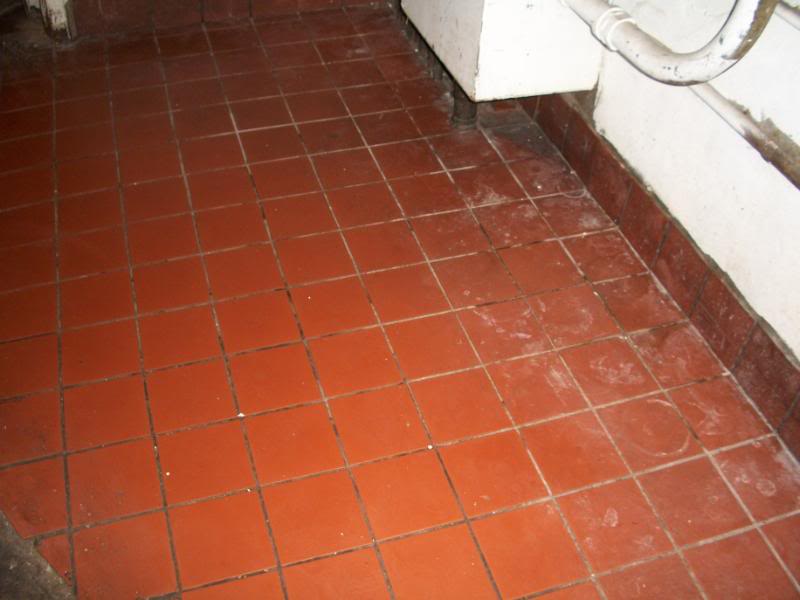

also the tile has a whitish haze in some areas..i am going to meet up with them on tues but i am sure
the hazing is wear in the tile itself..only thing ever done in the past was a hot mop this was the first
"real cleaning" it has ever had.
anything else i could/should do?? also am i right about the hazing?

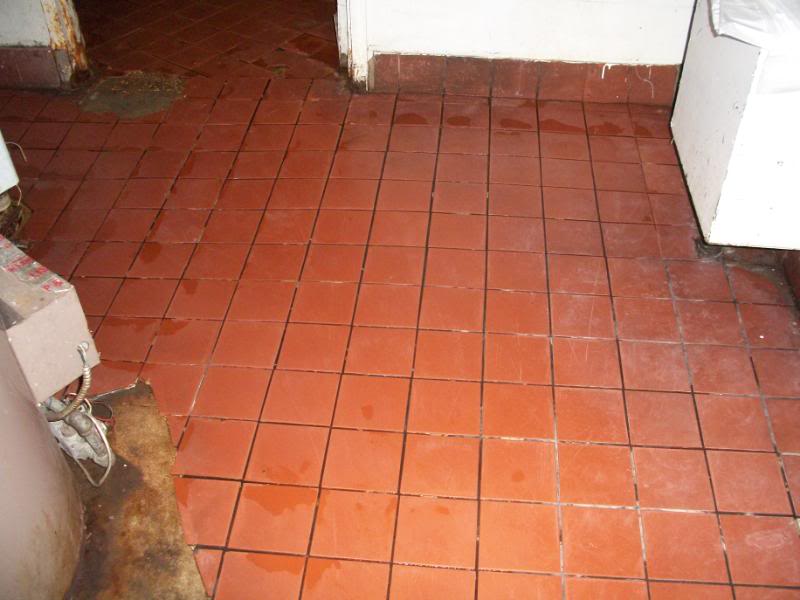

using a turbo at 1k psi and the truck (butler) was reading 220 at the truck
this is a close up after 2 cleanings..same night
this is the white haze i am talking about..the before and after
i can imagine them dragging things on the floor makes for some nice marks as well..
i love what shows up after it is cleaned then it is something you did..not because it was so dirty
that you couldnt see it before

i would try stronger degreaser-cleaners
follow by acid wash
have you been to Crown in Jax? Try King cobra and home run

The white haze is efflorescence.
It's not going to go away as long as you or they continue to get the floor wet. It's mostly calcium and a few other well formulated minerals wicking up from inside, underneath and around the tile. Fact of life when dealing with Terracotta/ clay tiles.
You'll need to use a heavy duty Purple Power automotive defunker to loosen that food in the grout line. Forget the peroxide products
and most likely a screw driver!
You should have walked but if you do get the crud out finish up the job by misting a acid over the floor and buffing it and the efflorescence off.

mix up the judson at 8 oz per gallon and add a little enzymes adn mix with 190 water and scrub with nyla grit brush and bam your done.

I think Mike's right about using a screw driver as the first step. You may want to go the other route, lower pressure and higher heat and see what that accomplishes. It looks like the grease maybe what is holding the tile to the floor.

Try one of Mikey's SteamBrite Brush, Grout brush Prior to 175 work, with Heavy degreaser Like Suggested about, Then Viper Venom Then Restore; Personnally I would use my Kero at about 275 300 degrees; 1200 psi; for that matter I would probably go even higher in psi; Face it; Not too much bad you can do from here; throw the Hale Mary!!

Crappy thing is once you start taking the grease out it may be blotchy and you'll have no choice other then to get a uniform clean. I'd go with the engine degreaser for sure and even add some citrus to that. If the grout is loose and grease is under the tile and working it's way out then well, their screwed. I'm thinking that they'll probably say it looks ok as it is.

Dave - I just did a kitchen today but it was ceramic tile and grout. I used bare bones stripper with powermax and powerburst sprinkled on top of a wet floor prior to scrubbing with a crb.
I used 1300 psi and I was at around 210 degrees. It was slow going cutting that grease even with my combo. Took my time, came out great.
If that was my job, screw the "carpet cleaner" stuff. I would go with the purple power mixture and add some weight to that 175 to get into the grout joints. Also, I would test a few areas of PSI up to 1500 if the grout and tile can handle it. Get the customers' clearance first. The light acid wash and buff has worked for me too on the white. Get some spray cans of wall base stripper and/or citrus cleaner to spray those baseboards. Let them sit for 15 mins and the hit them with a pressure gun.
You may could increase your water flow to your turbo also to either 03 or 04 jets. They should have 02 on there already. The higher flow works the same way on tile as carpet.

No cleaning agent is going to hurt those tiles.
But all that water is gonna cause massive sugar frosting.
