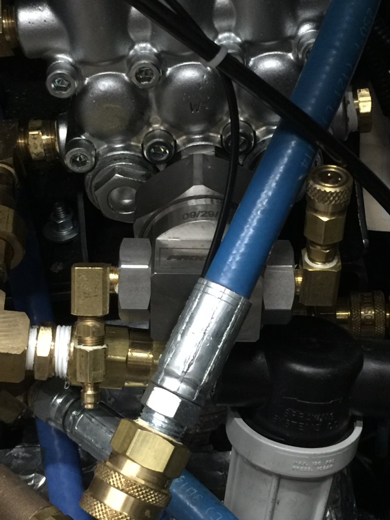

I am at the Cleanco dealer right now. We're having problems. Product is still going through the unit even when off the trigger.

Hole in the diaphragm or sticky check valve. Replace both

Cleanco had one of the check valves in the wrong place. Turns out they are copying prochems last step injection and make a mistake

Wow, look at those quick connects on the chem pump! Makes perfect sense....
Wish my tm had that......
Lots of beefy quick connects with the Cleanco. It's how you take the front panel off to service.

jcooper said: ↑
Lot better than having to unscrew and re tape everything....:hopeless:
