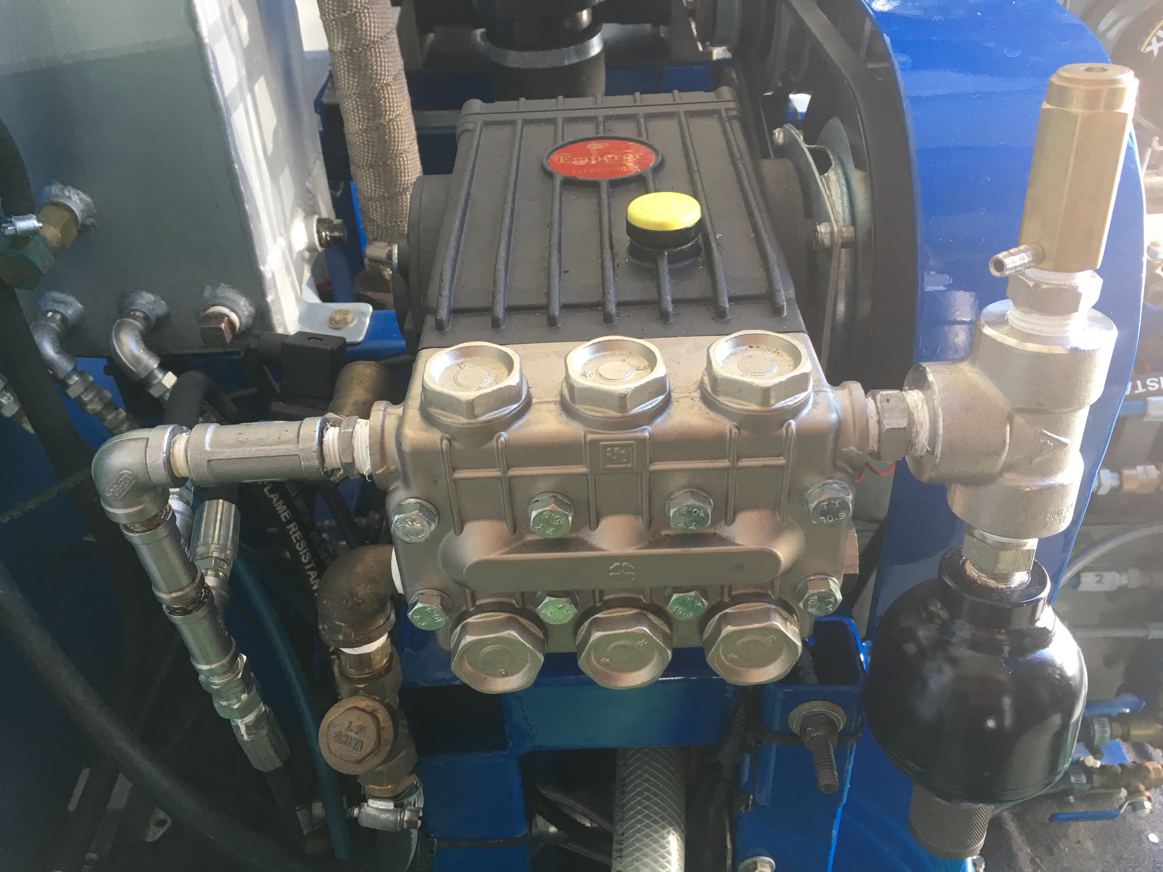

Hello! Looking for suggestions on what type of chemical injection system to install on my EZ3547. It currently has a pressure washer style chemical injector which I am not fond of. I was thinking of installing a General Pump Pulse Pump for a last step system. Ideas of how to setup would be appreciated. The system does have a water box. I changed out the Dema valve (which controlled water flow into the water box) and electric float switch (inside the water box) to a manual float to simplify the system.
I have also recently upgraded the solution pump to a General Pump Emperor 5 gpm. I also installed a pulsation dampener (from GP) and a pressure relief valve. Thanks

Looks like SS to me. Galvanized is a dirty silver.
