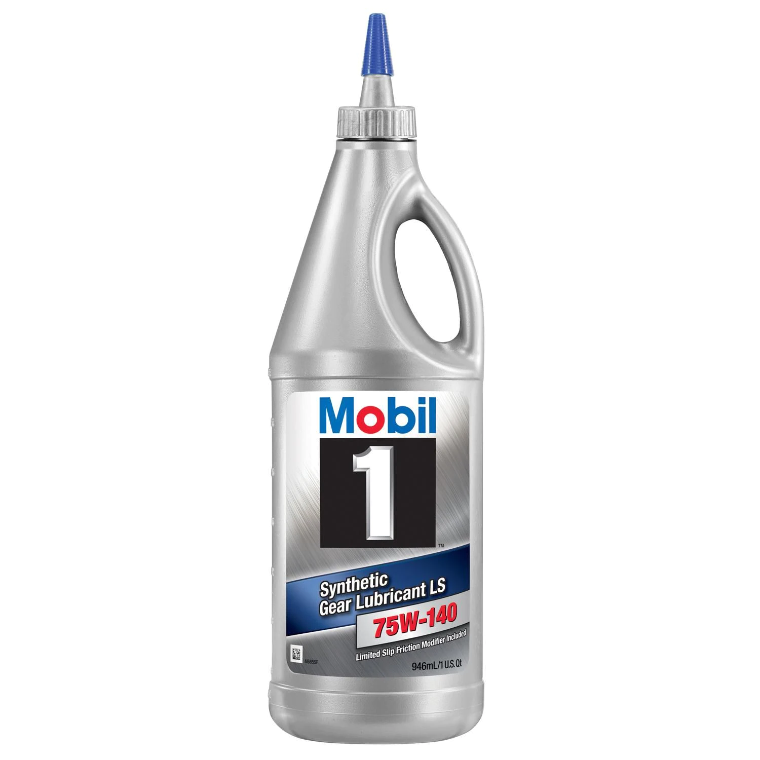

When giving advice i try to lose as much techno mombo jumbo as possible to get the information across and sometimes i dilute it too far. For those techmo geeks this one's for you

According to Dwain's chart, Amsoil Severe Gear SAE250 is too heavy. I would just order some Aeon, but it appears my distributor is closed for the holidays, as is PD Blowers.
I have some Amsoil Severe Gear 75W-90, which is too light.
Will try mixing 250 with 75W-90 for now. Or pick up some quality SAE 90 gear oil.
Thanks, Dwain!

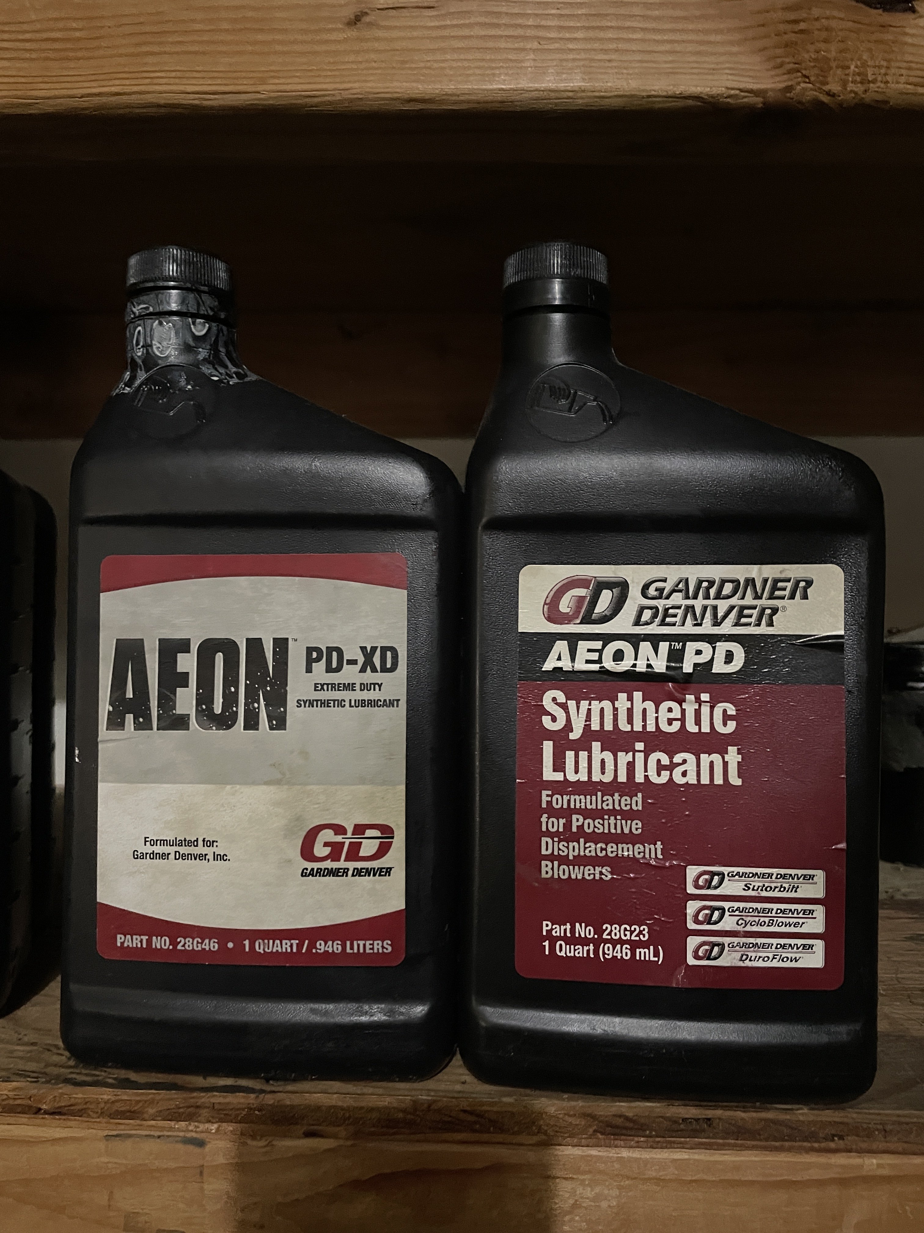

I think now you're just splitting hairs now if you look at the picture of the aeon bottles 1 says gardner Denver which is sutterbuild it's like pump oil , i have a hypro pump but i use cat oil in it instead of hypro oil because i can get cat oil from home depot and id have to special order hypro , it is more important the frequency of service intervals than which brand of blower oil you use when i built frankinstien i retired a 47 blower that was new in1991 and passed down thru 3 machines and has approximately 14,000 hours on it but i changed the oil in it every time i changed the pump oil 500 hour intervals

I think im gunna drop out of this conversation at this point, as for me an ounce of prevention is worth a pound of cure , i put chevron 91 in my shelby and aeon in my blowers,if you run anything else and it works for you great,as for me good gas and oil is really cheap insurance, after all, your only as good as your tool
