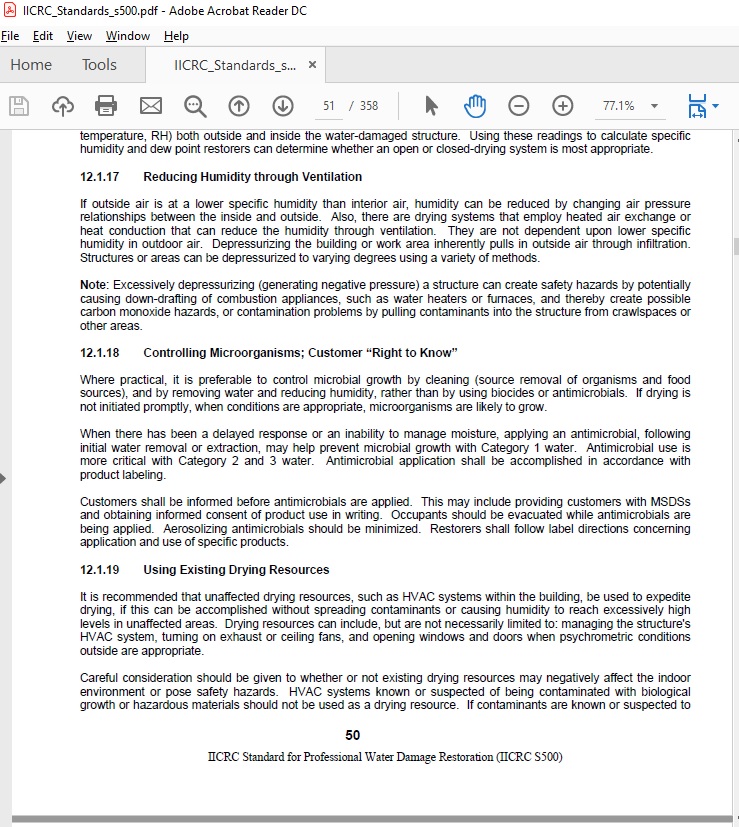

I am aware of the difference between indoor and outdoor humidity. That's why we take readings in both in order to determine open or closed drying on water damage jobs. If I was in Phoenix or Vegas, I would just open the windows and turn on the fans. I can get my rh down to 25% indoors in my shop by using dehumidifiers. That's a lot drier than the humidity outside today. 55%

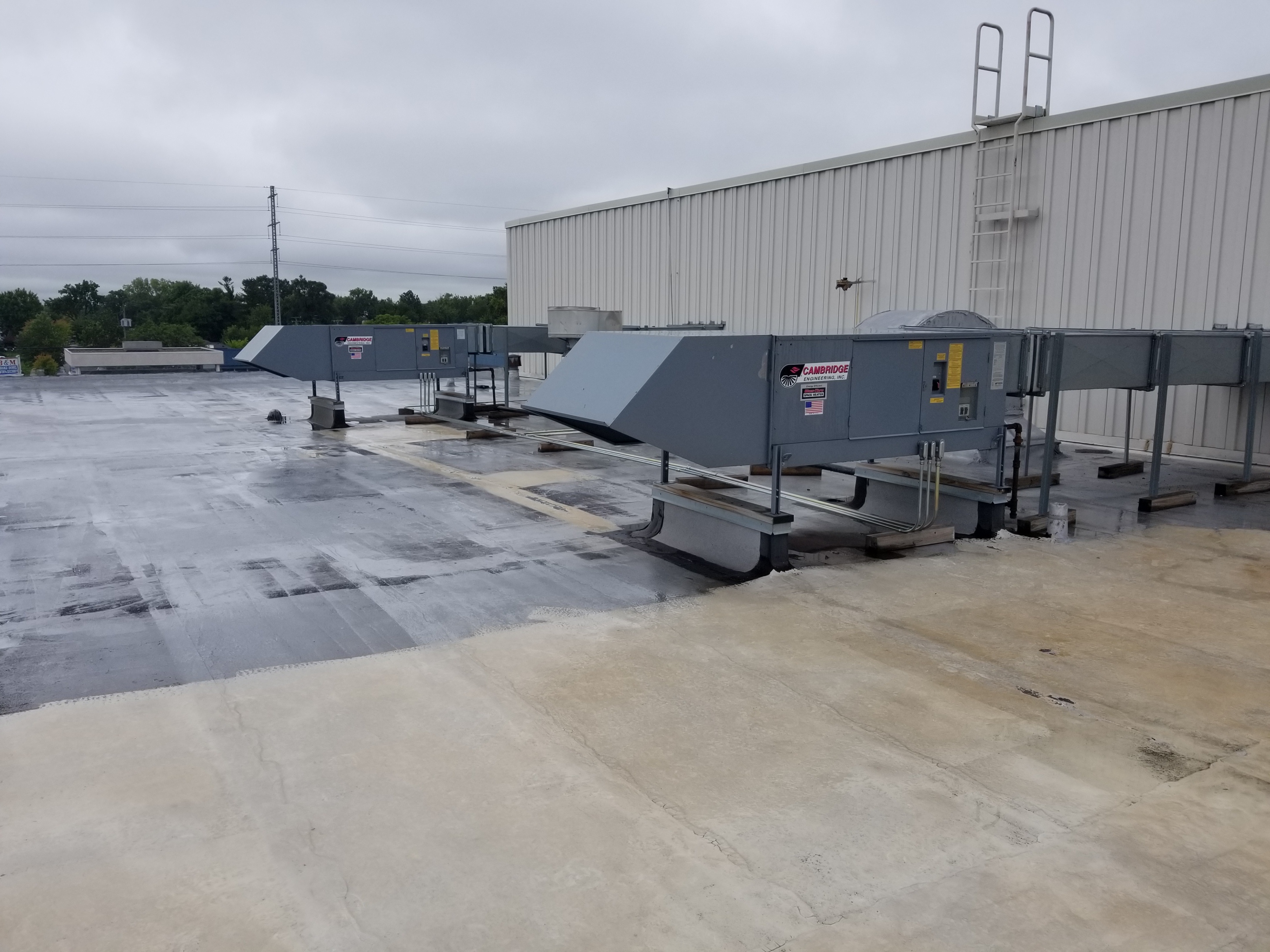

If you get to a larger volume, Tom is the outlet for the in-plant Cambridge heaters, but those require a gas line with a slightly higher than normal gas pressure to run.

I've seen the Cambridge unit. If I owned my shop and wanted to expand, I would consider it. Makes perfect sense. I'm still a rug hack at best.

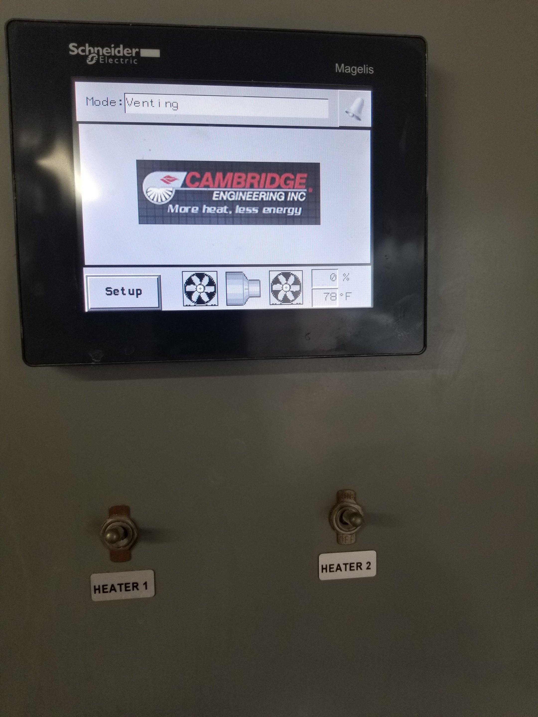

What's the deal with the Cambridge units? I keep hearing people mention it. It's just a heating unit, nothing special about that. Or is it special? Or are we just all dumb carpet cleaners?

It's the combination of heat and ventilation. It provides a continuous supply of warm dry air while exhausting the moist air outside.

So it acts as a Dehu at the same time?
Only in the sense that it removes moist air and replaces it with warm dry air. You have exhaust fans in the dry room pulling out the moist air while the heater is filling it with warm dry air. It's not just a heater, it's an airflow system as well. You end up with continuous warm air circulating around the rugs. They have lots of videos and diagrams on their site and YouTube. They claim that it reduces drying times to aprox 6 hours.

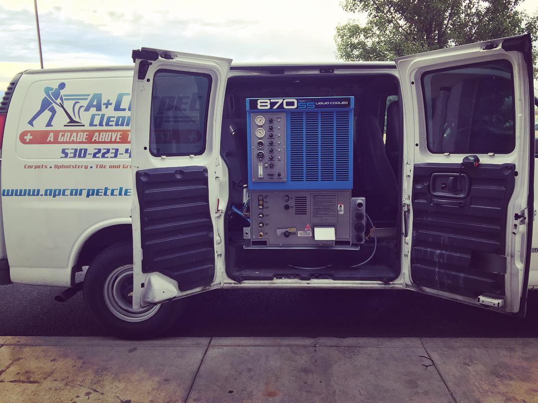

Just throw the 870 in that thing, and you and Macy could travel the country and make money....
Who knows, maybe you’ll become a trend setter...
