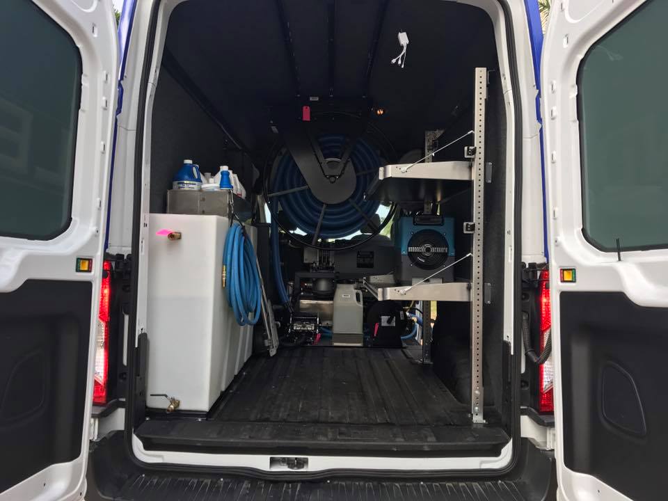

Ceiling mount Prochem reel

Perfect. More space
Mine kisses the roof, with a nice drawer underneath.
I love seeing better use of space in many of these new vans.
I'd much rather have the drawer. I agree with Marty, just looks odd...the reel, not Marty.

I like it

:headscratch: I was expecting to see the solution hose reel on the ceiling !!
I would have thought the vac hose and reel would be too heavy for the roof or mounting bolts.:eekk:
with all the bumps and pot holes in SF streets I don't think this would work for us.:dejection:

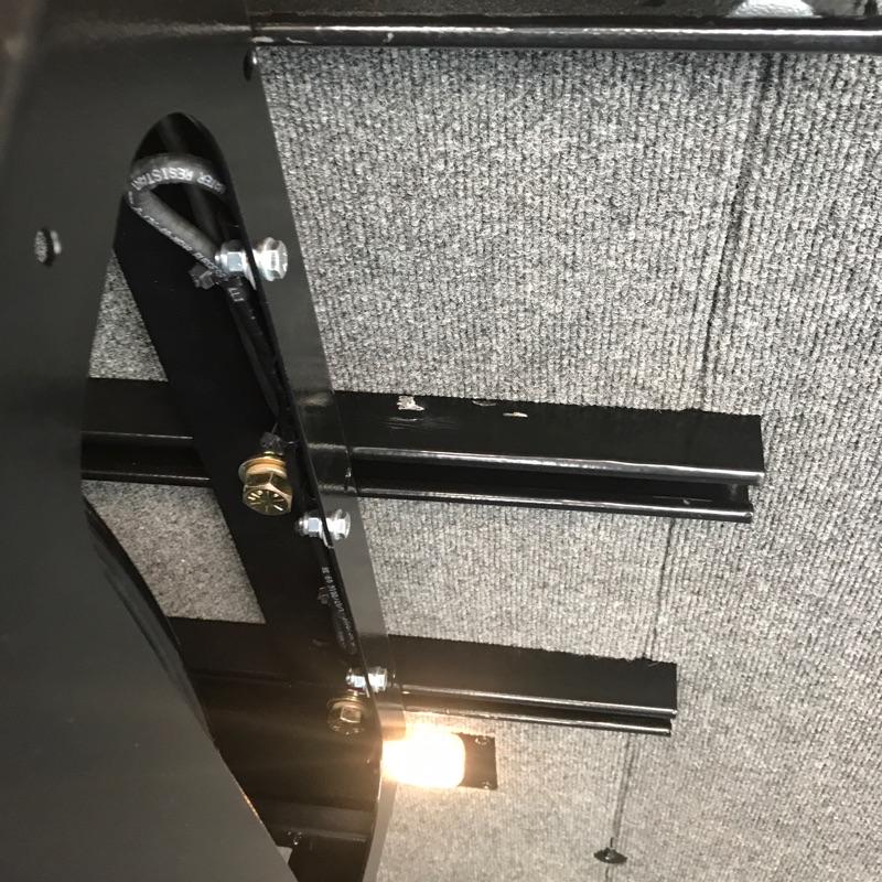

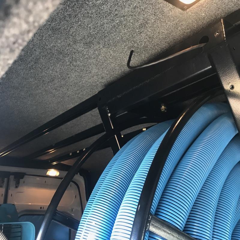

I like it...looks like a good space saver......but on the flip side...that seems like a lot of weight to be hanging off the top with no vertical supports to help pick up the weight...looks like they have the channel running across the ribs on the roof.....but all that reel and hose weight is concentrated in on spot...stop and starting...it is going to flex from front to rear...and all the jolting around...unless it is seriously braced and we just can't see it..I would be afraid that in time the roof would start to sag.........
14,646
I've never seen this specific reel up close, but the majority of them are wobbly, due to how thin the skeleton is. If that reel is the same way, just think about how that thing wobbles and sways 1/2 inch constantly back and forth. It looks good, and is using wasted space very well. I'm just concerned about how long it'll last like that with the way we drive our vehicles

Sapphire/Prochem reels are the real deal. I had one in my Judson set up. Very stout.

Looks very secure. I always wonder if the space you save is worth the effort of flipping it.
I've thought about it when putting a unit together. The last one we just went with the extra tall and narrow reel to get maximum use of the space. I also thought about the box beneath and mounting the reel on top of the box like Lee did.
In the end all but the the one with the extra tall reel are conventional installs.

Had 10" of dead space over the reel, so when we took it out to convert to electric I built the box to fit. To install had to suspend the reel and slide the box under it.
Had to credit Jim Bethel and his dad.
