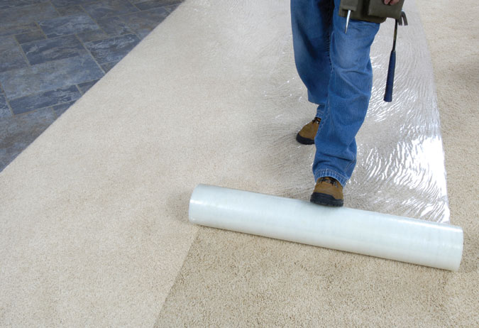

Carpet mask is plastic sheeting that is sticky on one side that can be laid down to protect any flat surface. Once it’s applied it doesn’t move when walked on, thus preventing most slips and falls all the while protecting the floor. Carpet mask should be used for short-term situations perhaps a few days or a week.

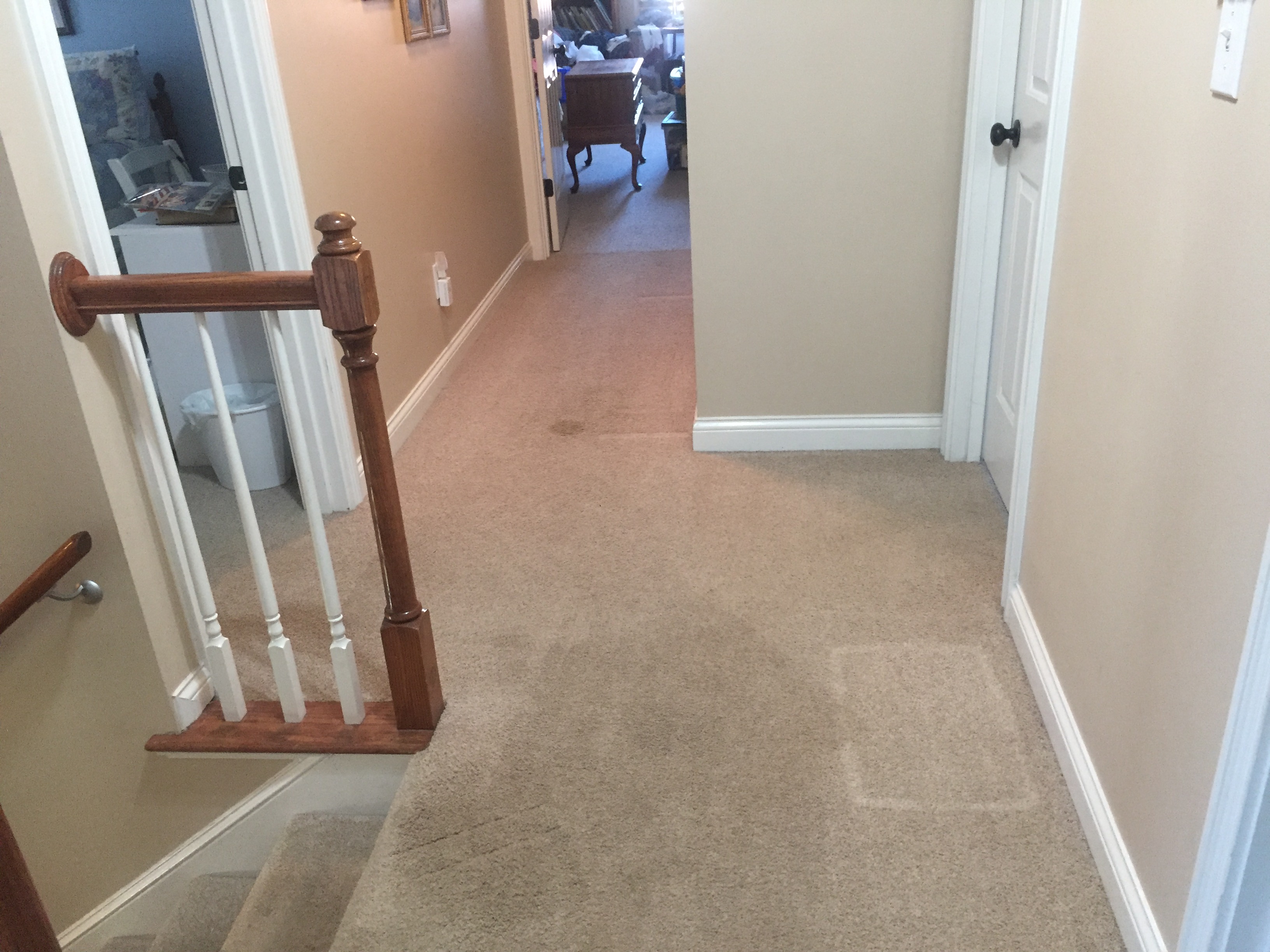

Fast forward, about two weeks later, the carpet had noticeable discoloration. The carpet mask left a residue that you couldn’t see or feel to the touch. The Estate Manager called his favorite cleaner and had the carpet cleaned like they always do and the carpet seemed to be back to normal… for a couple of weeks. The flooring was even more soiled looking than before. Why?
The cleaner had used a portable cleaning machine like many companies do in large homes. It is easier in an estate to not use a “truck mounted” steam cleaner that requires a bunch of hoses to be brought in and ran though large areas of the home. The problem is sometimes the steam or water used in this type of cleaning isn’t powerful enough or hot enough to break down the bond from the glue left behind on the carpet. But that may not be the right method to clean up this problem. What is the right answer to this predicament? First we need to assess the type of carpet we are dealing with. The carpet in our story is a natural fiber woven carpet. Woven carpet is prone to shrinkage so it’s important not to get it to wet and to dry as quickly as possible.

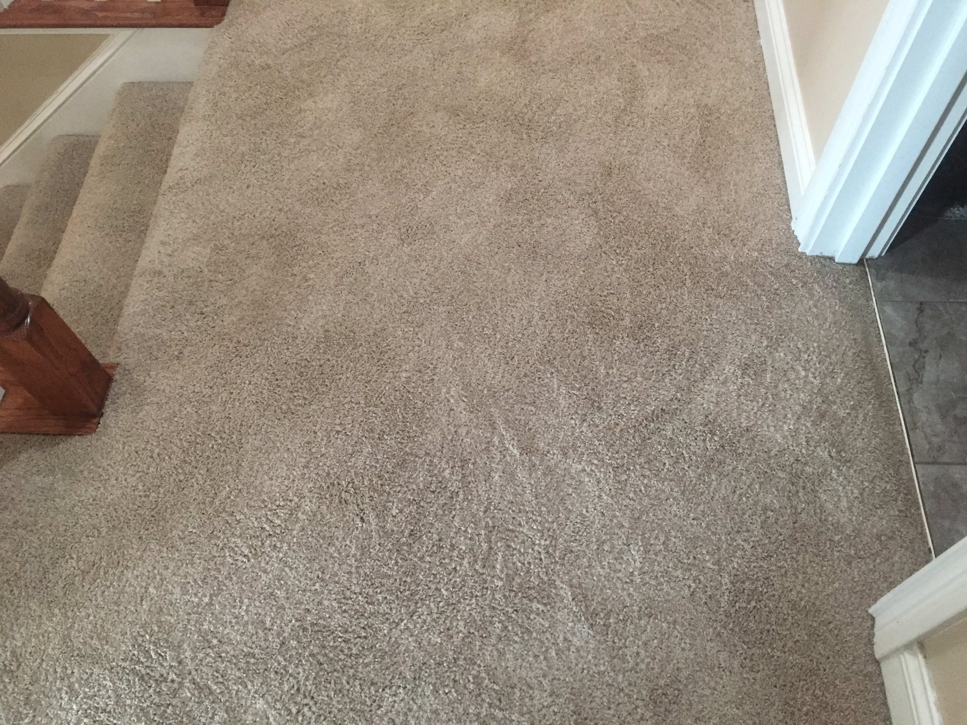

Image courtesy of chetscleaning.com
Let’s look at basic cleaning principles using a very simple example from everyday life. When we wash our hair we are “wet cleaning” it. First we get the hair wet usually with hot water (heat), run our hands through it a few times (agitation). Then use some shampoo (solution) and scrub that in (agitation) and let it sit for a few minutes (time). The last step might be the most important one, we always, always rinse out the shampoo until it is completely gone so there is no residue left behind when the hair is dry. If there is residue the hair will get dirtier quicker.

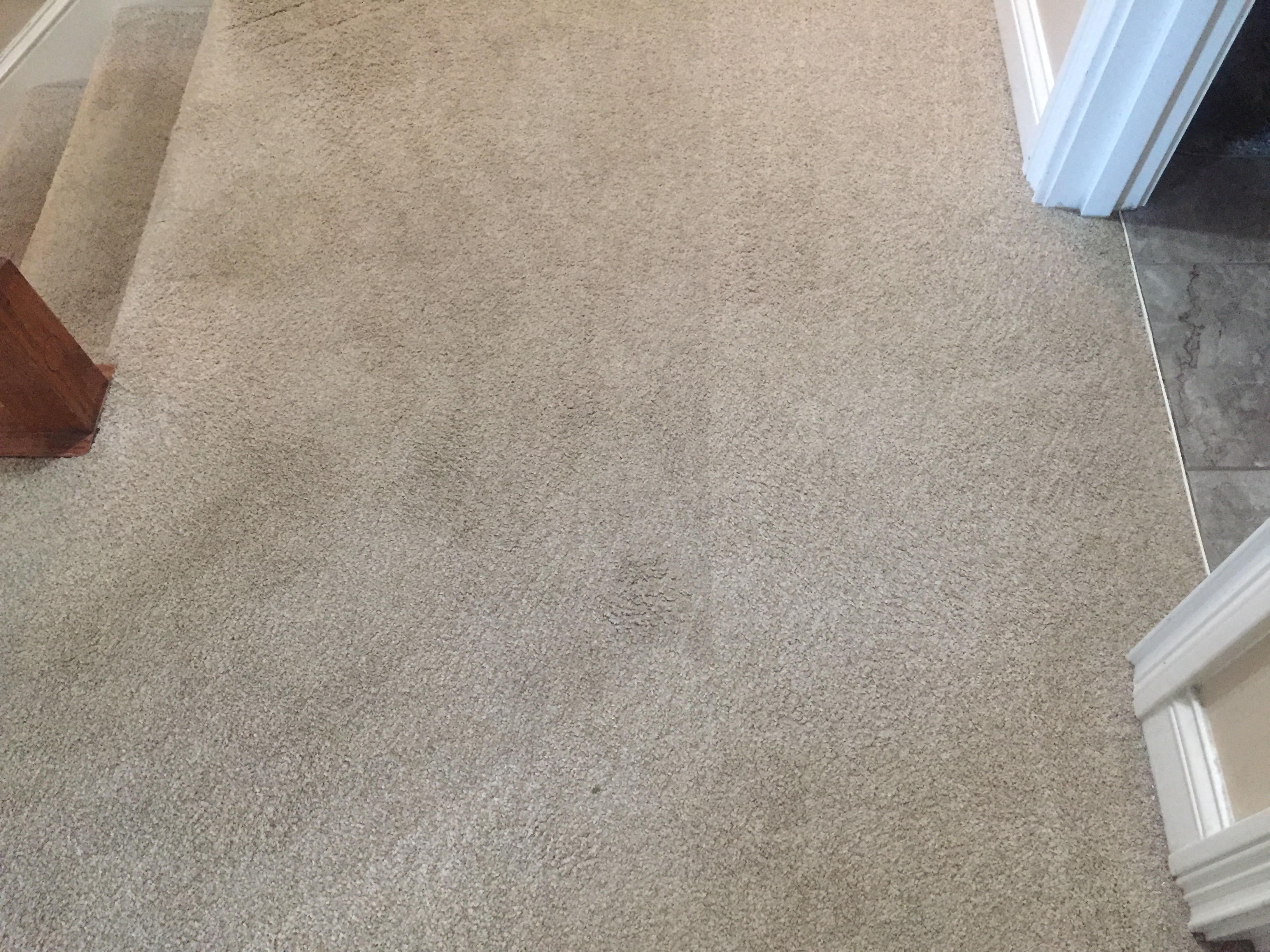

We’ve discovered glue residue left behind from the carpet mask caused the carpet to attract dirt faster even though it was cleaned using a safe process not to damage the carpet. However, it probably wasn’t cleaned at a hot enough temperature to release the glue from the carpet and wasn’t rinsed thoroughly. Most cleaning companies use a cleaning solution that doesn’t need to be rinsed when steam cleaning, however it does not remove 100% percent of the cleaning solution, which may leave behind a slight residue. So now we have residue from the glue and residue from the cleaning solution. What now?

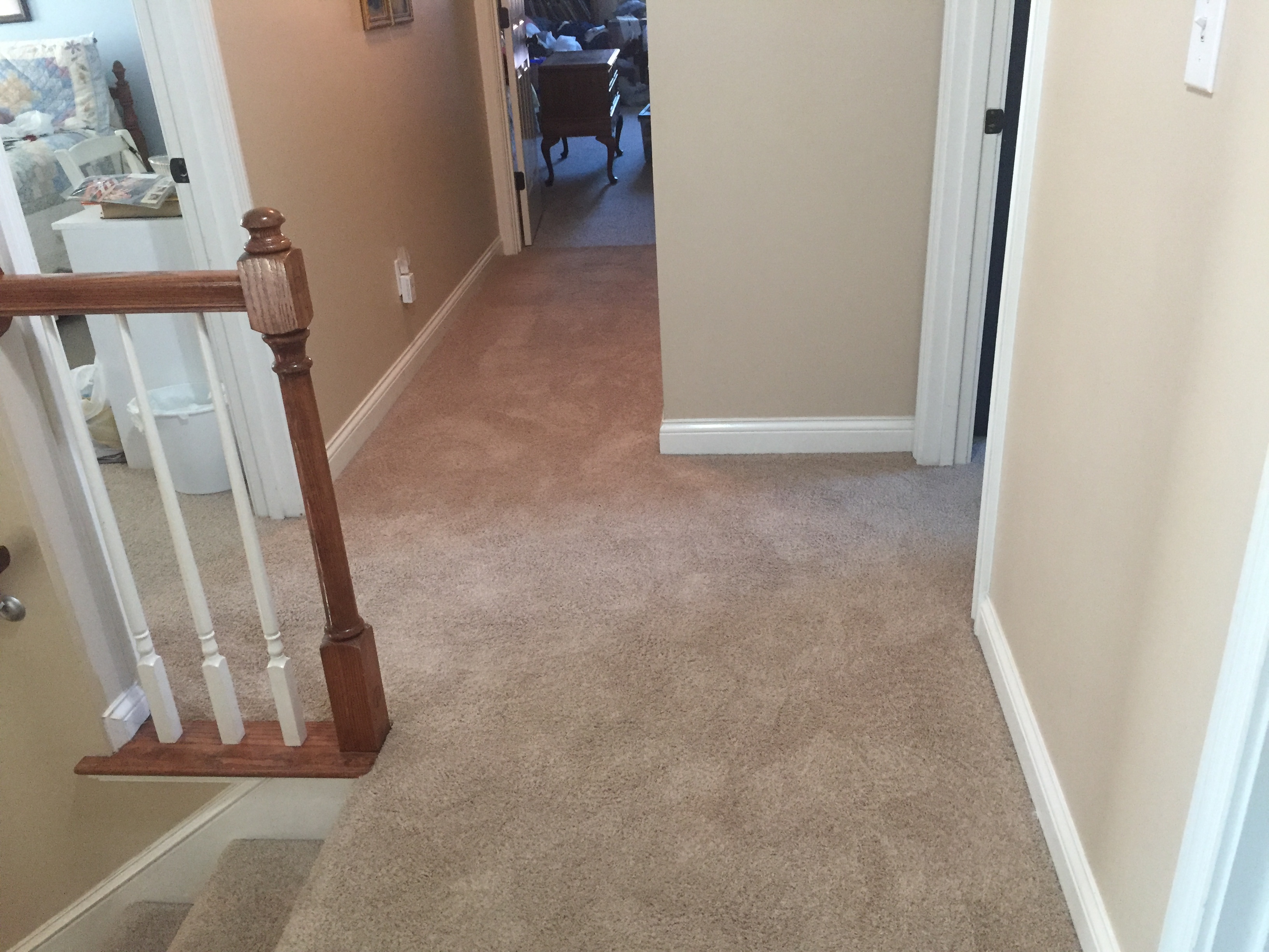

The Solution! A multi-step process needs to be applied when removing carpet mask residue that has been left down for a long period of time on carpeting. A combination of dry cleaning the carpet to remove the glue residue most likely will be done first followed up by a wet cleaning to rinse and remove the soil. It should be noted that a multi-step process may not remove all the residue or soil on the first cleaning and may need to have a light cleaning touch up a few days or weeks after the initial cleaning to be sure it is completely removed.
