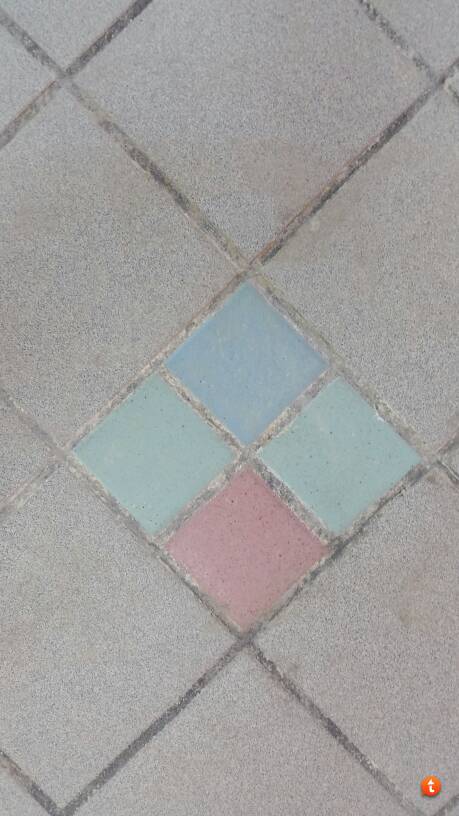

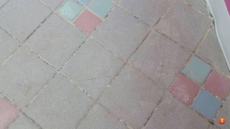

This tile had carpet glued down over the tile and the new tenant ripped up the carpet and wants to use the tile. She wants to know if I can bring back close to new.
Is there any relatively easy way to get the glue off the grout or is this a hands and knees with steel brush type of job. There is a total of about 900 sf but not all of it has the glue issue.

It's a hands and knees job with acetone and wire brushes or paint stripper and grout brushes. Have fun
