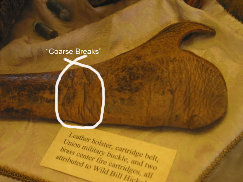

Can this be restored ?
H
harryhides
Wild Bill Hickok's leather gun hoslter circa 1876.
Whaddya think ?

If one can make a rock hard, ultra stiff, weather worn saddle much more supple, WHY NOT :?:
Ooroo :roll:
R
Roger Koh
IMO “Contemporary Restoration” does not apply in this case!
Rather it is a “Museum Conservation” undertaking!
Priority is still to maintain its aesthetic…retaining the age that tells its history…that qualifies a place for display only…
“Restoration” so to speak is only limited to restoring the “leather structure integrity”…
What do you think?

Obviously as a museum piece it's "look" should not be altered. However, if it were simply an old non-museum piece I believe that it could be made to look a lot more like it was when new.
I wonder if a coat or two of Fat Liquor on it;s inside surface would help to preserve it.
R
Roger Koh
Re: How to Restore & Preserve a Vegetable-Tanned Leather.
These “coarse breaks” (circled in white) are signs of leather “structure collapsed” (internal fiber damages) that need to be rectified.
The “internal leather fibrils” need to be preconditioned (rehydrated, swelled, separated, (+) ionic charged for even (-) anionic fatliquor distribution with good lasting polar hydrogen bonding).
And the “external surface tension” needs preconditioning (to minimized rapid physical absorption, to reduce patchiness, to reduce darkening effect) prior to effective fatliquoring.
So, just coating the surface alone will not be holistic enough to restore (internally) and preserve (externally).
What do you think?

"Is stuff like this ever treated under a higher atmospheric pressure to drive in ingredients?"
A “Hyperbaric Chamber” or “Pressurize Chamber” perhaps might work to drive the tanning oils and other leather conditioner be it polymer, oil or wax into the leather structure.
Pressurized, so as to stuff the oil in, may also saturate the inter fibrillary spaces with permeable negativity.
So, what happen when it is taken out of this “higher atmospheric pressure chamber” when the job is done?
1. I believe any oil, wax, polymer or conditioner that is stuff in will leak out too (with a lower atmospheric pressure now).
2. And most oil, wax and conditioners usually darken the leather that will kill the original aesthetic too.
3. Whether it will regain its tensile strength with suppleness (flexing without coarse break) is yet to be tested.
"Or as in some medicine it is driven in by Electrophoresis - a charging of the medication".
This “Electrophoresis” charging application has only two distinct locations, how do we multiply these charges to be evenly distributed to the entire leather structure is yet to be comprehended.
The leather may appear with darker spots where the current is stronger at the poles.
"Why not the same thing with this "tissue"".
The same thing you refer to is the “same polar universal principle” just like poles of magnet - like poles repel, unlike poles attract.
This (+) and (-) principles are also applied to “static electricity spray powder coating” - as in an advancement over zinc-plating and chromium plating.
We have a proven “breakthrough fatliquoring technology” at hand that does the work - affordable and simple to use - just spray soak with fun!
So fatliquoring, after preconditioning, is an advanced technology breakthrough of applied chemistry relying on the micro ionic (+) and (-), without the any high tech costly equipment.
Tannery fatliquoring technology at present still relies on a hot water system of up to 125ºF for effective fatliquoring.
Heat is utilized to stabilize the fatliquor emulsion to keep the oils and water from separating.
And to facilitate the opening of the leather pores before the oil and water separates.
fatliquor5.0™ has been frozen and defrost, yet maintaining its stable micro-emulsion characteristic just like fresh milk.
fatliquor5.0™ pH value ± 5.0 is an anionic fatliquor of choice for all acidic (pH 3-5) healthy leathers.
However to ensure an effective long lasting polar hydrogen bonding we need to precondition (acidify) the protein fibers below the fiber isoelectric point below pH 4 (Vegetable-Tanned) in this case to cationic (+) with a pH 3.3 relaxer (relaxer3.3™).
This is not just “applied chemistry” it will also work before your eyes, when you try it!
Try experimenting with a piece of old vegetable-tanned leathers (similar to any leather soles).
After cleaning it with a pH 3.8 (clean3.8™) cleaner and acidifier rinse with a pH 3.0 (rinse3.0™) and rehydrate with relaxer3.3™ (pH 3.3).
Put it into a zip log bag and soak with this fatliquor5.0™.
At first you see the milky fatliquor, leave it to the next day you will see the fatliquor clearer just like water.
Where does the charged anionic (-) fats and oils that were encased within the water go to?
As a result of water-dipole movement it has resulted in a hydrogen bonding with the protein fibers.
All theory claimed has to be proven.
That applied science is a proven fact!
And applied art is a proven practice!
See how interesting leather can be!
We begin to talk with the same level as any “dermatologists”.
