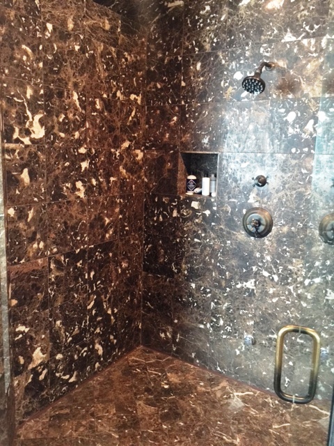

You guys wanted proof here ya go. nearly 2 years later

Its a good thing your not an Prosecutor, I would expect a lot more evidence presented if I was trying to prove something.

You guys were claiming the shower was damaged by the cal clean. There it is 2 years later and nothing else has been done to it since the initial cleaning, sealing and protecting with cal block. This is a hotel shower. If cal clean had damaged it as you believe Jim then enhancer would never ever have hid it for more then a week at most let alone 2 years in a HOTEL. Also notice not build up that is normally the case in these hotel showers.

Singling me out is fine but I wasn't the first to say it was etched & certainly not the only one, I did find fault in your presentation so you could call me out on that if your happy with how the product was introduced here.

Jim not calling you out. Not sure why the defensiveness. The written word and the "attacking nature" of message boards might have something to do with it but I was referring to your remarks and questions. I would hate for you to miss out on using a great product because of how something is interpreted online :)

the pictures as is do not prove anything.
John, take me up on my previous offer and I will try some

This is the dumbest ******* thing I have ever heard. Do you know what calcite based stones are? Marble, Limestone, Travertine, some slates. How would something magically erode and remove calcium on top of a calcium surface, but not damage the calcium surface?
That sales rep is full of shit and shouldn't be let out in public without a helmet. Also, those steam showers damage the marble, they straight up etch the shit out of the marble to the point you have to refinish them with diamonds or sandpaper. You're lying to customers and they aren't getting what they paid for.
It's non-acidic, it's only pH2 because it attacks calcium? How high is this guy? It attacks calcium because it's acidic. It etches marble because it's acidic. Then you hide it with some shitty color enhancer to make it look okay. Anyone that acknowledges their product has a 2pH and claims it's non-acidic is billowing clouds of smoke up your ass.
Look at the reflections on the pipe wall, you can see the etch marks everywhere.
I'm sorry to be so rude, but there is no diplomatic way to convey how stupid this sounds.

I've been intrigued with this product since you introduced it to the board. I, too, am somewhat skeptical. However, I would like to see more in depth pictures of that shower. Perhaps a video? Could you take closer pictures of the wall? Can you show video of the process and the results of Calblock? Many questions. A picture is worth 1000 words.

Either way it's safe to say that anything listed on or around 2 on the pH scale will obliterate the surface of a calcite based stone. Essentially what happened in the job that was posted was they went to a steam shower that was heavily etched and had mineral buildup. They washed it down with acid to etch it even further and even it out. Then covered it up with the sealer. So instead of the customer having their shower restored to original condition or better, it was damaged in an even, consistent manner, then hidden.

That is a great analogy, but I don't think it applies specifically to something like the surface of stone or tile. At least not in this particular case. The "marble" in the picture is a dolomitic limestone. It's much harder than a lot of traditional marbles and doesn't react quite as sensitively as something like Carrara or Crema Marfil, but it still reacts, and will still become damaged on contact, even with a highly diluted acid. It's a metamorphic stone that started off as a pure calcite, compressed skeletons of little crustaceans over hundreds of millions of years. It changed and evolved, but not into something opposite of what it once was. Granite and sandstone on the other hand, are silica based and won't react to most acids like that. Granite won't be damaged on contact with muriatic, but let it sit long enough and it will actually damage it beyond repair. It usually happens when something is placed on top, preventing air flow or drying.

That does make sense to me and I appreciate the explanation. However, in this particular instance, the chemical is designed to remove something from a surface made of something very similar. There is calcium buildup on top of the surface of a calcium based stone. That's like using a cleaner designed to remove a water based dye from fabric, and using it to remove red water based dye from a fabric that has been colored with blue water based dye. What are the chances of removing the red without harming the blue? I know absolutely nothing about fabric, so maybe I am just talking out of my ass, but I do know stone, and I know that particular stone in the picture.
Maybe I'm wrong and I'm just being an asshole. if that's the case, I'll own it. I just don't see how what was said by the salesman is remotely possible. Even at a high dilution, something with pH of 2 is still going to pose a serious risk to polished marble. We use 20:1 on honed limestone for cleaning copper oxidation, then re-hone it because it changes the surface

Also this:
Is EXACTLY what happens when you spray acid on marble.

As I said, etching can still occur. Especially if there is little efflorescence to create a neutralizing shift, or if repeated application is performed. The key is how much.
Slight etching will indeed "whiten" the appearance of a dark surface, as it is a total loss of gloss. If the etching is slight enough, it may be easily remedied by either a high-grit light polish, or a surface treatment "sealer" with appropriate capability to "level and gloss", this very specific type of haze.
