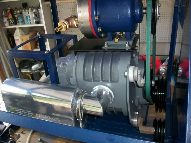

OK...we'll forget dumbOdin....
i'm starting my econOgenie build... i had the blower and pump in for a while..
but now comes the plumbing....and water box wit the emusifier draw
Prolly gonna do the instrument panel... NEXT

BAWB, your Genie is high on my list; I am debating transfering my existing HM 4.7 to a new vehicle with some modifications so that it can be belt driven, or buying one of your Genies. Problem is I am looking at purchasing a 2005-06 Chevy Express 2500. Is it possible to mount the Driveshaft you have in one of these vehicles and still keep A/C?
BTW, is that sharp 90 elbow at the blower a good idea for cfm? How about a smoother turn?
Since the under driven blower only produces 1/2 the potential cfm anyway, any loss due to the sharp 90 restriction would be negligible. If you were forcing maximum CFM through that bend it would be much more of a issue.
