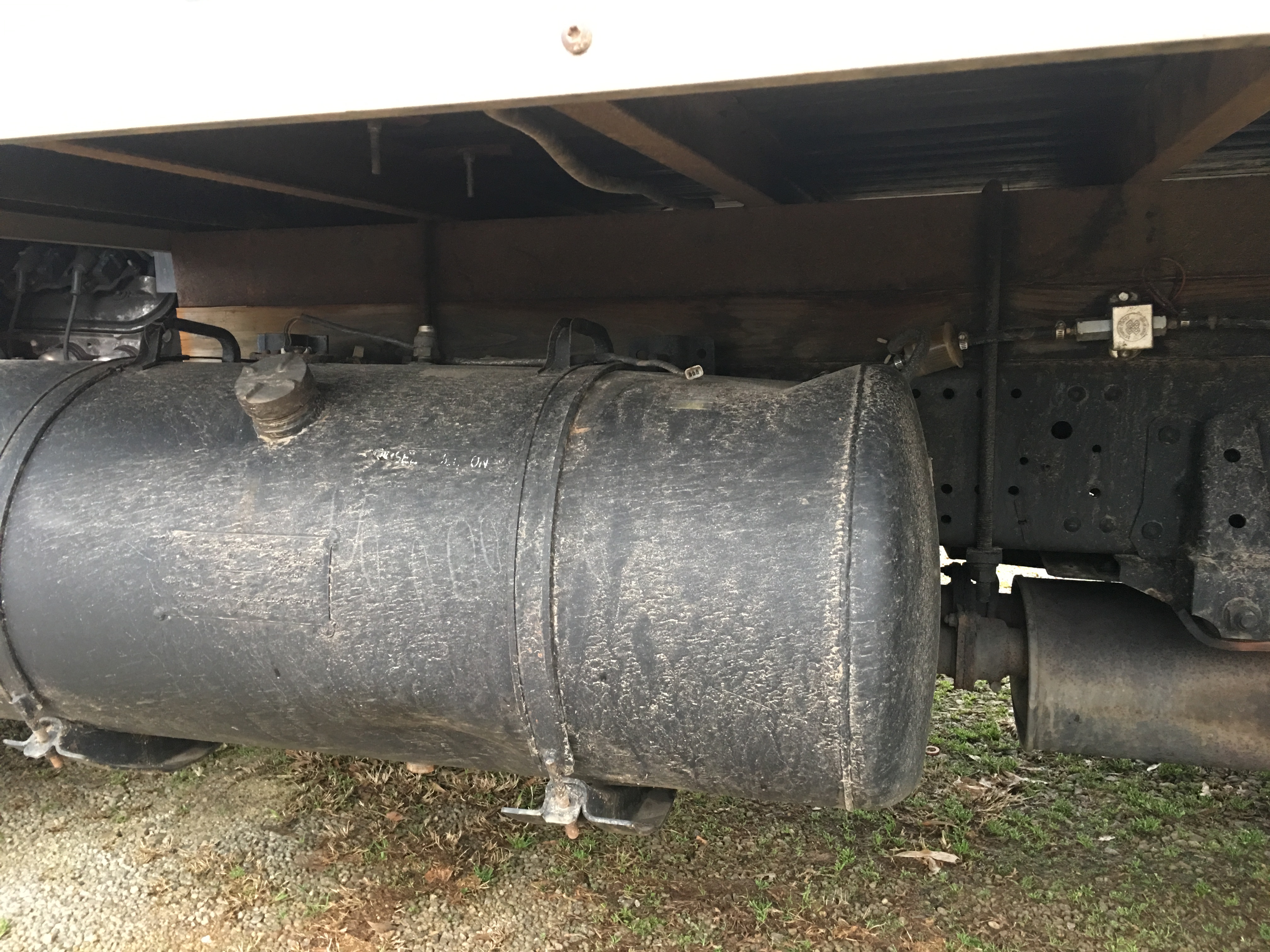

If you’re pulling it out, I’d consider purchasing a saddle gas tank for the tm only. I did that with my box, and I love not worrying about running out of gas

Send him some pics of your setup Matt. You did a nice job on yours.
14,646
I’ll post a few pics of the tank tomirrow

I feel that's the best benefit to having a box truck vs a van, because you have all that extra space under the box to install extras.
Another benefit is where the battery is located. If your Ford has a similar battery setup like my cab over, then the battery should be on a tray under the box. There is space for another battery to be installed. I put my truck mount's battery on that tray also. The benefit of that is, if one battery dies, it's very easy to jump the other battery off, because they're just inches away from each other.
