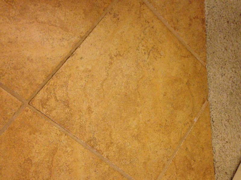

Installed a piece of tackles and tucked the carpet down along this tile in a closet.
Restretched a couple rooms cleaned 2 rooms hall closet and steps $228ish.
4 days later I get a call. "I think you broke my tile."
It was fine for 15 years and you did some work in there now it's broke.
It wasn't broke when I left, he acknowledged that, but still feels we did something to cause it.
I know what happened, I moved a heavy peice of furniture out of the master bedroom and left it in the bathroom.
The probably tried moving it back and cracked the tile.
I mean I hammered along the edge near the tile if you've ever chipped or cracked a tile you know it doesn't just break in the middle.
Something was dropped on it that's why it's chipped and popping up opposite where I worked.
11,570
The gentleman walked in there said it looked great when we were done, if I would've done that I would have saw it.
I was on my hands and knees using a staple gun on that edge, 4 days later I get the call.

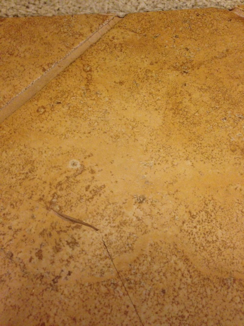

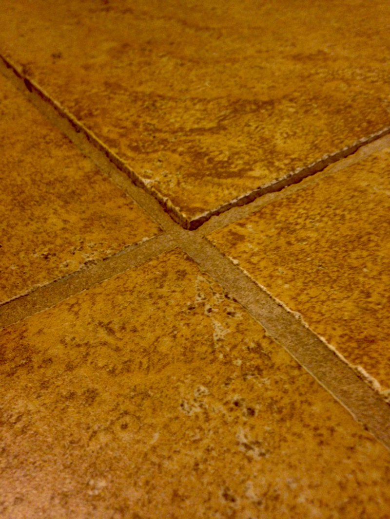

If this was cause by something falling on it, then it's because there is not a proper bond underneath. The closeup of the corner of the tile looks lifted, like it was raised over time from settling of the house. The grout is cracked immediately adjacent to the tile. So you could have caused it, but ultimately the real problem is likely the install.

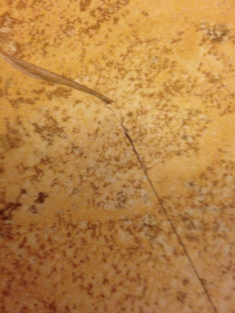

This tile had to have moved for it to break like that. When you drop something on a tile that has a solid bond, it doesn't chip like that, it will leave a roundish divot, not a wedge shaped void. Also, where the crack is very thin, there are very VERY tiny chips along the edge of it. That is from the tile buckling inwards and the edges of the crack rubbing against each other. It only does this if the tile has enough give, or space under it to move that much.
They could have also very well caused this after you left without knowing it. Usually, when you break a tile like this, the sound is very noticeable.
