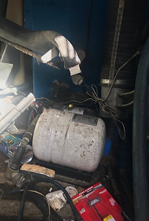

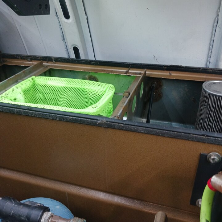

If there was a harder way i think you found it i just use the hose blow the debris off and to and wash um off finish bygoing inside and bloweni out . I have cylinder style filters but i can't imagine the flate ones any different
View attachment 131179 View attachment 131180

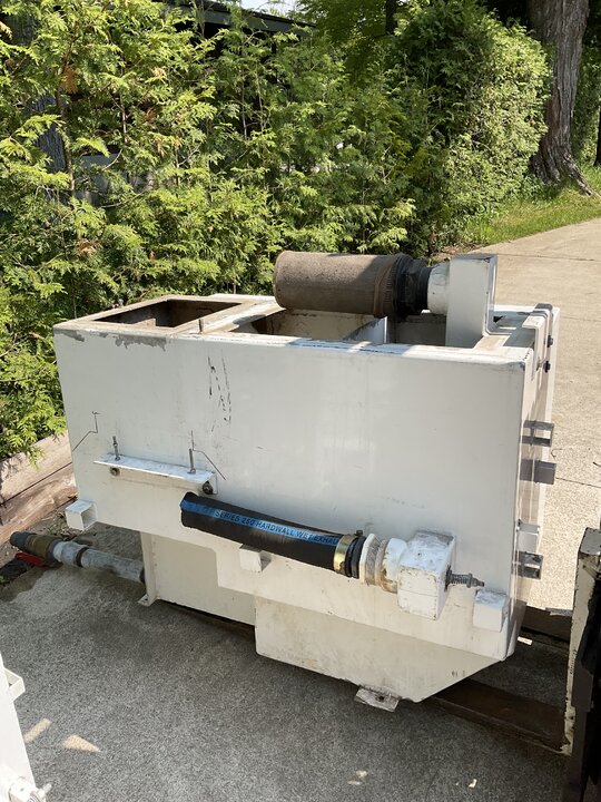

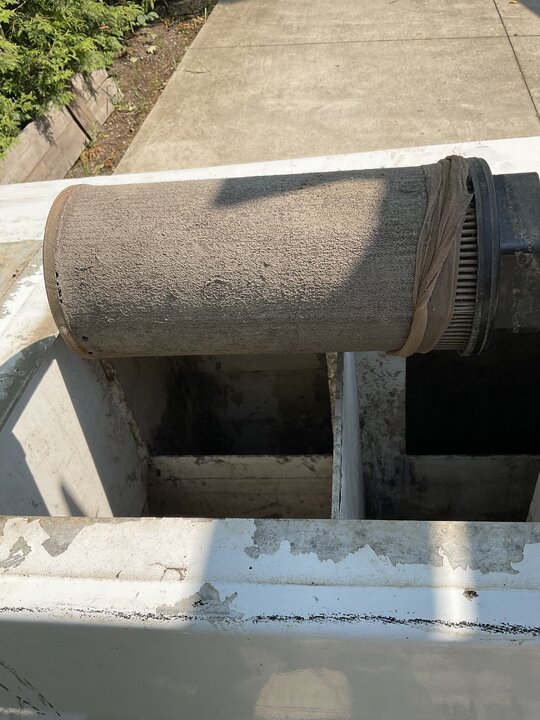

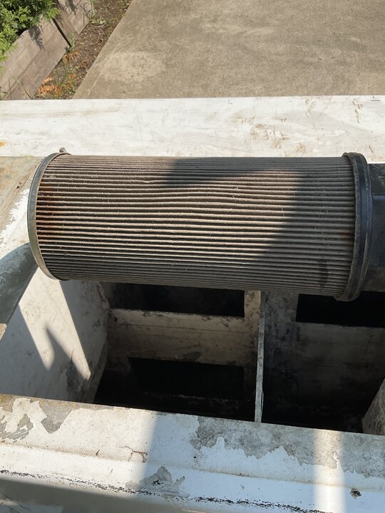

I run a kneehigh nylon stocking over my filters, but as you can see debris still gets into the ss mesh
