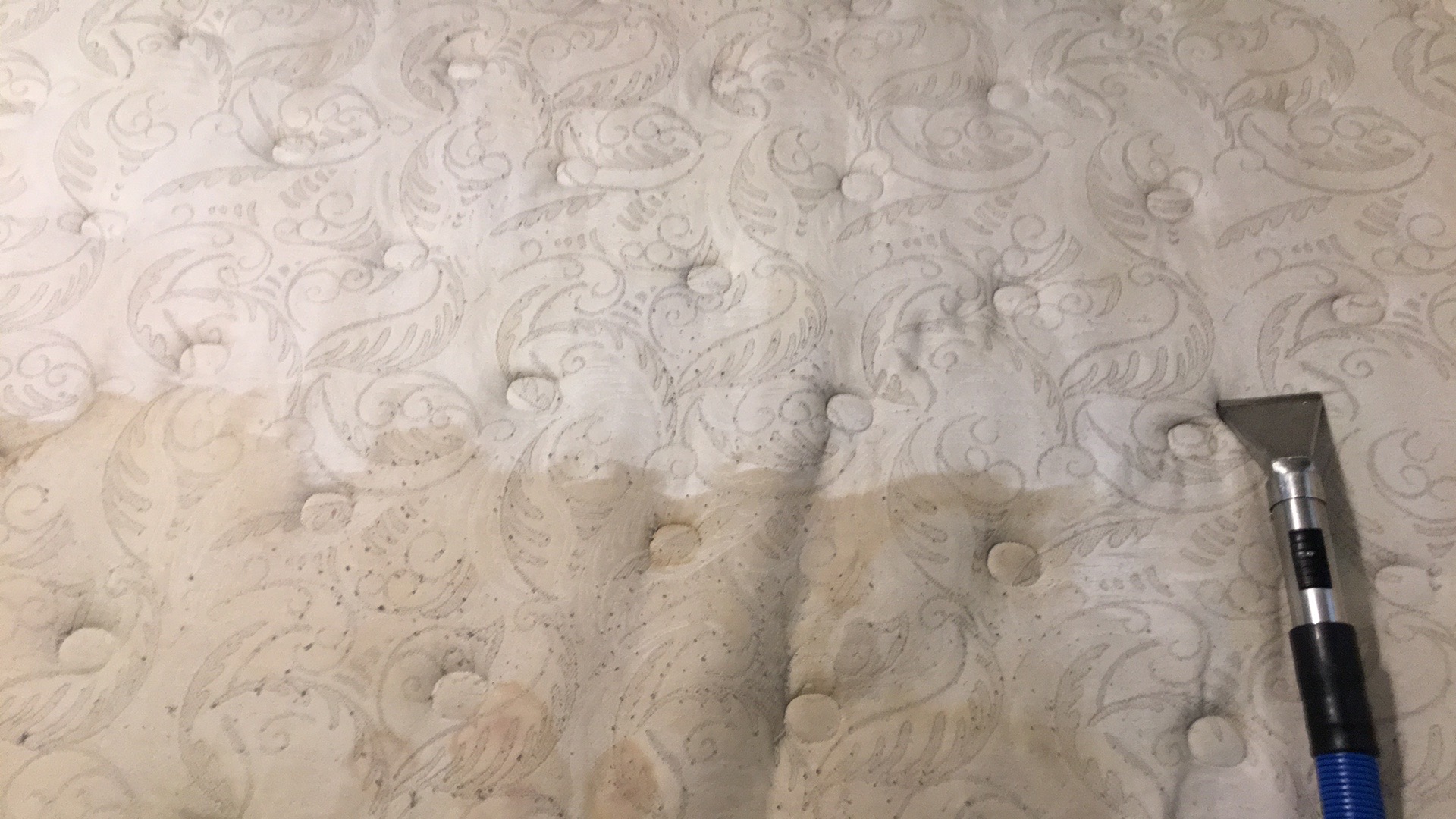

I've gotten a few calls lately in regards to cleaning mattresses,
I have never tried it, any quick schooling I can get?
My only concern is if a human or pet urinates and it gets down deeper into the foam.
I once had a customer store a mattress in a storage unit and mice got in, pissed and shit all on one side, I turned it down.
Thanks
14,646
With urine, I just do a HWE with uph tool first
Then I treat the entire mattress with uph chem
Then HWE again to flush it ou
But with today’s mattresses, check for a zipper underneath. If there is one, turn the job down and tell them to just throw the cover in the washing machine

We always stress mattress cleaning is more of an esthetic thing rather then a solution to an odor issue. I can almost always get them looking new again but smelling clean again is another thing. We wont turn them down but always inform the customer up front its more of a band-aid to add life rather then them expecting a new mattress for 150 cleaning charge. But lets be honest its easyyyy money!

Upholstery tool, stair wand, regular wand, whatever works right.....? We've done mattress cleanings more for vacation rentals.. The most important thing to ask is why are they having it cleaned.. If urine in 1 spot as an accident that's fine, if its multiple we turn it down.. Most just want peace of mind it's cleaned.. Steri-Fab to disinfect, then have at it, a upholstery tool with a controlled spray is miles ahead of a regular tool that oversprays everywhere.. Hydrokenitic, Sapphire Scientific upholstery tool works well..
Most times your only cleaning 1 side because your unable to flip the mattress..

Had one last week pee & poo . I used Carpet Designs dry vacum then sprayed with pump up had to do it 3 times used upholstery tool and had great results.
