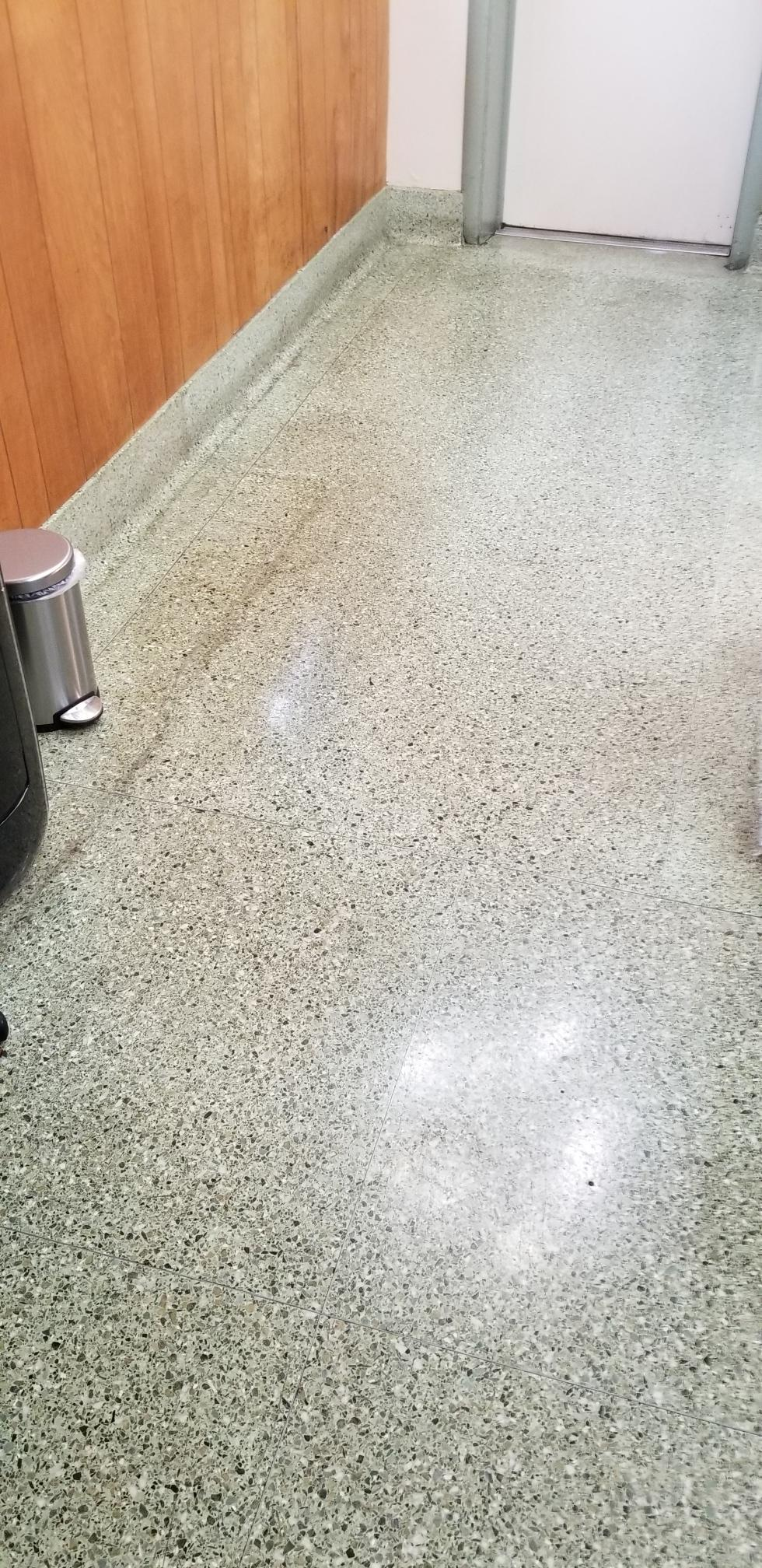

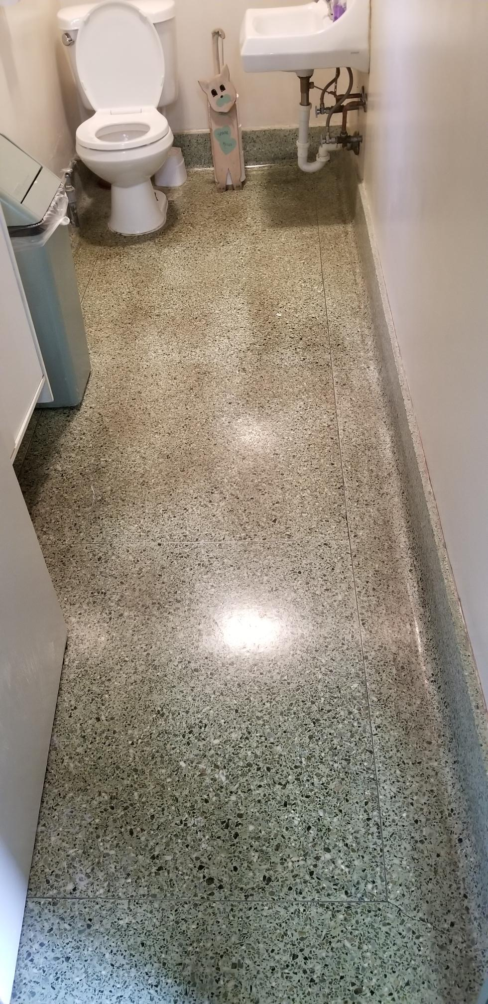

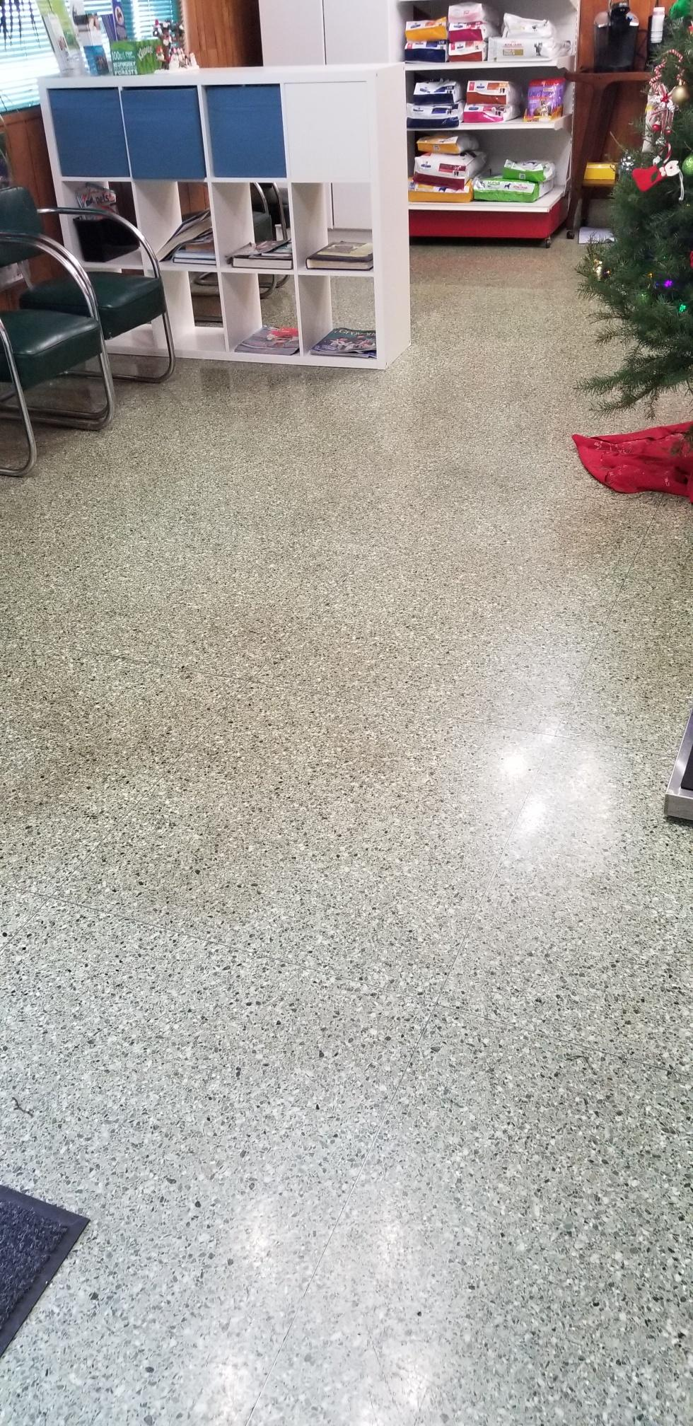

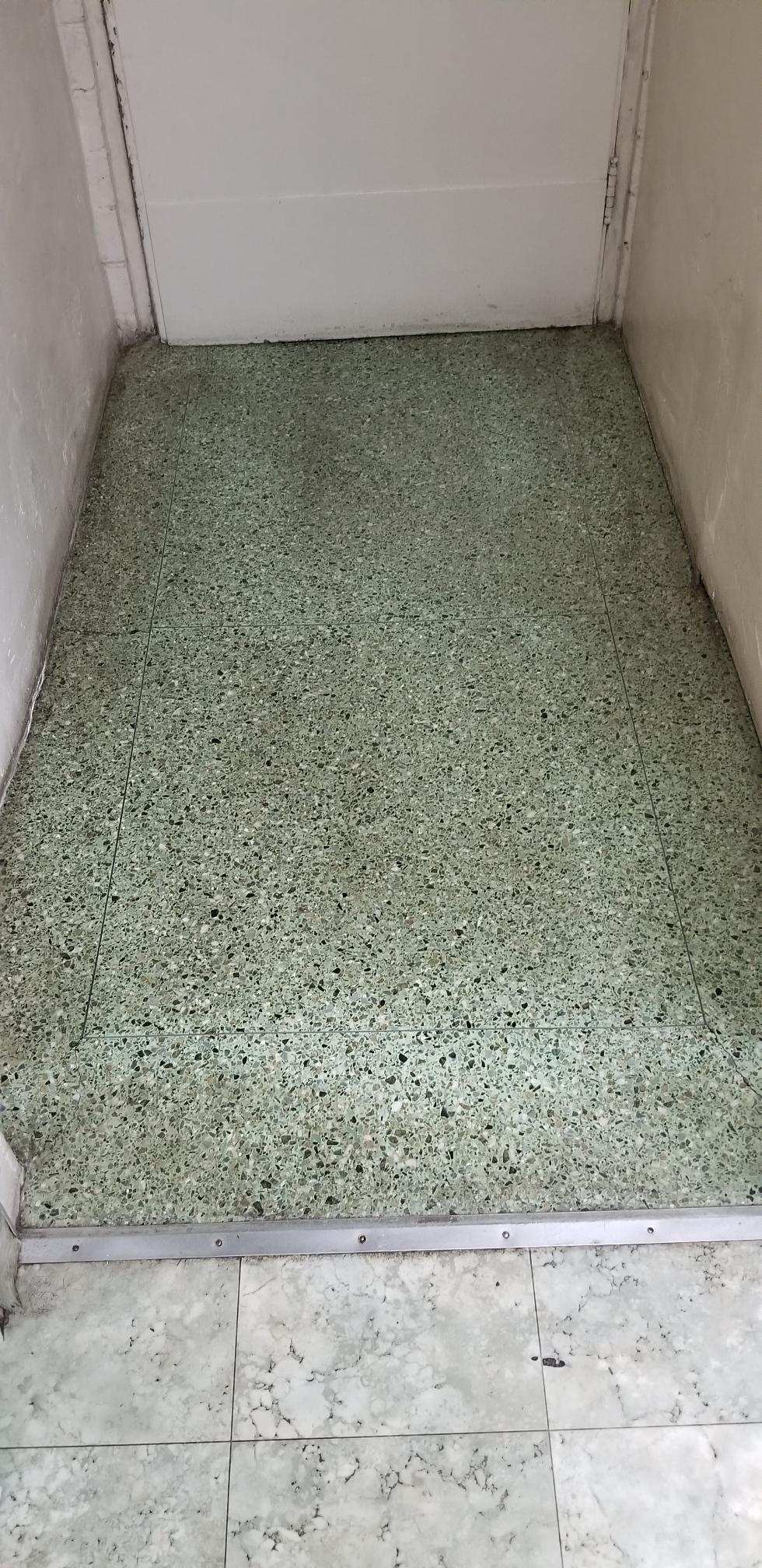

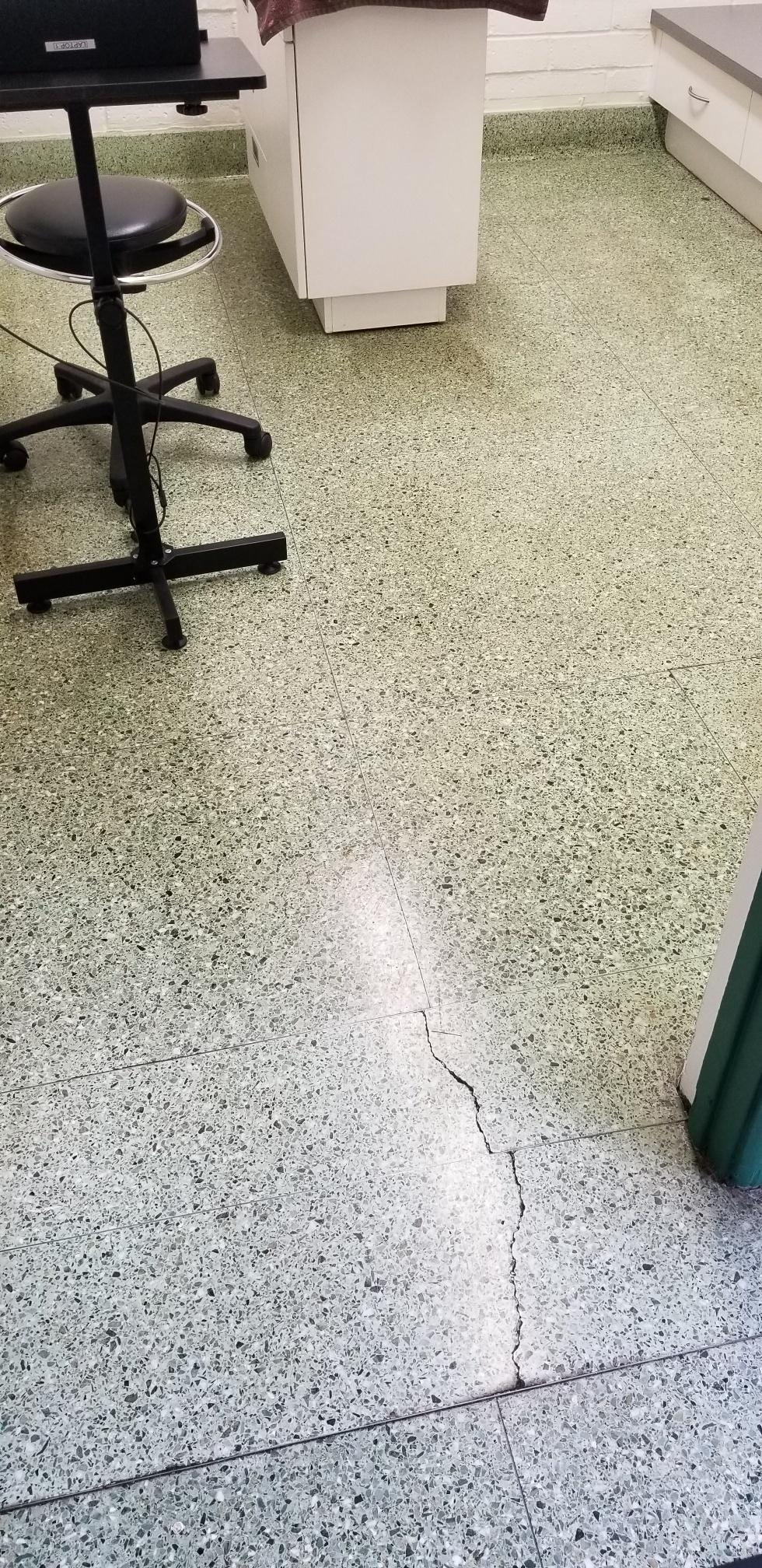

Vet office requesting this to be done on Xmas Eve...
Strip and leave unfinished..
How do they construct those baseboards?
Heat welds

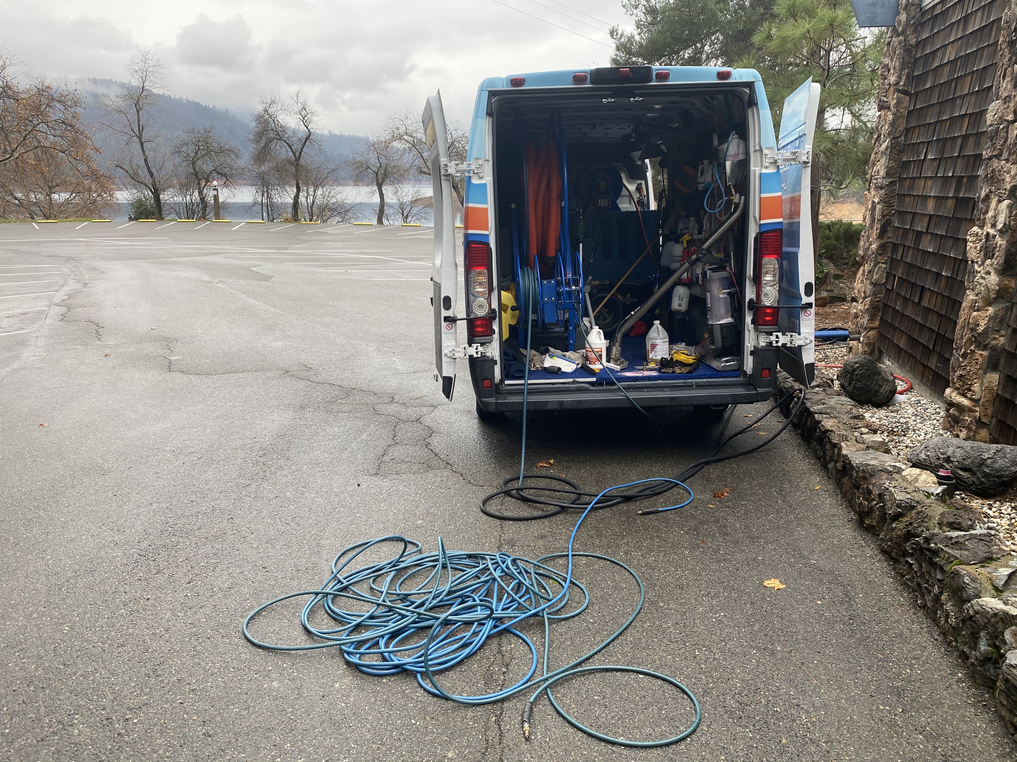

I think this has been covered, but with all the outpouring of support (and some good natured slaps on the back of your head), I just want to make sure you keep these points in mind:
1. Always test for floor finish. This lesson probably will reinforce that, but its something that just takes a couple of minutes, and it could have prevented all of this mess, stress, and wasted time.
2. Never extract emulsified floor finish into your truck mount. I know that many get away with it, but this is from a guy who has a service department that fixes truck mounts: Floor finish has caused thousands of dollars in repair costs for guys who have used their machine for that purpose. You'd be better off buying a wet dry vac and throwing it away when you were done with the job than to let your machine be damaged.
OK. Now go back to "flushing the carpet toilet" on rental properties and get this one behind you as soon as you can.
