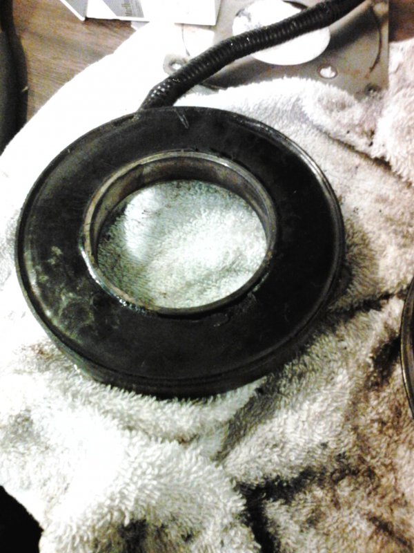

Compression is good up over 200!! I'm going to run it and see what the motor has.. He said he put a new clutch on it, I'm not an expert in clutches, but it looks fried to me..?
dealtimeman
Everyday is Saturday.
Sep 20, 2008
Michael
That is not the part that usually fails, the part of the clutch assembly that usually fails is the flex plate/contact plate as is doesn't have the original integrity to flex back out after the charge has been released from the magnet.
Reactions: Able 1
