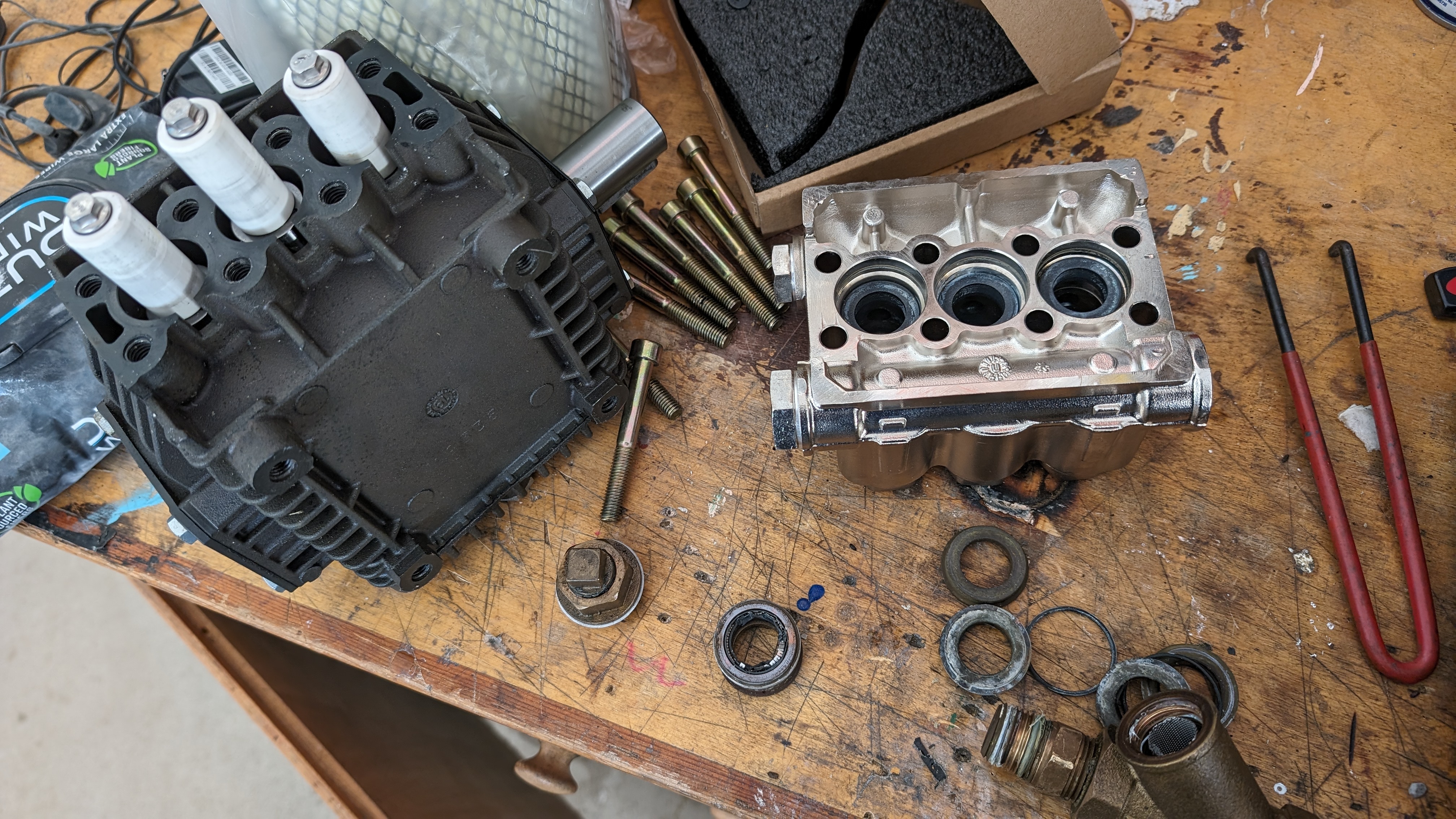

I did the fittings this winter, then the water pump started leaking so I replaced that. Then the radiator started leaking. I put some sealer in it to get by until I got the new radiator. Yesterday, the water pump was leaking again so I ordered another water pump and will get it done this weekend. The inside of the machine is a disaster at the moment

Well, I got my new pump today for the 870. That thing is BIG. I'm paying a guy to install it, I just don't have the time to do it, and I don't want too.
14,642
I'm dreading the day my pump will need some major surgery or replaced too. It's not located in a friendly spot on my Everest
