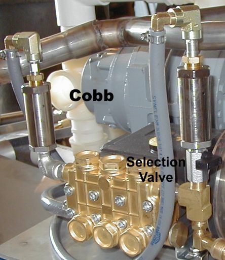

Mikey;
We consider the Paraplate Regulator as the best in the industry.
For tile & grout we use a high pressure & a low pressure regulator with a ball valve to switch between.
Stainless out of the pump.

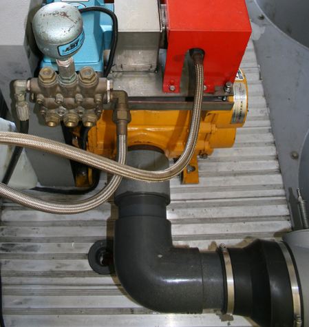

Greenie;
Several top quality TM's use thermoplastic in the vac intake system.
Here's a Vortex picture courtesy of Wizard that shows the plumbing quite clearly:
There is no high heat in that grey plastic plumbing.
Larry Cobb

PVC pipe / tube / fittings, are considered suitable for "low temperature" range applications. In plumbing, it's recommended for cold water installation only.
CPVC, carbon fiber, nylon, etc., are considered suitable for higher temperatures than basic PVC.
PVC is white in color. The others are generally black or gray, although I have seen nylon fittings that were a neutral (not "white") color...

All of the thermoplastics and thermosets are available in a variety of colors.
Some of them have temperature ratings of 400° or more. They are replacing metals with less corrosion on several automotive engines.
