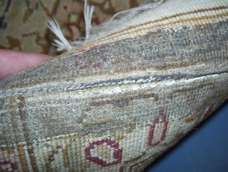

WISE
627
How about the one we talked about a week or so ago???
Want to walk through that one?
Here it is...
You mentioned a hidden stitch repair?
Thanks

Hi Michael,
I would be happy to help you, I think this is the rug we talked about before. I can't do it here but if you want to call me we can try to work out something. I will certainly help you repair it.
Here is a clip that just shows the before and after, the repair of this rug and two others like it are just too long for here. I had three rugs with some pretty good damage and had to sew all three with hidden stitches, consumer was thrilled. One had a damage portion similar to what yours looks like.
I will be out most of the week but give me a call.
