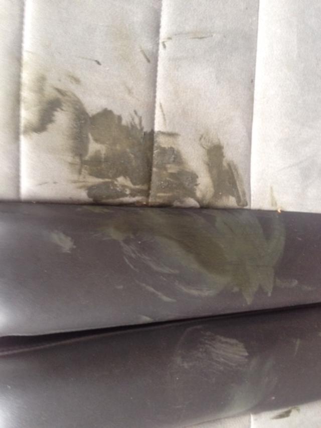

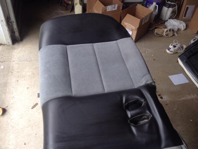

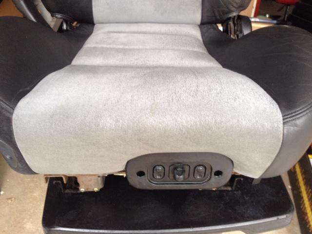

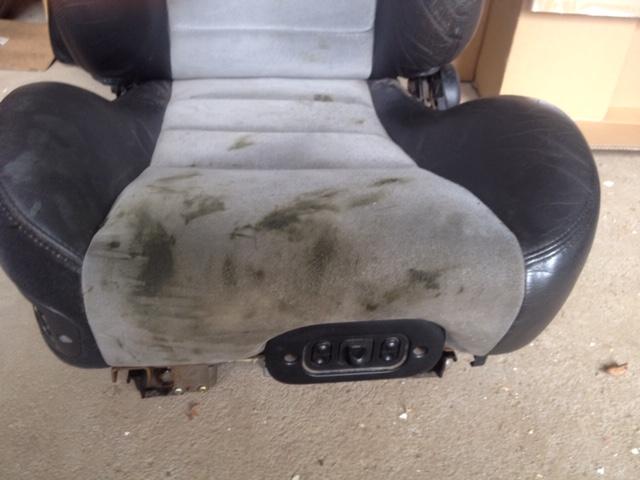

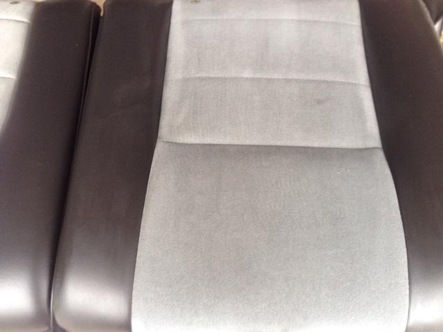

Alcantara Mustang seats out of a wreck.
Tow truck driver decided to throw all the parts including the greasy axles inside the car.
Aggressive prespray, acid rinse.
