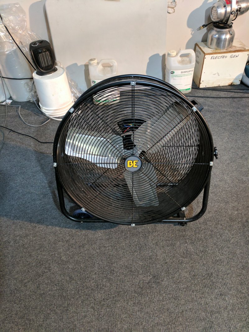

I am starting to use axial type fans instead of snail fans. I purchased a large 20 inch axial fan from a local pressure washing supplier to try it. $150. It works so well, I am going to buy several more. It is less pressure but over a much broader area. I usually get overnight drying with just one drieaz evolution dehu.
28,283
Here is a pic. It's actually 24 inches.

Studebakers will work and you can use them for drying on a flat surface as well but pricey. I can buy 3 of these fans for the price of one Studebaker. Nice thing with these fans is that one fan dries 2 poles. Doesn't blow the rugs off the pole either
