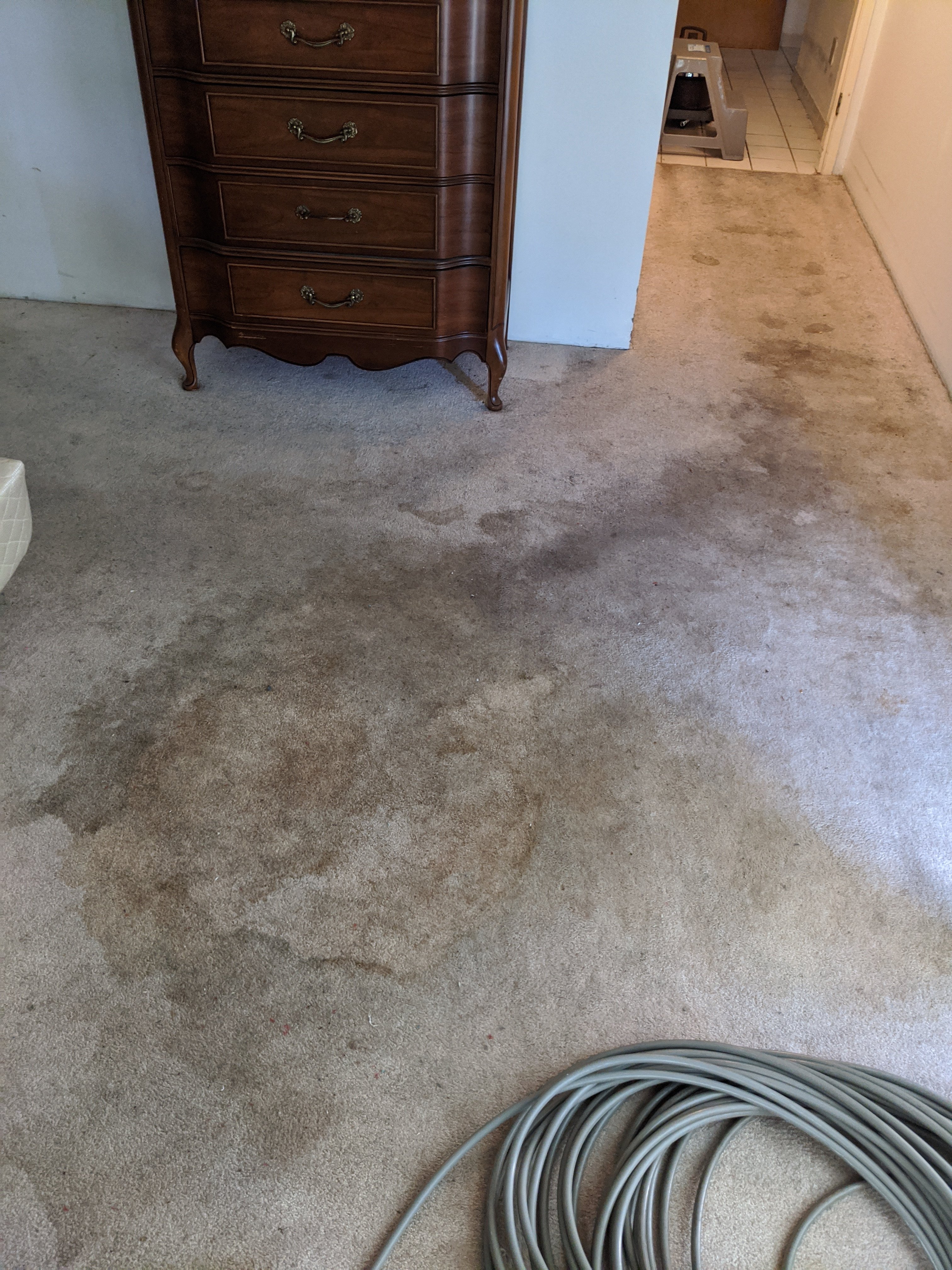

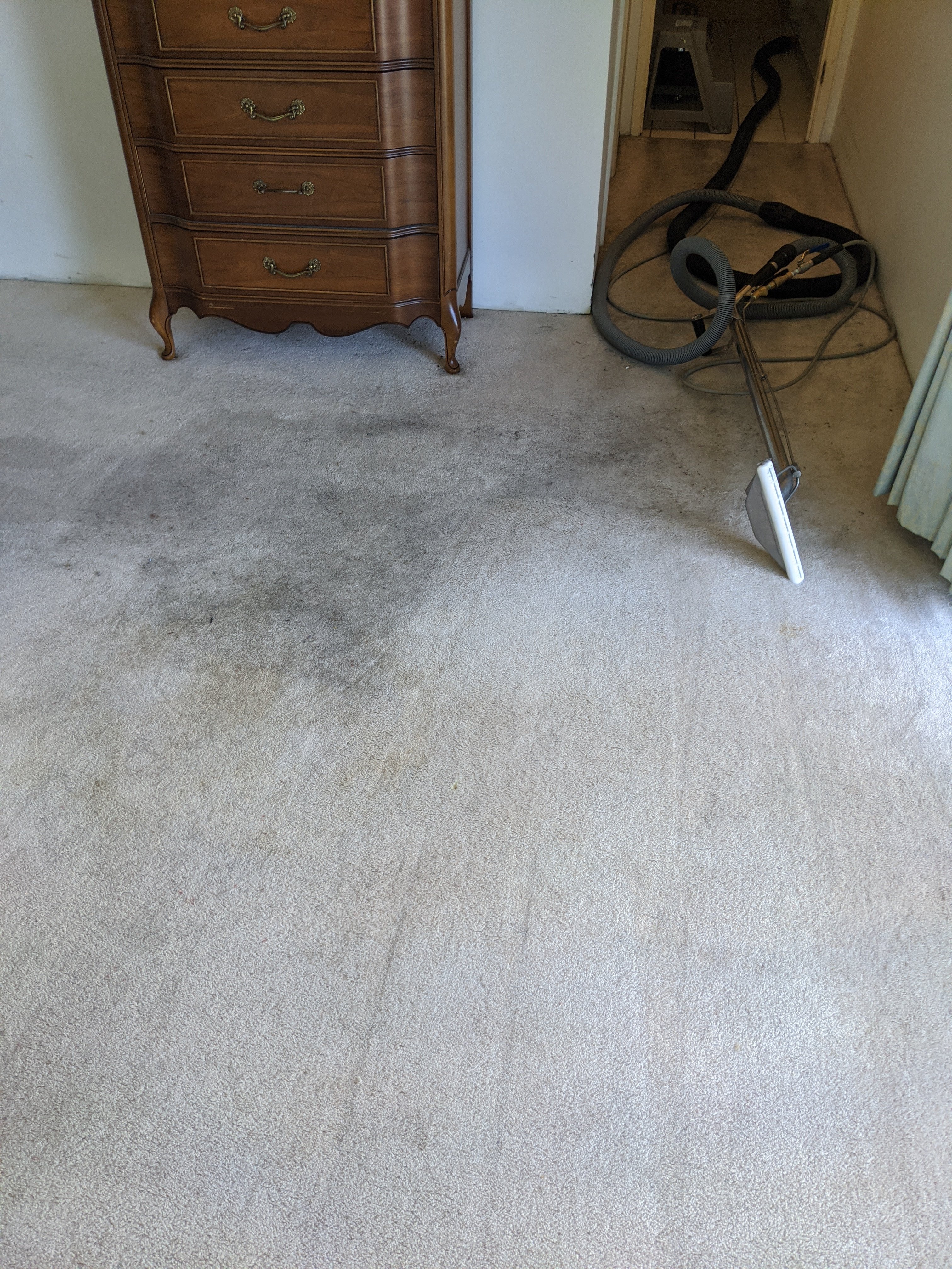

Here is one today I would never think vlm. Hell I didn't even want to put my vacuum on it but had to because of all the debris. Urine saturated, will have to wash my vacuum before I ever use it again. Elderly people with negligent care aide as far as I can see. I improved it but I would never call it clean.
View attachment 101914 View attachment 101915
VLM guys clean stuff like that all day long. Enzyme prespray like Spartan consume & a quality encapSHAMPOO (for Jimmy)with Oxy. Scots makes a good one, Core, Excellent Supply's Hydrox, Steamway.

sorry to be the butthead but im closely looking at the pictures and know that I could get the carpet cleaner with my TM. yes, it looks much better.
And if it takes just as long to clean, whats the point?
And drying time, I cleaned my Family room yesterday (yep Sunday) put a fan on it and it was dry in an hour. so again, whats the point?
