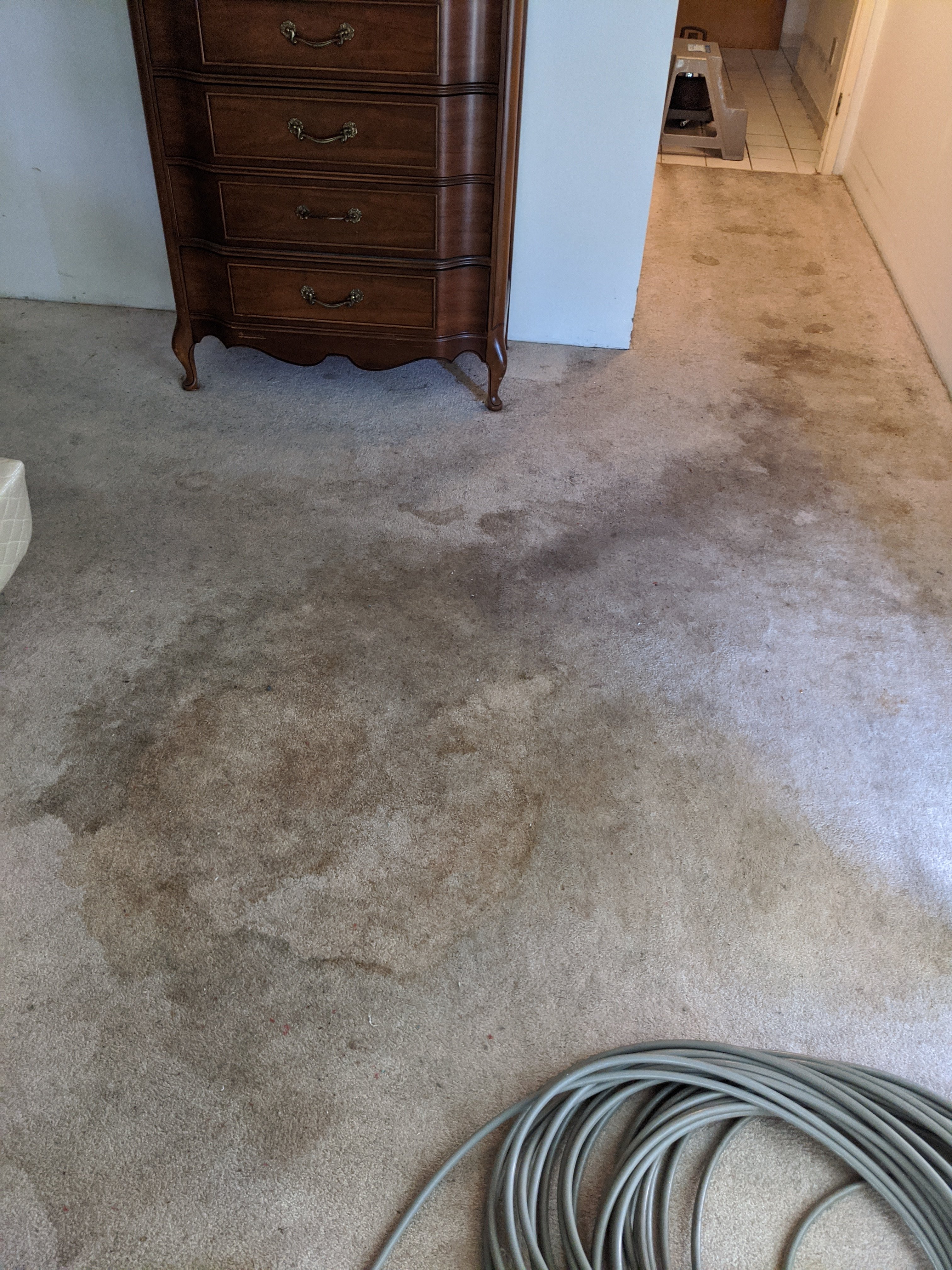

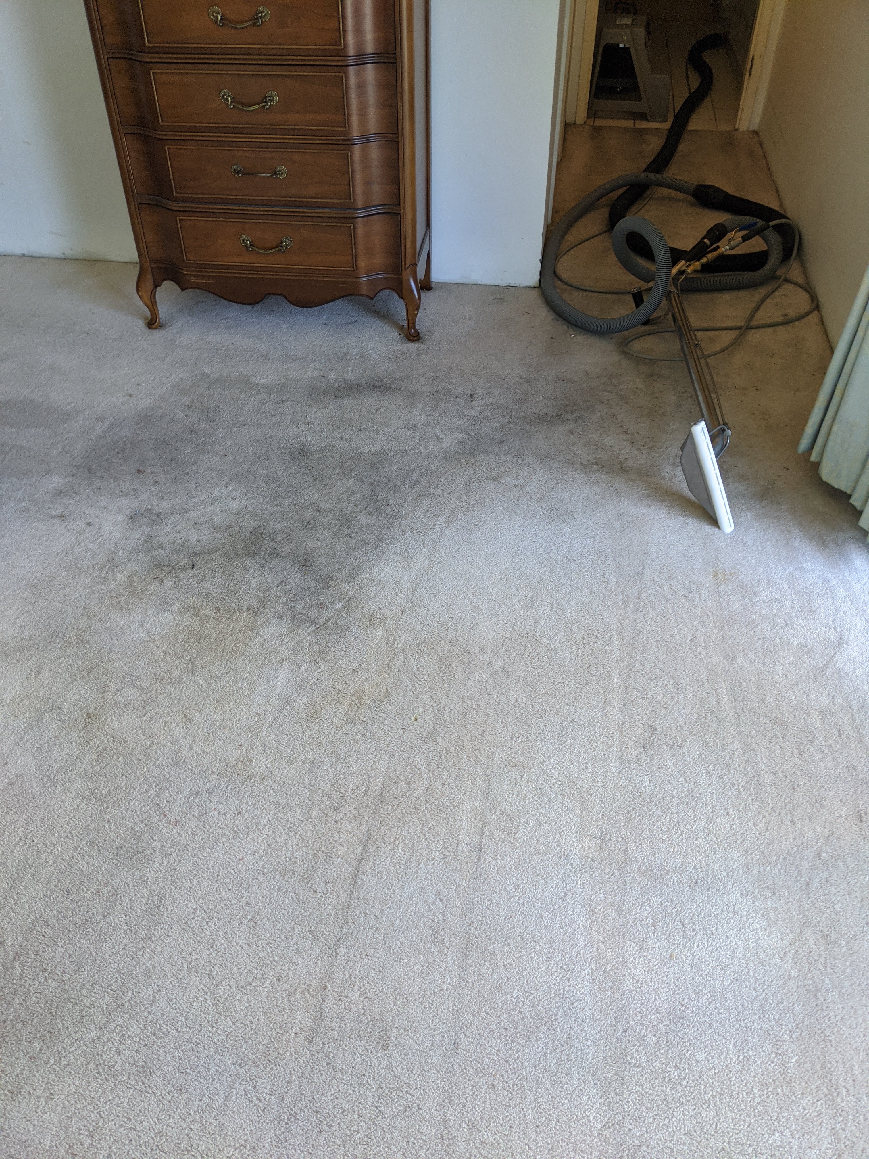

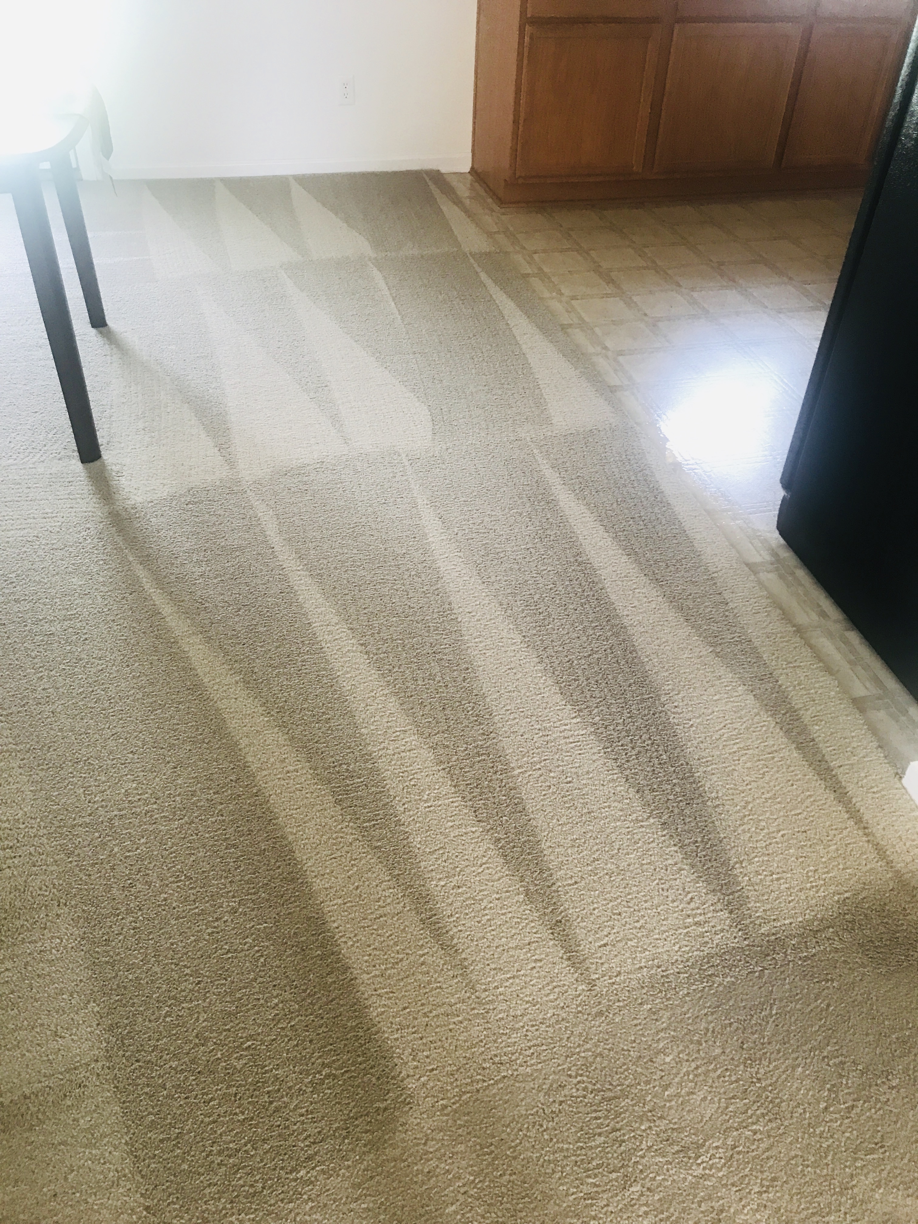

Here is one today I would never think vlm. Hell I didn't even want to put my vacuum on it but had to because of all the debris. Urine saturated, will have to wash my vacuum before I ever use it again. Elderly people with negligent care aide as far as I can see. I improved it but I would never call it clean.
