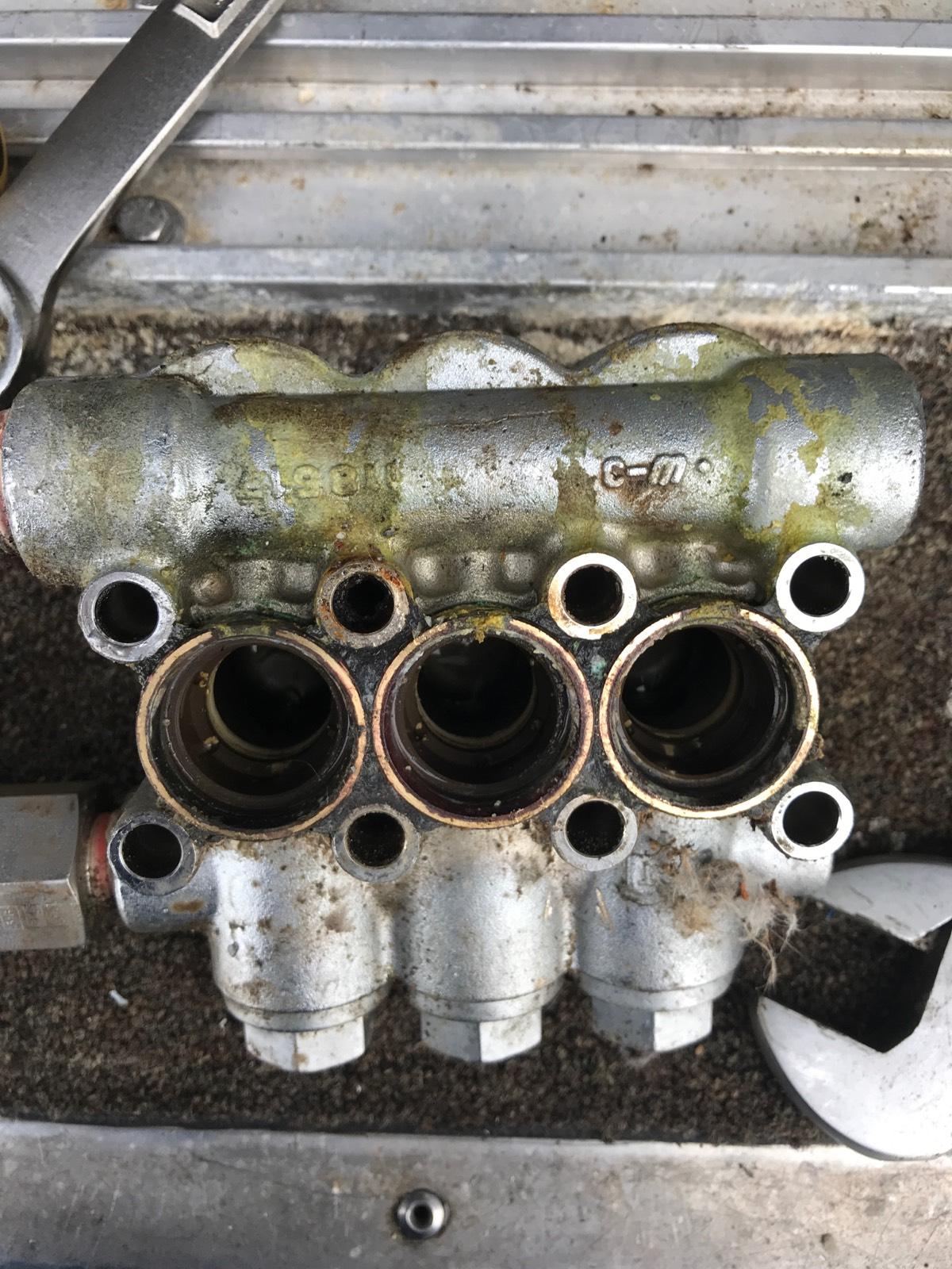

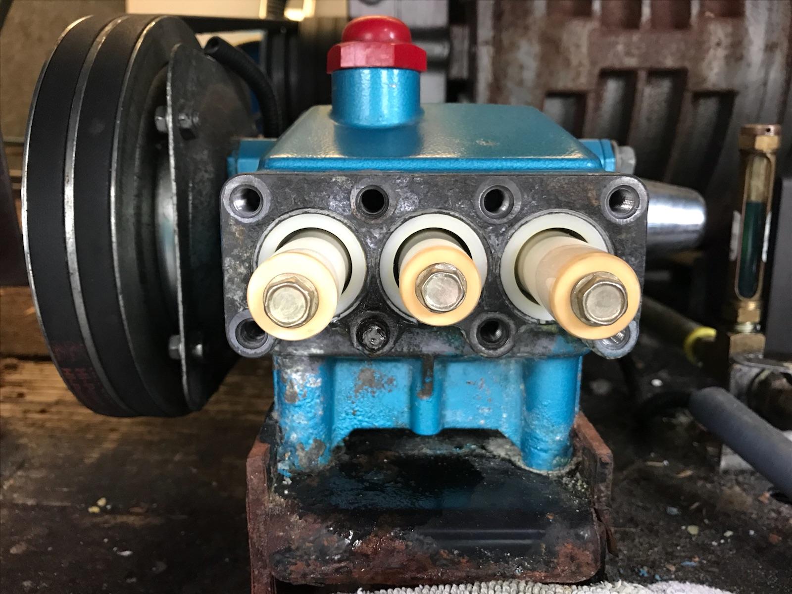

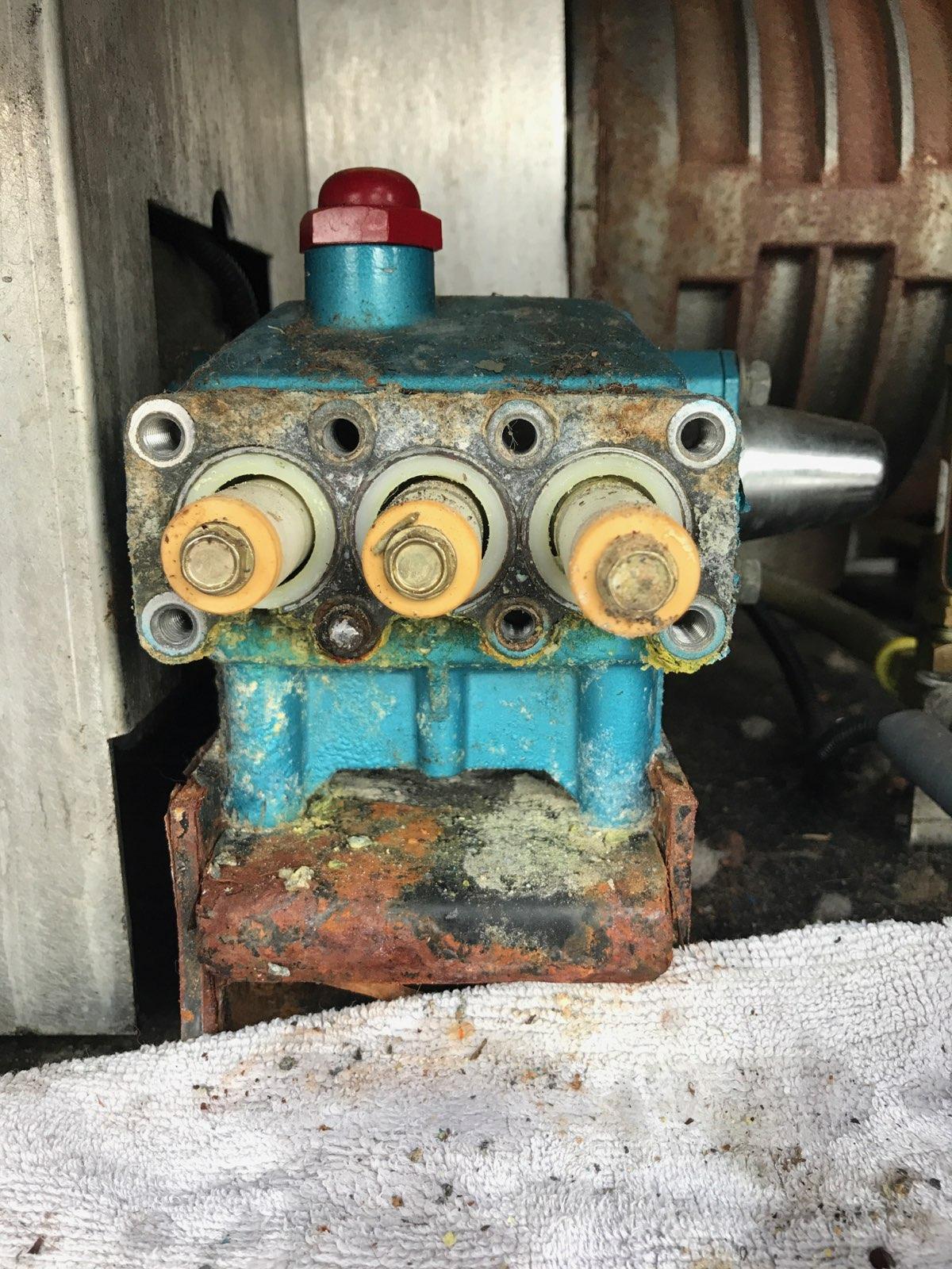

AT pump got it's first leak last week, water showed up in the oil.

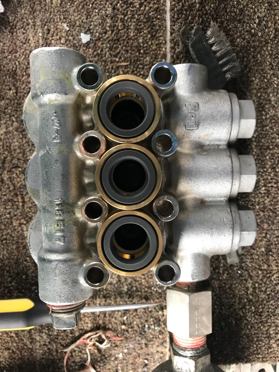

My mechanic tech cleaned it up and replace all seals.

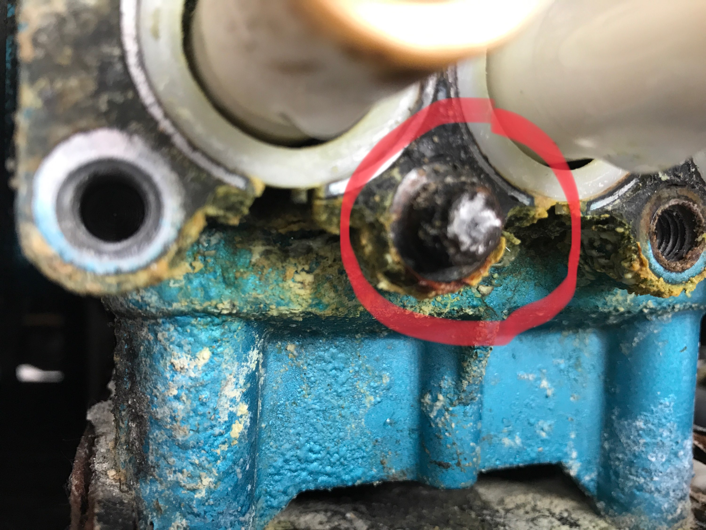

Bolt was already broken for some strange reason..
He did a nice job cleaning it up, eh?
